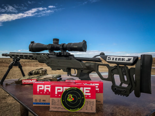

175gr Prime 308 – SD 8fps – AI AX308
130gr Prime 260 – SD 12fps – Tikka T3x
130gr Prime 6.5CM – SD 15fps – Spartan Precision SH Build

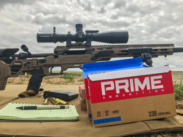

300gr Prime 338LM – SD 15fps – Cadex Defence CDX33
I encourage you to explore which round your rifle likes the best, as not every chamber will enjoy shooting a box of Prime, but my results have been impressive.
