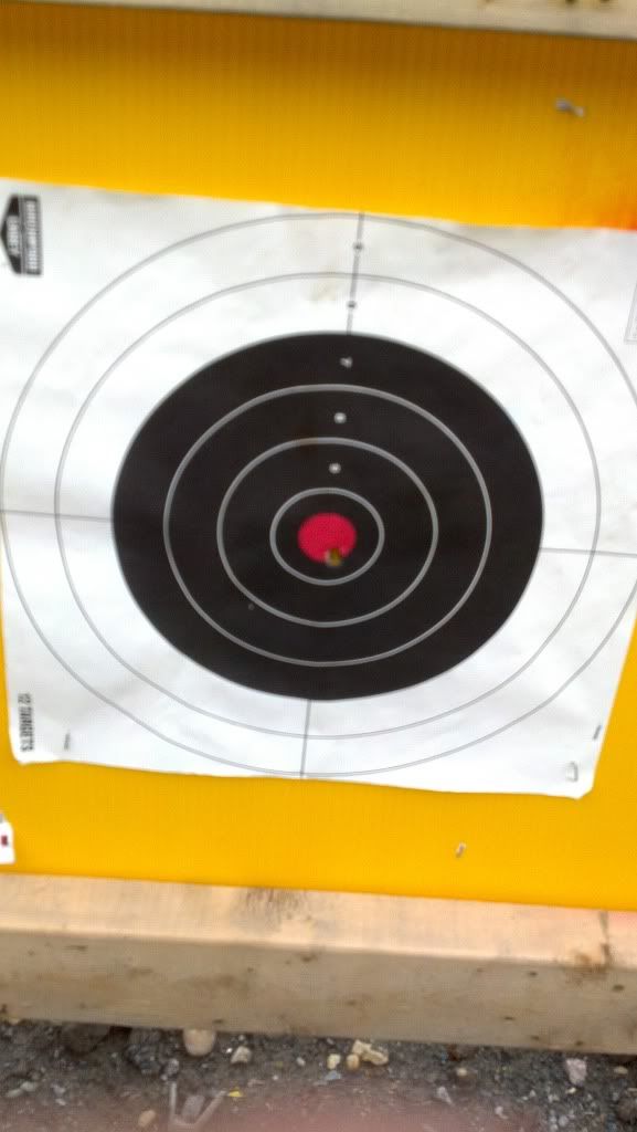

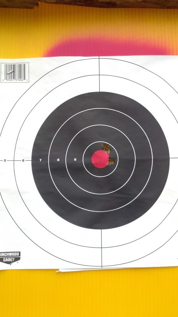

I had the afternoon off so I took the new SPS Tactical over to Hap Baker range to break it in. I don't normally subscribe the the elaborate barrel break in procedure, but on factory tubes I have found that it can help smooth them out and keep them from fouling so quick. I do my own process that consists of; One shot clean, two shots clean, three shots clean, five shots clean and then done.
1 shot:25yrds.
2shots:50 yrds.
3shots:100 yrds.
5shots:100yrds.
It seems she is waking up nicely, and the generic hand loads of 45.0 grains of Varget under a 155 SMK seemed to do very well. The Xmark trigger sucks, so that will be the first thing to go. Here she is in the new HS stock.

<div class="ubbcode-block"><div class="ubbcode-header">Originally Posted By: lessthanfour</div><div class="ubbcode-body">i didnt read and assumed the 1st target was a 5 shot 100 yard group </div></div>
If I could achieve that while breaking in and with a generic hand load with junk brass, then I'd quit 3-gun and take up F class. This is the first precision rifle shooting I've done in more than a few months.
