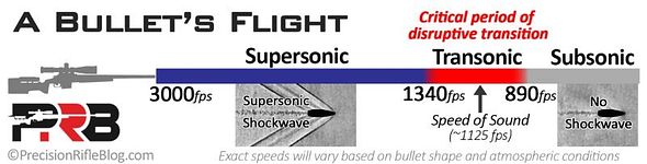

Familiarize yourself with the problem of transonic turbulence. You'll see that it may become a problem for some bullets as they slow down from supersonic speeds and enter the transonic range of speeds. As has been noted above, the vast majority of .22LR ammo never exceed the transonic range. It can't slow down into a speed range it never exceeds.
This isn't the place for a more full discussion of the problem. Nevertheless, it can be noted that it was confirmed in 1990 by Robert McCoy that .22LR ammo with transonic zone velocities (from about 1340 fps to 890 fps) doesn't suffer from the increased pitching and yawing that causes the flight instability associated with bullets slowing down into the transonic zone from considerably greater velocities. See conclusion #5, p.11 in Robert McCoy "AERODYANMIC CHARACTERISTICS OF CALIBER .22 LONG RIFLE MATCH AMMUNITION" https://apps.dtic.mil/dtic/tr/fulltext/u2/a229713.pdf
The image below may serve as a brief visual introduction to the issue.
