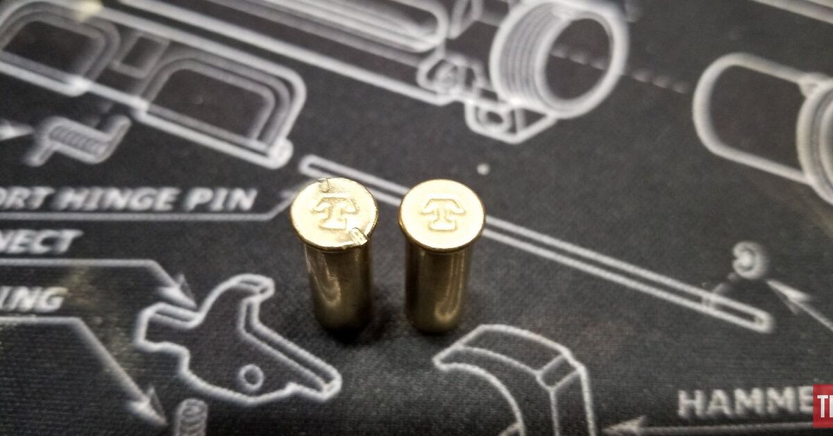

Wulll, I just got these and they look pretty good.
I cycled these 3 times through the mag and no problems. I’ll be using these until something better comes along. I don’t want any more down time waiting for on new firing pin.

Hey Chuck - Those Pachmeyer caps look pretty soft, that would be good for lots of 'shots'. I've found the Yellow anchors don't always feed thru mags or catch on the extractor, so I've been using the 'red translucent' Tipton caps and they are pretty brittle. After ten or so shots the rim is gone and the body gets stuck in the chamber - have to push it out with a rod. Once I thought it ejected but didn't and I ran a live bullet up into it. Luckily it didn't fire out of battery, the bullet stuck out too much for the bolt to pass the disconnector I guess. I have a Marlin 60 with LSHO but my other 22s don't and I load all of them with a snap cap as Last Round to avoid the dry-fire damage. I've killed a couple firing pins with D-Fs. I've found that the Tiptons don't always feed out of a Savage rotary mag, tho. It's a PITA to have to always count shots, tho I'm anal enough to usually count them.
Reactions: Just Chuck
@fasteddie - Yeah, I’m really in the very preliminary stage looking at these. Maybe the real deal, maybe not. After more DF’s I’ll have a better take on them. For now I’ll use them just ‘cause I don’t want to be down for a broken firing pin.
I tried some of the yellow drywall anchors, Hillman 370326 I never ended up using them. while close to a .22 shell at least in the couple guns I checked them in the plastic rim sat below the chamber face, meaning that you still run the risk of peening a chamber should the gun be capable of doing that.
