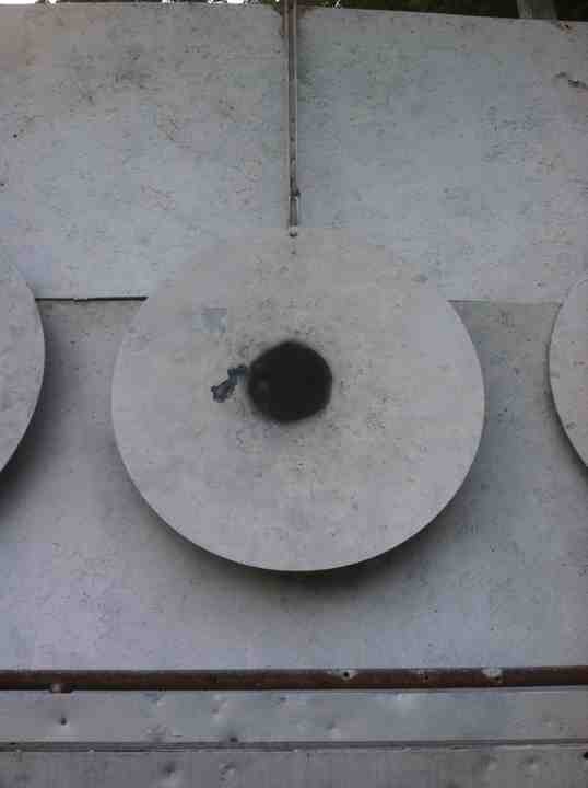

I shoot a 4 groove kreiger in 6mm 243AI... Easy .5moa at 1000 yds in good conditions...
5@ 1000

Might add regarding 260, twist, etc.
Latest sporters had 700 Mag Contour, 23" 8 twist, 4 groove, shot a SUB 1/2" group at 200 yds, using the 130 Berger, shot in the 1s at 100 yds.
So I wanted to pass that on.
