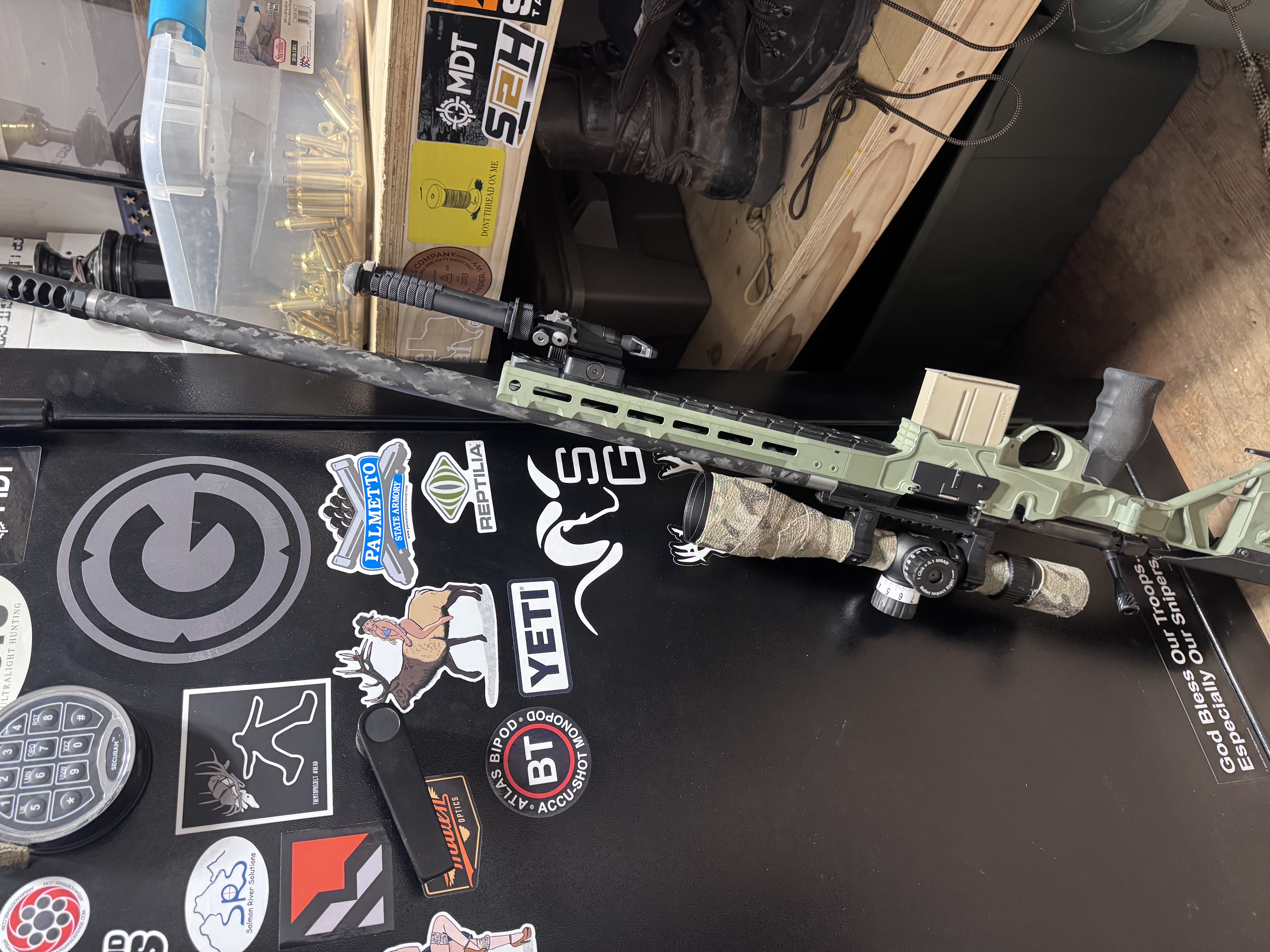

If your looking to go headfirst in PRS get the MPA.
If you’re looking to do all get a Seekins. The new M3 doesn’t have the limitations on barrel tenon dia like the previous generation like I have.
I have 3 barrels for my HIT, a 223, 6.5 creed steel and 6.5 creed carbon. Shoot PRS with the steel, shoot NRL hunter with the carbon, practice with the 223. The new action does seem a tad smother, I messed with one in scheels the other day. With some dry fire and lube I’m sure it’ll be nice.
The quick change is awesome.
I had wobble develop in my folder when locked out, they replaced the chassis.
If you get a PRS membership Eurooptic does good discounts on barrels and rifles for seekins.
Again if you were wanting to compete in PRS strictly there are better rifles. I’ve had mine over a year now and burned a 6.5 steel barrel out last year shooting matches learned so much with this rifle. But towards end of this year I’ll build a dedicated PRS rig and save the seekins for find and range matches.
