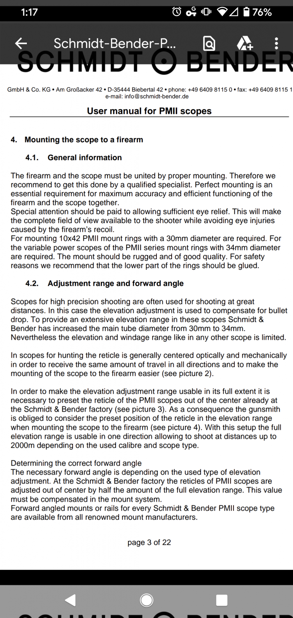

Just bought a S&B PMII 5-20x50 DT ultra short and I am now looking at the spuhr SP-4036 my question is should I go with the 20 moa version instead? It will be mounted on a 22 inch 6.5 creedmoor using factory loads, shooting distances 100-600 yards at ranges and for hunting. If I go with the 0 moa base will the scope have enough adjustment to get out to 1000 which I may shoot on occasion or should I just go with the 20?
Read section 4.2 in the general PMII manual.
Just use the 20MOA mount, nothing really gained with going 0moa, while 20moa gives you a larger usable range.
Most scopes have enough elevation to get a 6.5 creed out to 1000 yards. It seems you dont have the mount already so it makes sense to just buy the 20 moa and be done with it. If you had the 0moa version already I would have said to roll with that.
