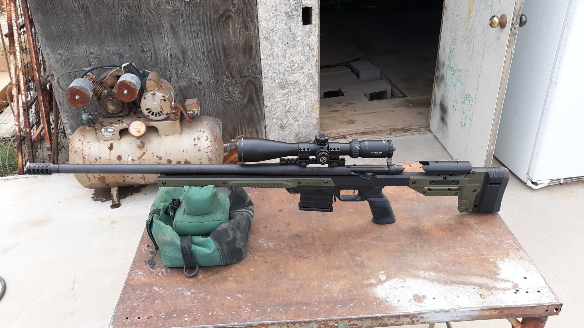

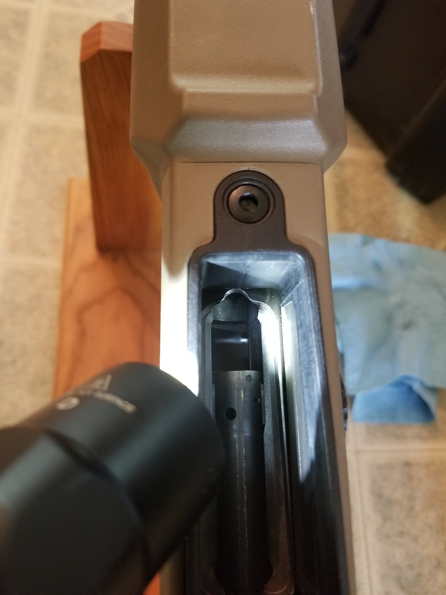

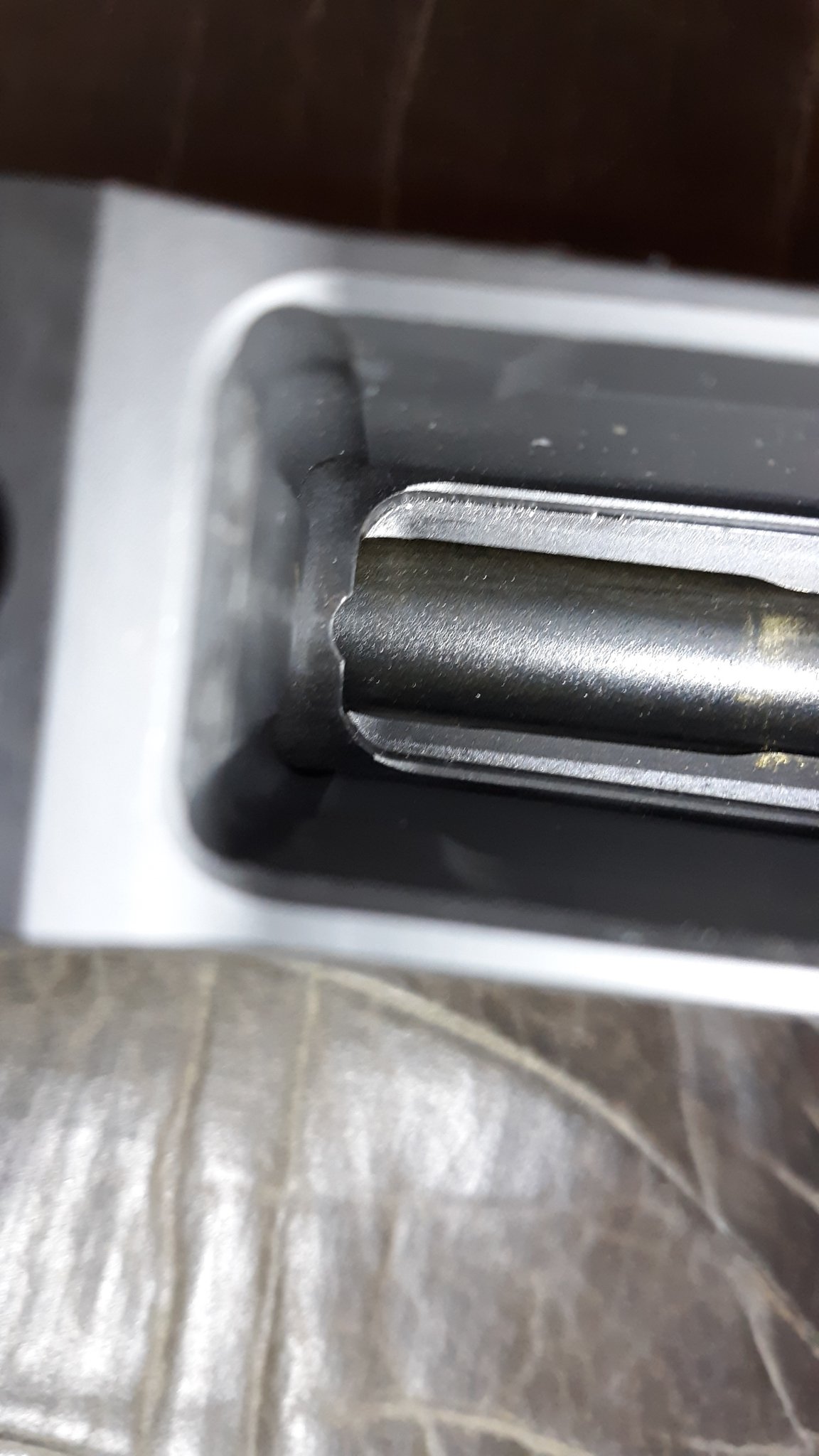

First off, everthing was packed good. I got the stock out and checked it over. Fit and finish looked good. The instructions to mount the stock are very easy. It bolted up to my remington 700 solid. I bought the spacer kit for the LOP. I used all of the spacers. The bolts included where not long enough in my opinion. They need to be 1/2" longer. Also I got one of MDT's poly mags. There is an issue with the feed ramp of my rifle and the tip of the bullet. The tip sticks out under the feed ramp. I'm not sure if I want to grind on my feed ramp or try metal mags. The Oryx feels and looks good. I'll report more Saturday, weather permitting.
First, thanks for the update! Second, WE WANT PICTURES!!!!! (Think of us as small children being read stories, just not the same without the illustration). Third, the tip sticking under the feed ramp is an OAL/feed ramp issue. You might have better luck with a different mag, but likely you'll either need to change your load or mill/Dremel (friends don't let friends Dremel rifles, not the metal parts anyway) a recess into the feed ramp so the tips clear. For sure, try some of your buddies mags first before cutting on your gun.

I had a similar issue with a Magpul 700 stock when switching to aics magazines. Small burr bit to notch then polished all the edges. Works great.

Mdt poly mag 6.5cm remington 700. I'm thinking the thickness of the back wall of the mag is putting the nose of the bullet too far forward. That is why I'm thinking about a metal mag with the plate up front.

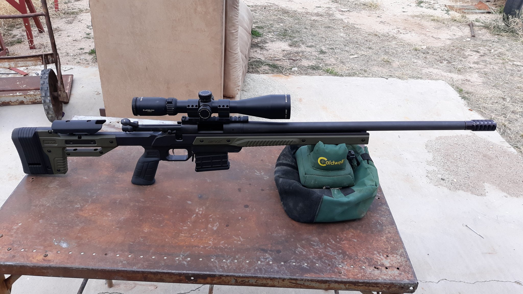

Range day. I set up at 100 yards to check zero. Windage was good, elevation was .3 mils high. I rezored and all is good. I ran a 50 round box of Hornady 140gn American Gunner through it with one FTF. The tip of the bullet nose dived into the mag. Over all I'm very happy and would recommend the Oryx to anybody. Even gun snobs.
