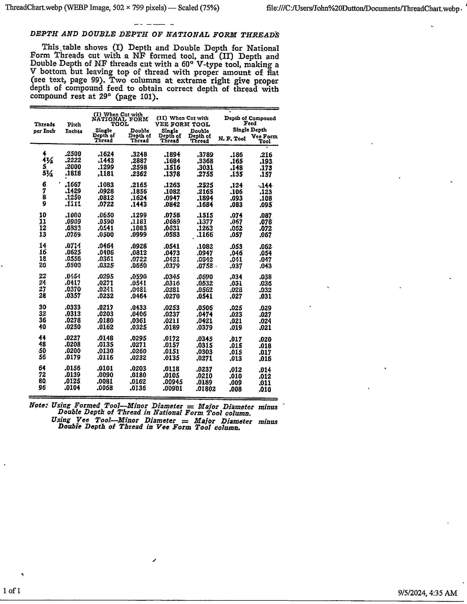

For those who don't know thread depth, or have a machinery hand book.

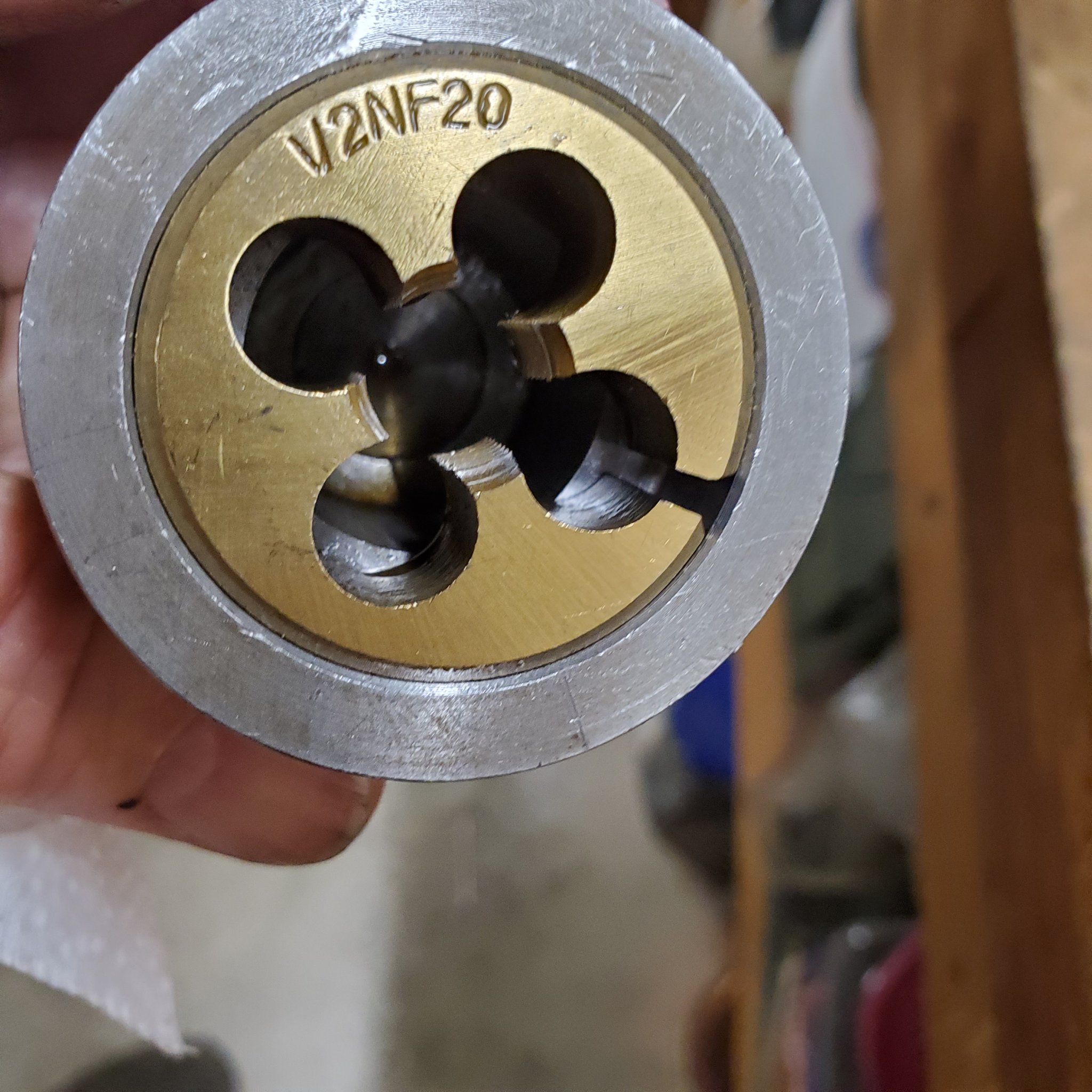

So let's correct the miss information.
1/2" X 20 is a standard USA die for 1/2" fine tread, I have one purchased at the local hardware store.
The 1/2" X 28 is special order, extra fine thread...not common ...only common in firearms muzzle break threads.

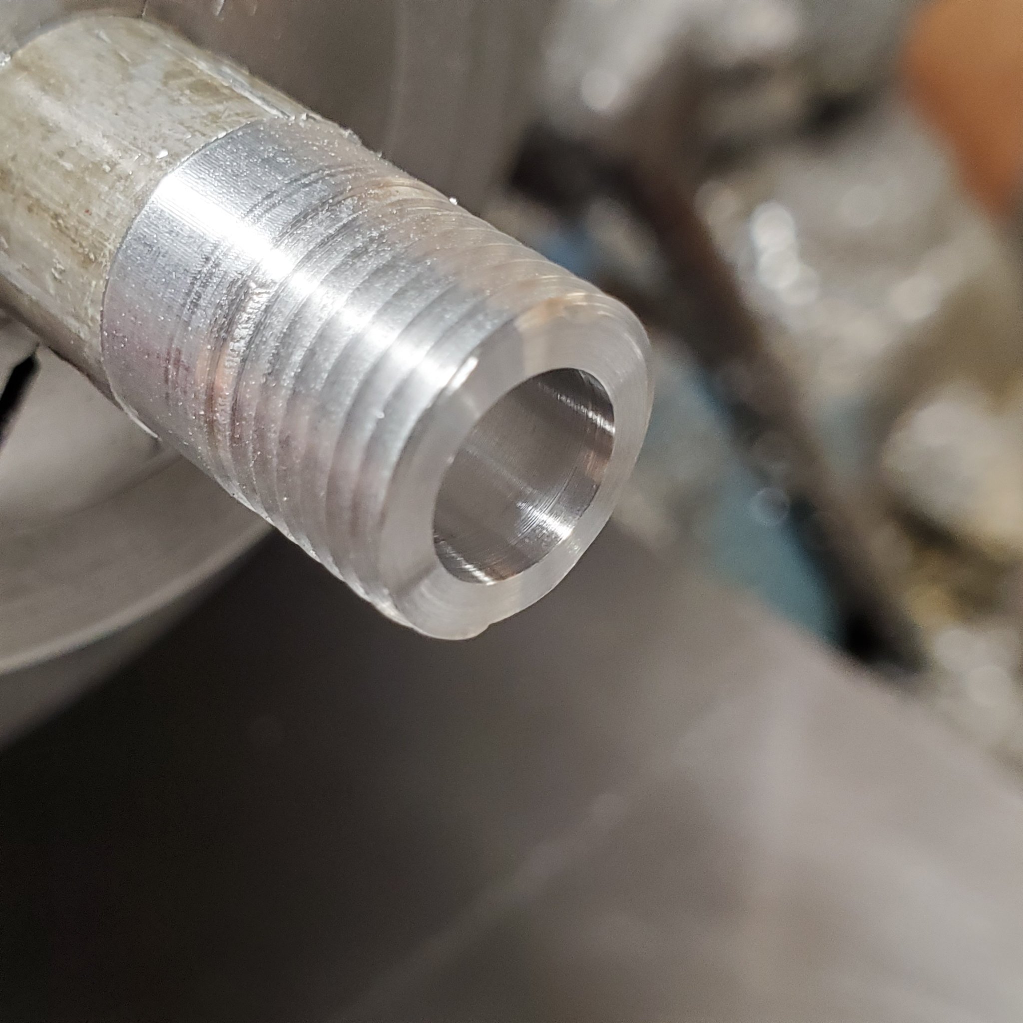

Next this is exactly what a 1/2" X 20 looks like on a .308" bore.
Not my choice but enough metal with low muzzle pressure not to be a problem at all.

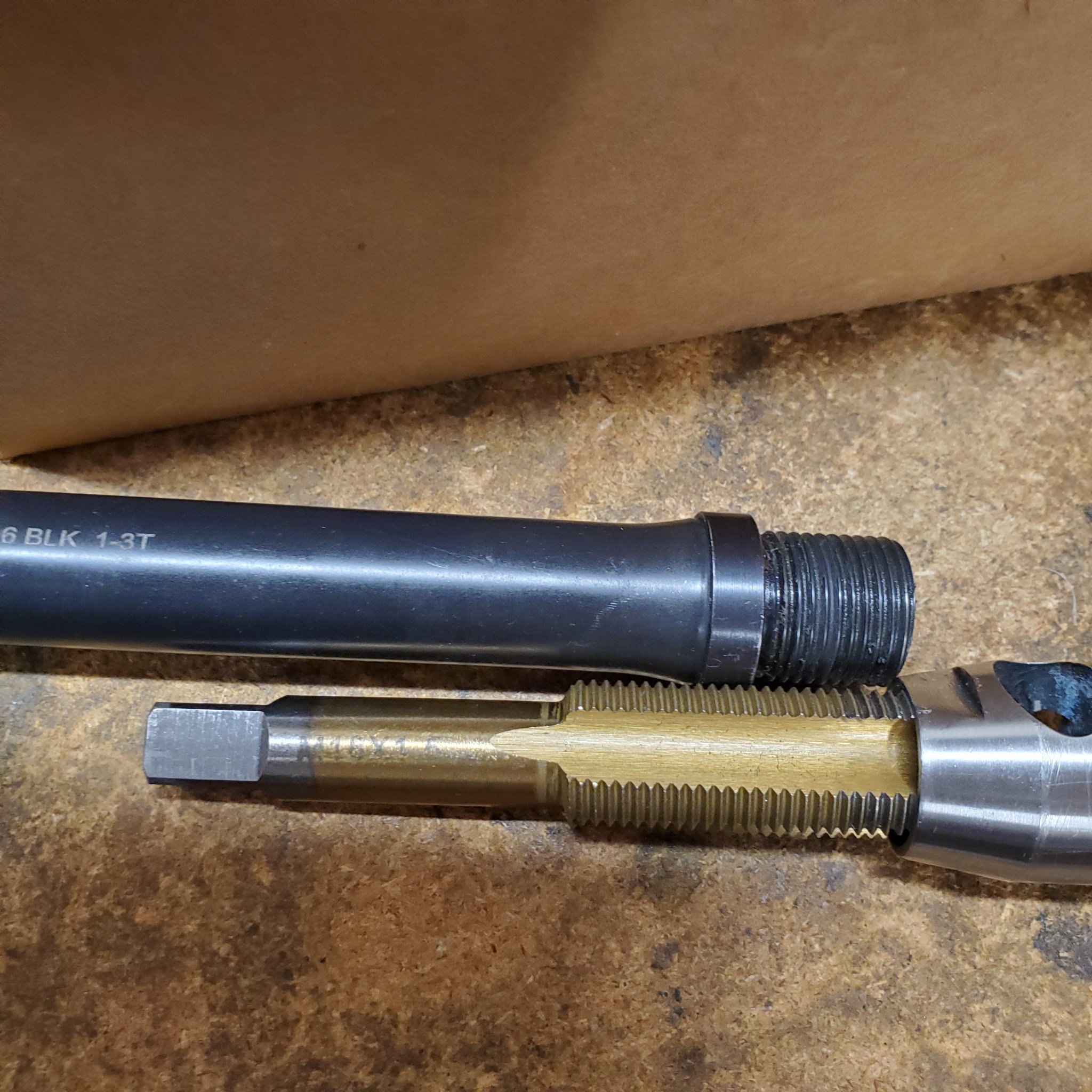

Next is a factory manufacturered barrel with a 1/2" X 28 thread on a 9mm compared to 1/2" X 20 .308" I just made for comparison. Whoa! Talk about a thin wall!..threads and all!

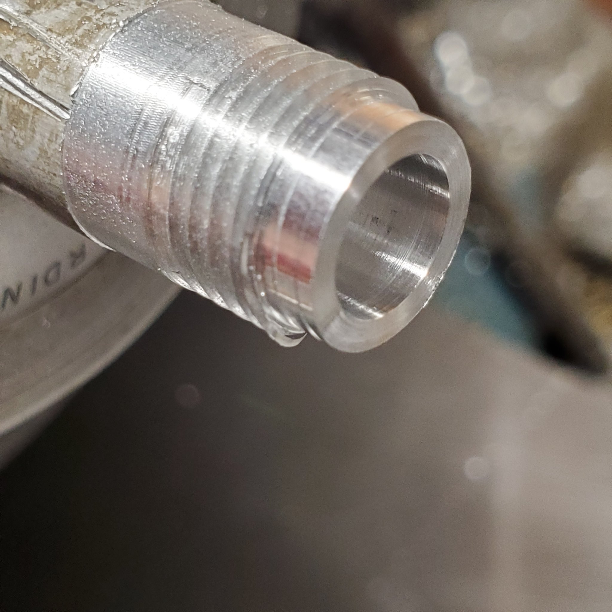

Next is with the 1/2 X 20 .308" barrel threads turned off ...there is still plenty of metal support, for .308" bore.

1/2-20 is very common in europe.
Both my CZ 457's (Canadian imports) have 1/2-20 threading but those are .22LR.
Metric is probably common in Europe, for most rifles designated for use in European countries. Imports can change that.
1/2"X 20....IS "the standard" for the USA fine thread by the SAE!.... Period...
1/2" X 28 is the odd ball!...not in common use like the 1/2"X 20 thread, found on most hardware stores in the USA.
You have to special order taps and dies that are extra fine...like the 1/2" X 28... from Brownells, tooling outlets like Graingers, or somewhere that sells gun parts...cause that is one of the few places 1/2"X28 is common...is in muzzle devices for firearms...it's not in common use anywhere compared to the SAE coarse and fine threads in use.
The metric similar would be 14 mm X 1.5 mm for their common fine thread designation.
But they could make a non standard extra fine of 14 X 1 mm if they want, for the commy/ European muzzle breaks...it's up to the manufacturer.
My 8.6 Blackout has 18 mm X1.5 mm "the standard" metric fine. You can find a tap at the local hardware store...bore out the 5/8" X 24 and retap with 18 X1.5 mm to fit any American muzzle brake with that thread, to the metric barrel thread, as long as the .338 bullet has clearence... or bore it out too.
Simple, but many whine about the thread size and being metric.
