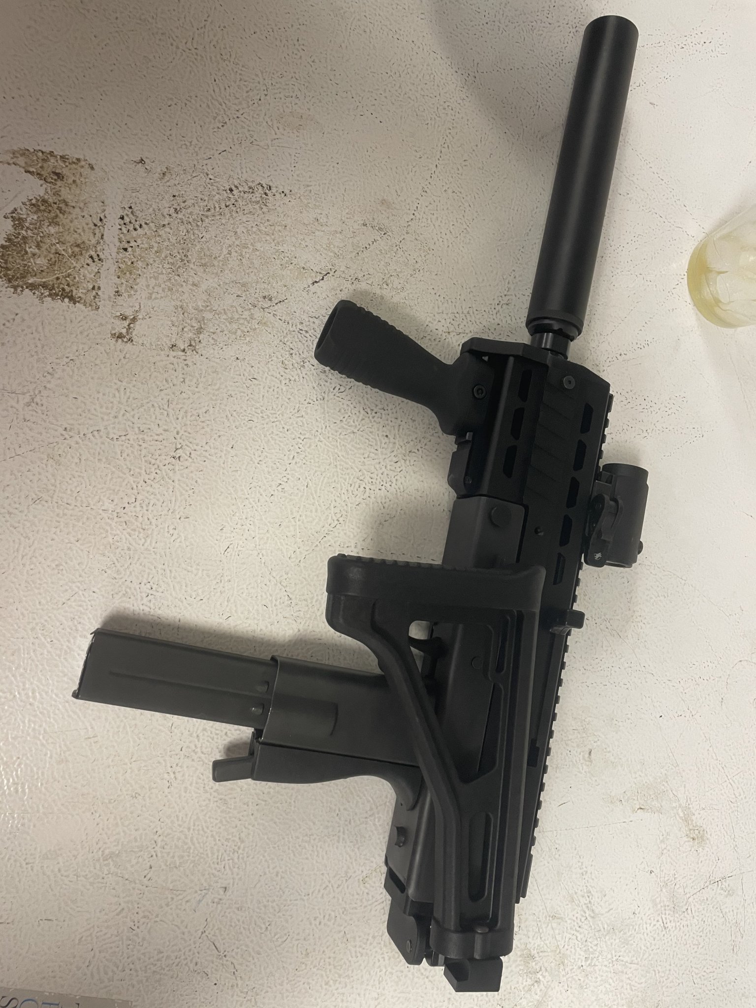

    Looking to put a Octane 45 on a Lage 9mm Mac upper threaded 1/2-28
    Would like to use a 3 lug
    Does anyone make the male 3 lug in 1/2-28 that would fit a 45ac03 lug can ?

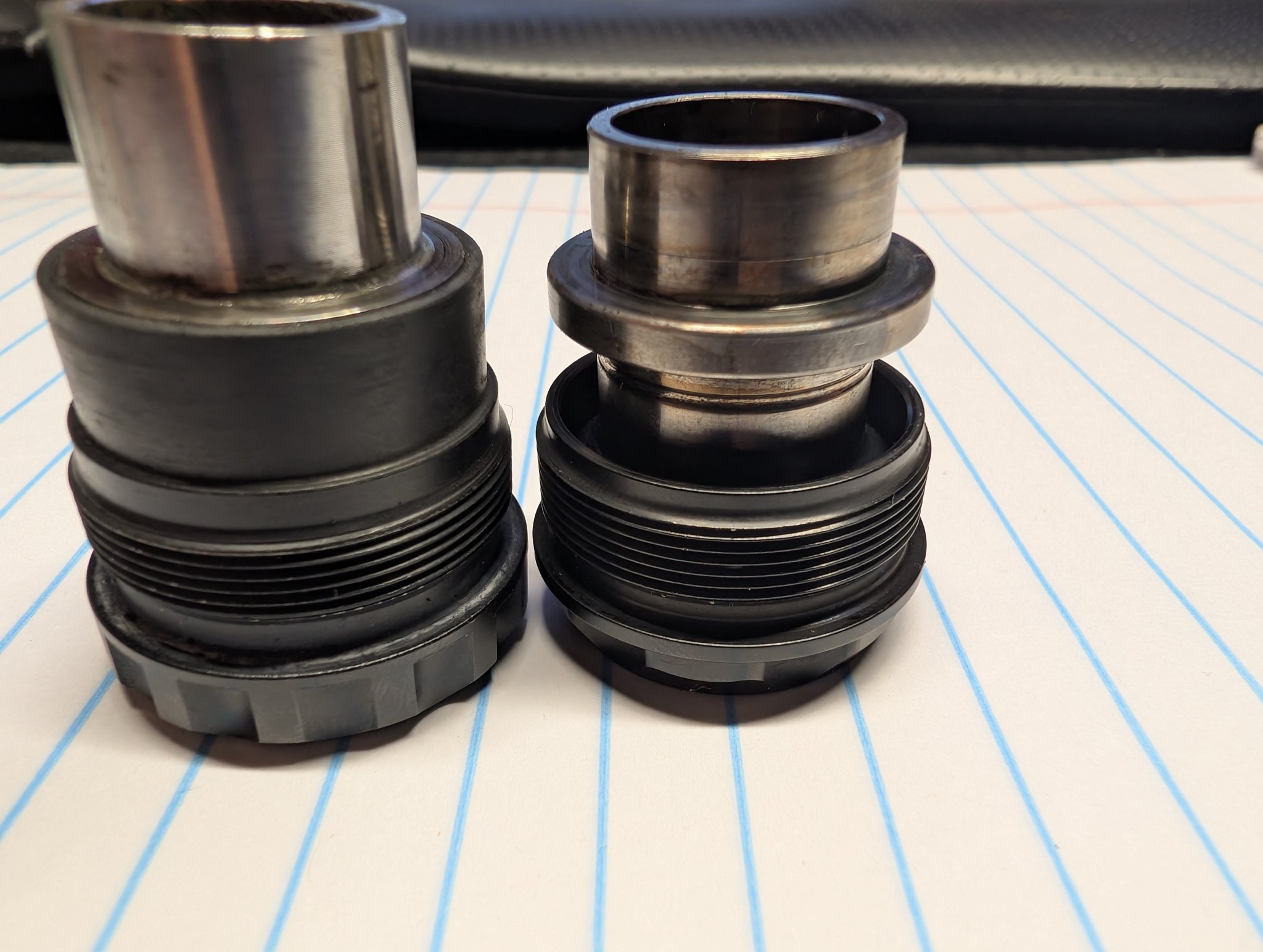

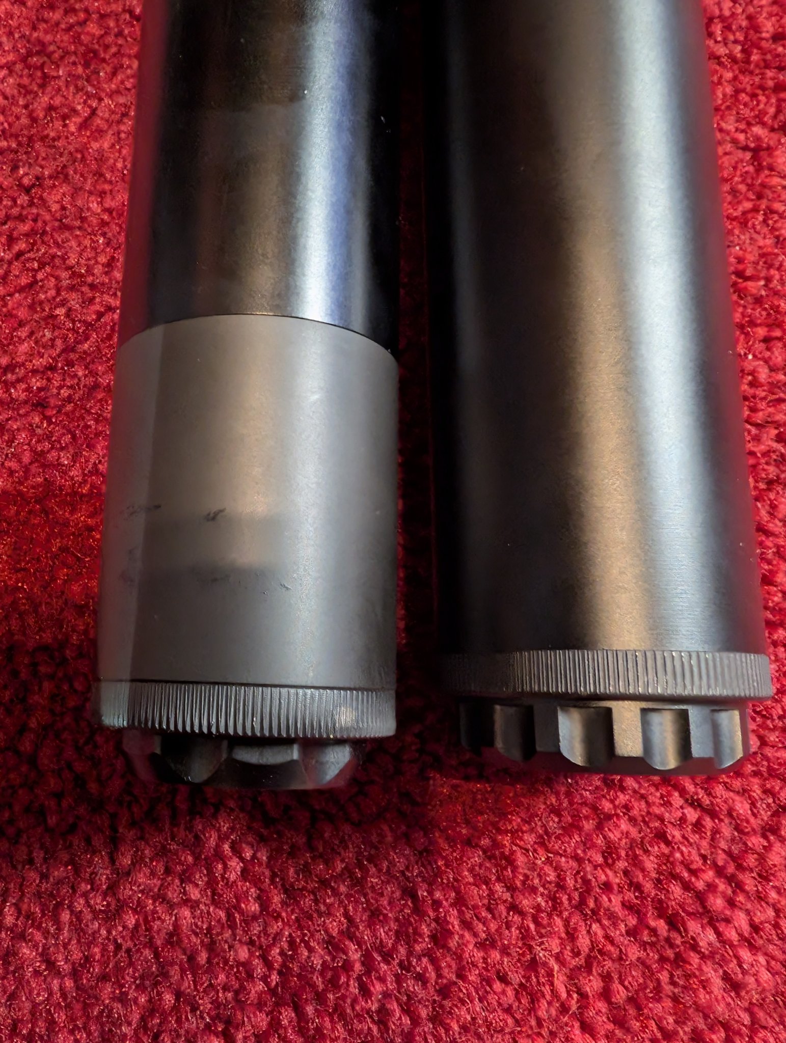

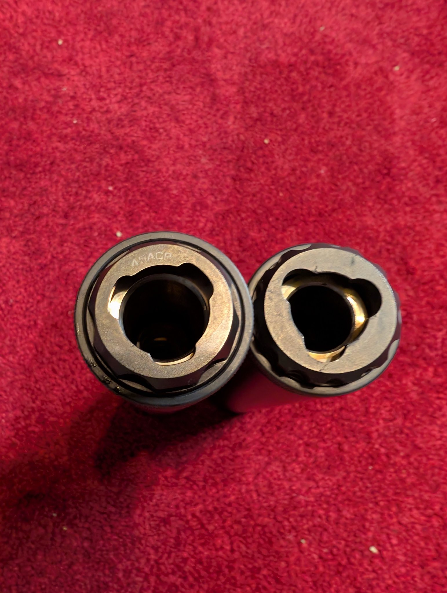

    Yes, here is a 9mm 3-lug and .45 3-lug. Each will screw into the back of either suppressor.
    I used to use a .45 can with a 9mm 3-lug.
    Reactions: BurtG
    I think most vendors are using the same threads on the tubes. I personally have used SilencerCo, Griffin Armament and Rugged interchangeably with no issues. It doesn't have to be a SilencerCo adapter to work.
    Reactions: BurtG
    A 45 cal 3 lug and a 9mm 3 lug are different sizes. You can either get a a 9mm 3 lug adapter and screw that into your suppressor (I'm pretty sure the octane is hub threads so most will fit), or get a 1/2-28 to 5/8-24 thread adapter and a 45 cal 3 lug muzzle device.

    I'd be willing to bet that these are just like the Rugged Obsidian 3-lug mounts. BOTH the 9mm and .45 version will fit in BOTH their 9mm and .45 suppressors (same mounting on the back on the cans). The difference being what caliber host weapon you're shooting it on. The .45 tri-lug mount has a larger internal diameter and will wobble around if used on a 9mm weapon, and can cause a baffle strike...Or worse. Which is why they make a 9mm version, that is spec'd to the H&K MP5 tri-lug, so it fits really nice and snug and there is minimal play to avoid any wobble or baffle strikes. I run a Rugged 9mm Tri-Lug mount in my Obsidian 45 can, and use it on my H&K MP5. Absolutely perfect and flawless fit, with minimal wobble...Just like it's supposed to be.
