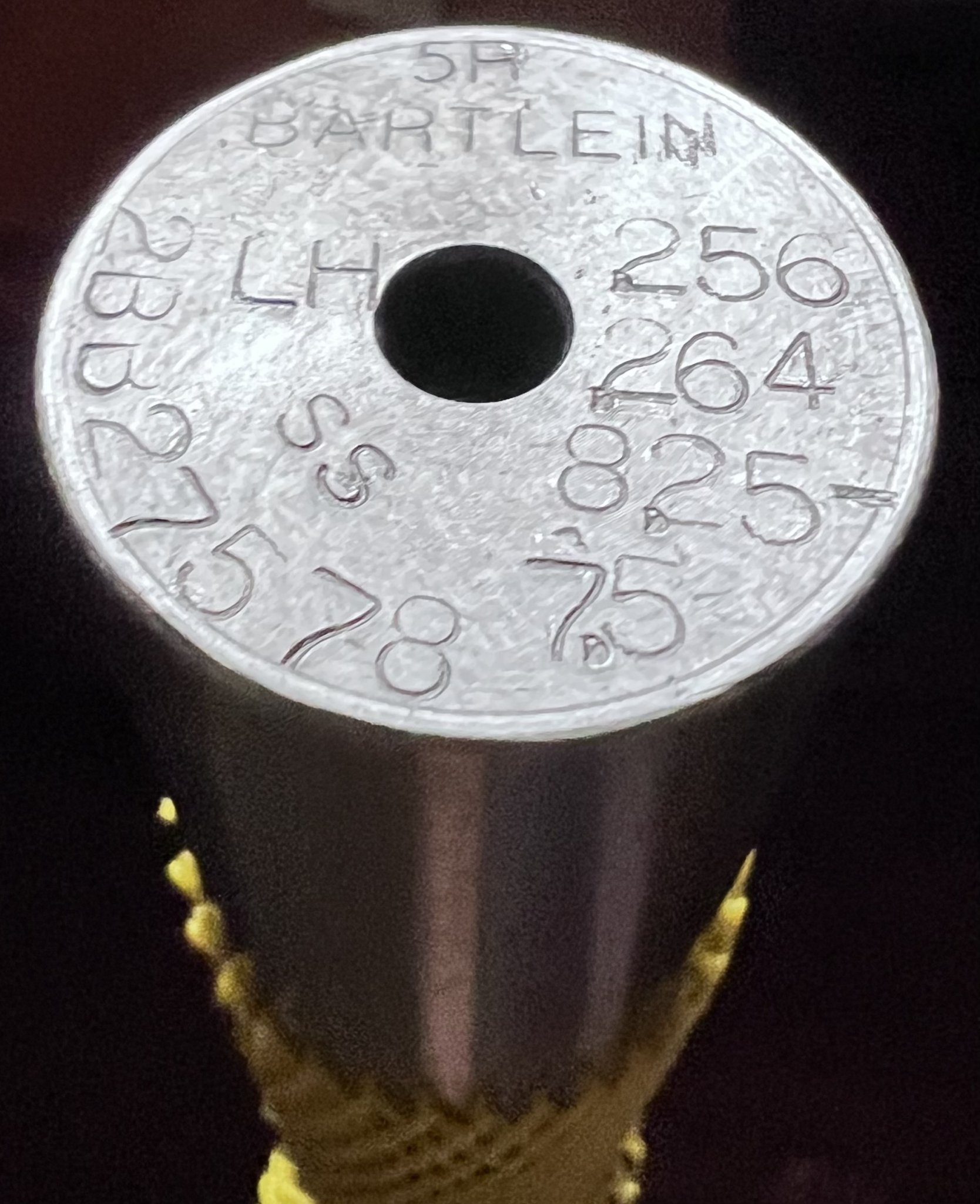

Received the same rec... 8.25 to 7.5 on my 6.5prc build to shoot 153.5lrht & 156eol
@ar152203 other people have run 7 twist for long 6.5 bullets... I get 1.94sg gyroscopic stability for 153.5lrht .356g7 @ 3200fps, which should perform great (although I'd imagine you'll run them under 3,200fps). Why not just call Bartlein to ask though?
Wow, this is about 2 years ago but Mark at Bartlein indicated that they favor a .5" gain...in my 6.5 manbun case that ended being 8-7.5. I originally was going to go with 8.25 - 7.5 until i spoke with them.
Perhaps their recommendations have changed....or maybe it really doesn't practically matter (more likely, IMO).
