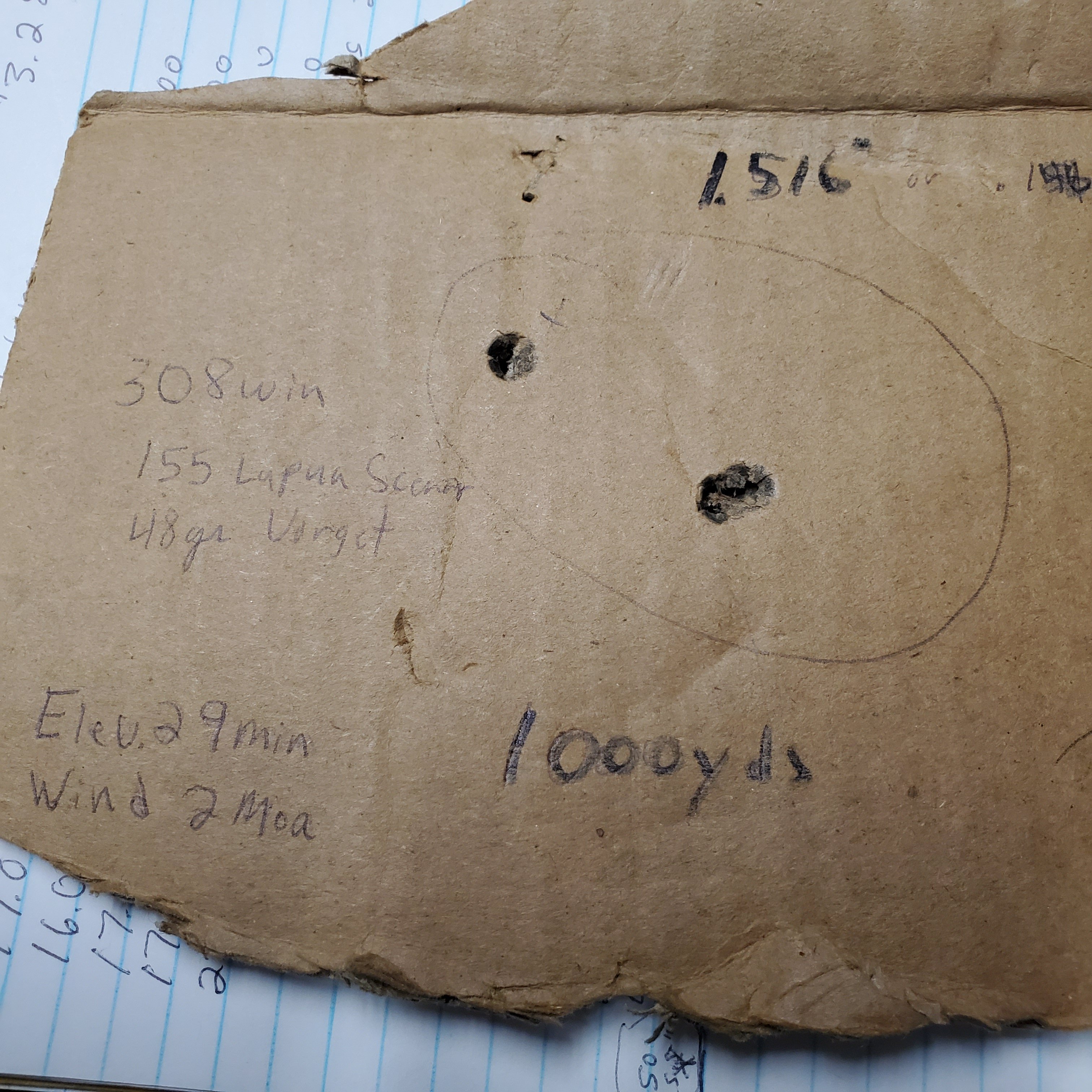

I have a 20" 1/12 twist barrel. Will it stabilize a 155 Lapua scenar or am I totally off base here.
Correct me if Im wrong but isnt the scenar longer than a typical 155 grain bullet? Would I need a faster twist?
I am shooting 168 grain to 800yds no problem but I would like to push it to 1000yds. I tried 175 grain but
my rifle doesnt like it at all, 1.3" groups at 100yds.

12 twist is plenty for the 155s, which is not to say they'll always shoot well from all/any 12 twist barrel (hopefully that's obvious).
