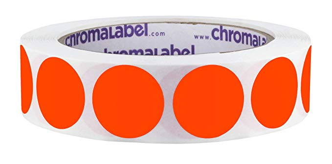

7095298
put your 5 shots inside that a 3 oz dixi cup at 100 yards shooting through the open end out the bottom should be close , have seen people shooting who do not have a 1k range shoot 1' circle stickers they say putting 5 either inside the first shot's hole or or touching each other is a good example , I have been trying the stickers cause they are really cheap . so far only 3 touching have I ever been able to do so far but good luck .
7095301
View attachment 7095298 put your 5 shots inside that a 3 oz dixi cup at 100 yards shooting through the open end out the bottom should be close , have seen people shooting who do not have a 1k range shoot 1' circle stickers they say putting 5 either inside the first shot's hole or or touching each other is a good example , I have been trying the stickers cause they are really cheap . so far only 3 touching have I ever been able to do so far but good luck .View attachment 7095301
if this is what is used at 1000 yards
4.7 800, 900, and 1000 Yard Target(a) NRA No. LR - Aiming Black (inches)Rings in White(inches)X ring ....... 10.00 10 ring....... 20.00 9 ring........ 30.00 8 ring........ 44.00 7 ring.......... 60.006 area . . . 72x72 square
than shooting inside a 1' circle at 100 could be used to practice with if the poster of this post did not have 1k range to shoot at
