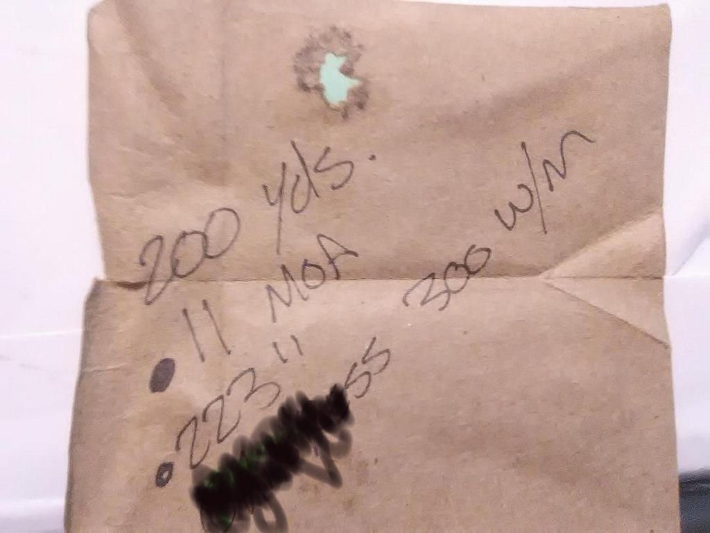

A gentleman drove from his state to my state/home and dropped off $3500+ worth of rifle, optic, mounts, bipod etc. goodies and $200 "to get me started" on installing optics and accessories, going through the rifle and slicking it up and ultimately working up a long range load. He didn't know me from Adam, I was a just a guy he had read after a couple times on internet forums. With a handshake He was gone in 15 minutes. Well I went to work. Came out incredibly well.
200 lazered yards
5 shots
.223" c to c group
.11 moa
SD = 8fps.
Not bad for a factory off the shelf rifle that I put some TLC into. (sorry, could get the pic of the group to embed.)

Worked up a load with Berger 215 hybrid VLDs. Weight sorted FULLY prepped/trued & annealed Win brass. H1000. Wolf primers. Don't remember the MV, plenty hot and SD numbers of 8. CoAX run out of no more than .002" Sorted bullets via bearing length. Neck turned the brass just a bit to even wall thickness consistency a bit. Say... turned them to about 80% clean up?

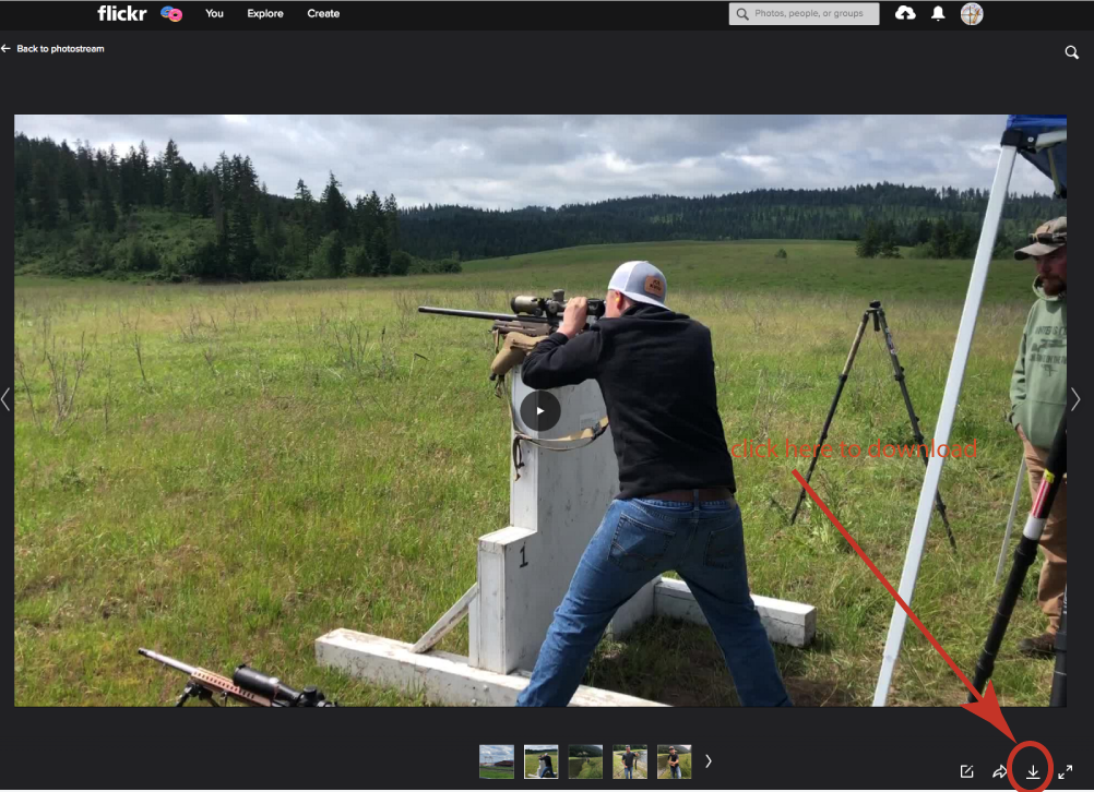

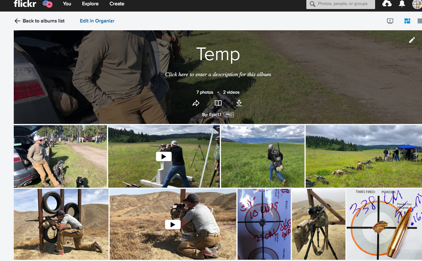

On fliker
Open your photo stream or album image to view it.
Double click on the image you want to download
^ Click on the download button and save.. to your computer

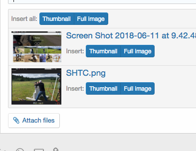

v Click on Attach Files in the forum thread, wait for it to up load. Put the cursor were you want the image; then move the mouse and click "Full Image"
Reactions: TresMon

The rifle that OP worked on shoots one hole groups at 200yds. Awesome
