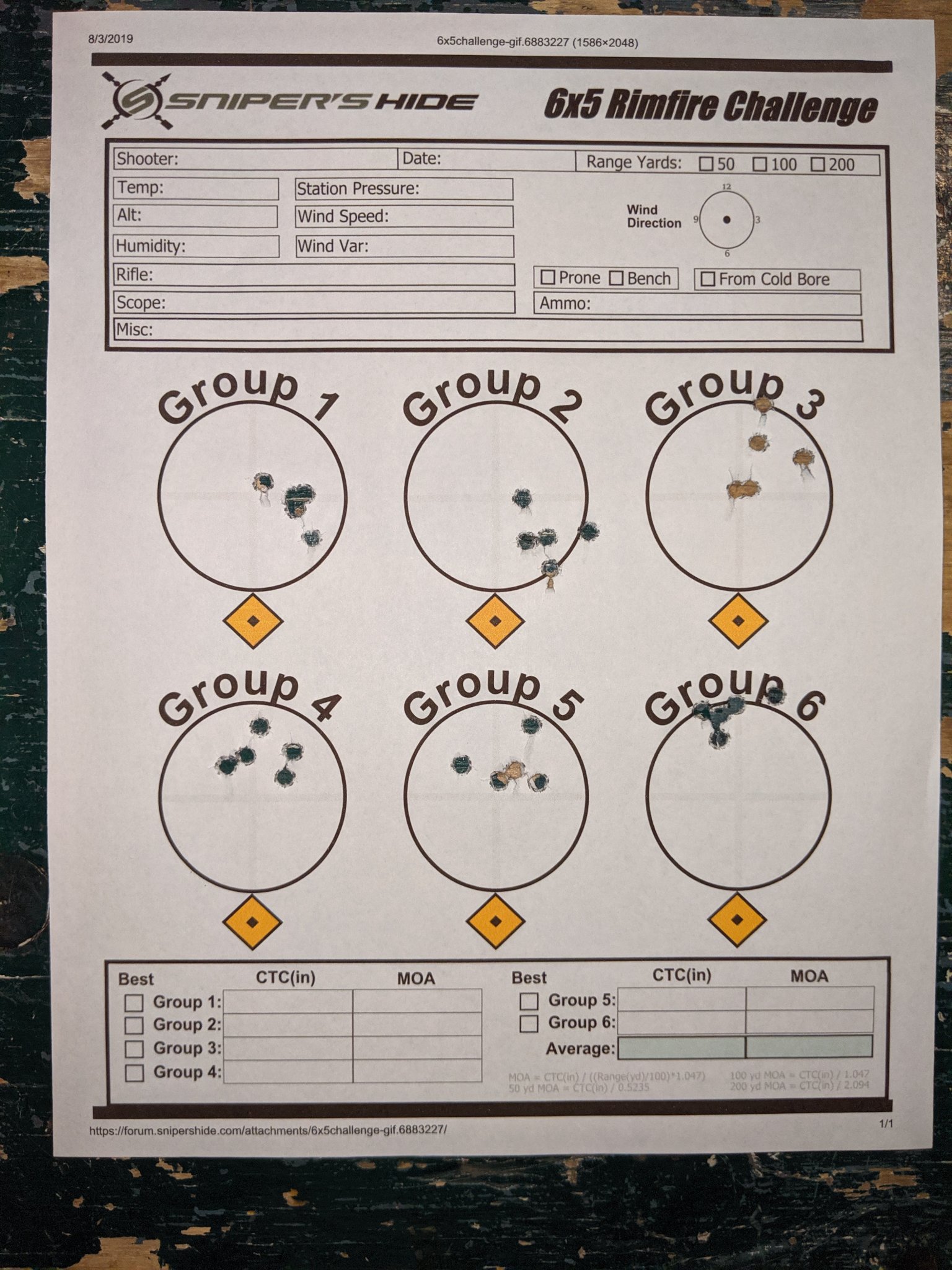

    6 groups of 5
    Forgot which ammo this is but it's a sample.
    Try Eley Contact for a 10/22. And if you look at those 6x5 groups above realize that is a 2.5 inch group your looking at. Practice and your 10/22 will do that too.
