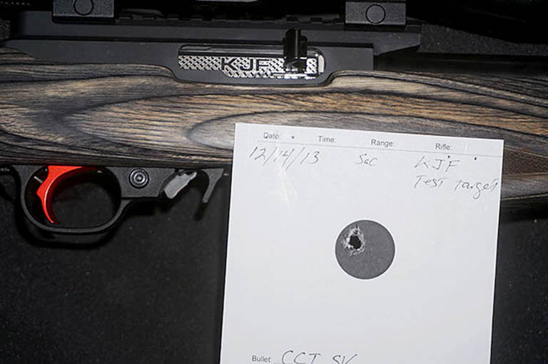

I suggest Feddersen too, that being said I put Green Mountain barrels on the 22's I built for my nephews and they both shoot one hole groups at 50 yards with CCI SV.

The GM barrels I put on for my nephews rifles both shoot like this, 5 shot group, bipod and a rear bag. I put targets in the case with the rifle for their Christmas presents that year. This was after less than 20 rounds through the barrel after zeroing the scope for the first time.
