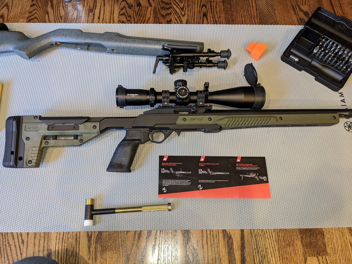

Just remove the 10/22 competition stock rear tang. That's what I did when I stuck mine in the MDT Oryx.

The MDT Oryx 10/22 has a rear clamp to basically bed/tighten the rear.
