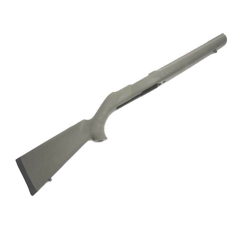

    Was thinking a stock (unsure of color) similar to this:

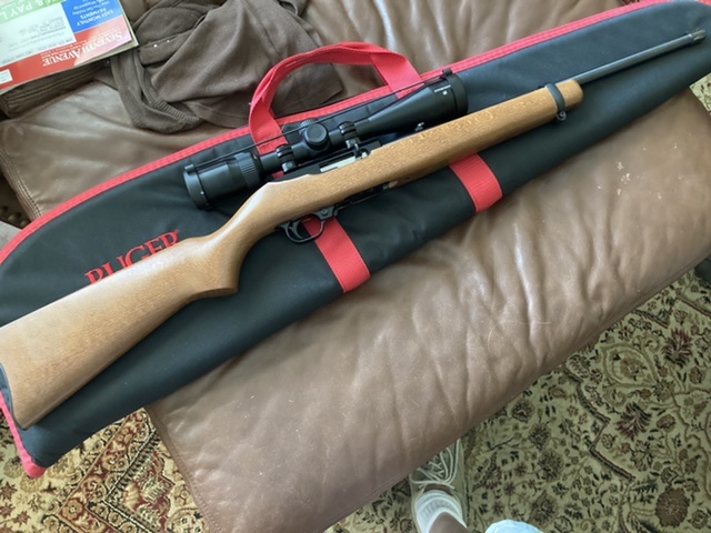

    I have a standard 1976 ruger 10/22 stock that works fine for me with an inexpensive extended recoil pad.

    I did at one point have a stock similar to that one. It was comfortable and easy to install, but the action never felt like it was mated real well with the stock, I could take both ends of the gun and you could feel it move (only 1 action screw holding it in). I did put a little bedding material in it to tighten it up, but it never seemed to do a real good job (there just isn't much material to work with).
    I eventually felt that a heavy barrel hanging out there without any support was probably not a good idea considering how little the barrel interacts with the action, so I placed it in a Magpul hunter stock and it was been going strong since.

    Starting with this, which stock, actually shoots pretty good. Just want something ultra light to mess around with. Should be able to get this thing in around 3-3.5lbs w/o optic.

    Those stocks work well, I have something similar for the builds I did for my nephews. I added a brass screw that indexes with the cleaning hole on the rear action for a second anchor point. Mine have green mountain or feddersen barrels. For a lighter barrel I'd get a tapered steel from Feddersen. https://fjfeddersen.com/product-category/22lr-rifle-barrels/contoured-22lr/

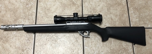

    Picture of the only 10/22 I still own.
    Tac Sol Barrel
    Ruger receiver polished inside
    Kidd guide rod and springs and trigger
    Hogue stock
    Reactions: OldSalty2

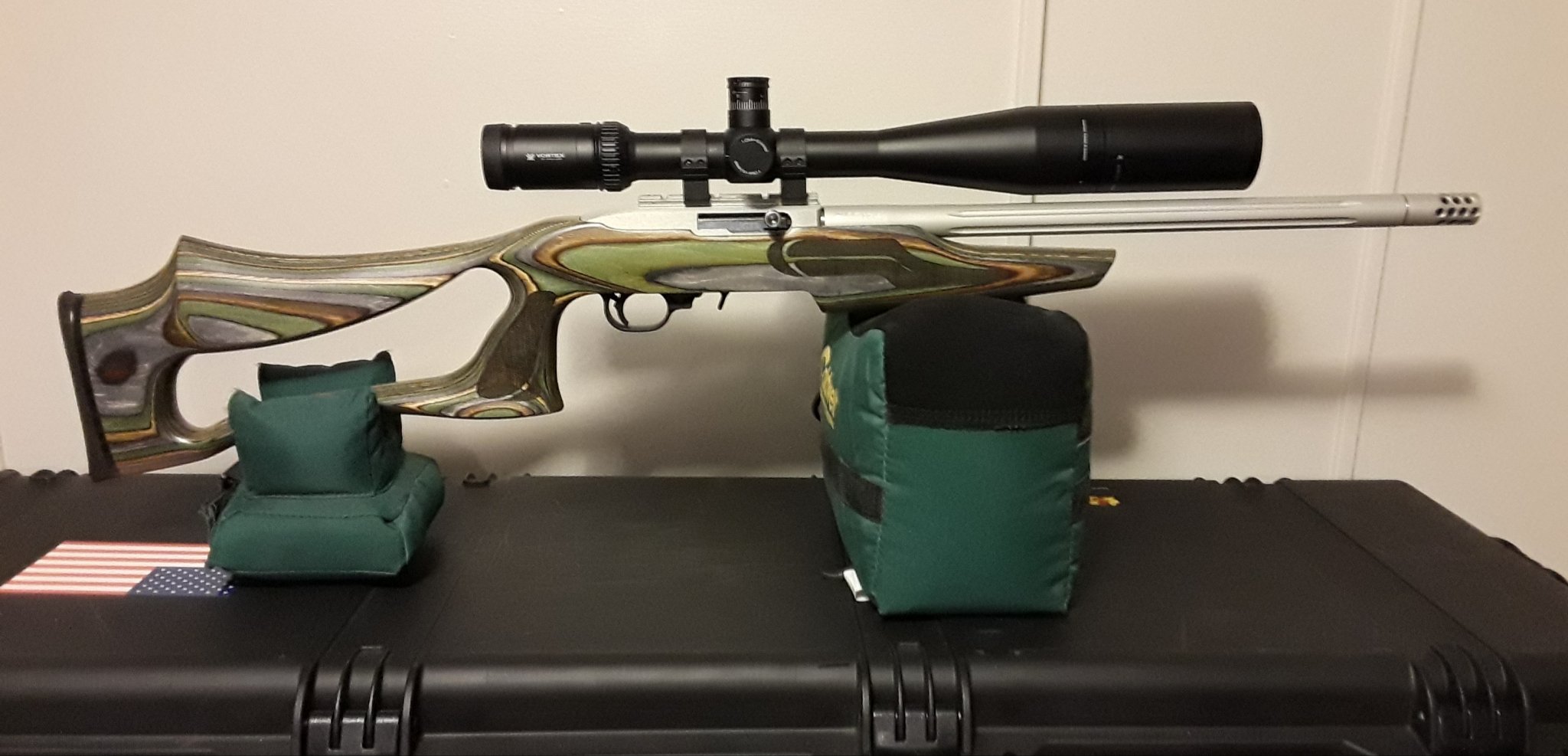

    I have no complaints about mine. 14x Falcon ffp, TacSol barrel, Kidd trigger group. 10shot group CCI minimags.

    Very nice rifle and you gotta love the mini mags.I am amazed how small of a group I can get with them at 100 yds and they function in all my semi auto rifles and pistoles.

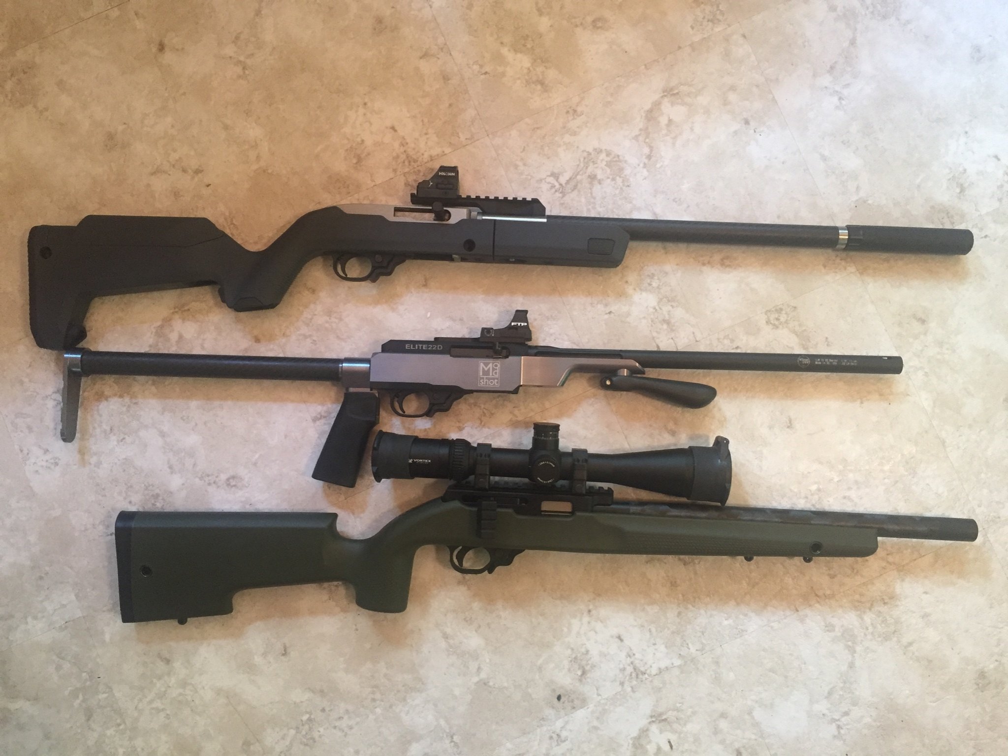

    I’m fixing to go down this 10/22 rabbit hole. Got a KRG Bravo on pre-order. Intend to do a Kidd bull barrel, trigger upgrades etc. But I have this question. Why in the world do we do this?😂 Take a $200 rifle and replace virtually everything on it. Have a crap load of money spent and still just have a 22 auto.
    I think the answer is probably “Cause we can”😎

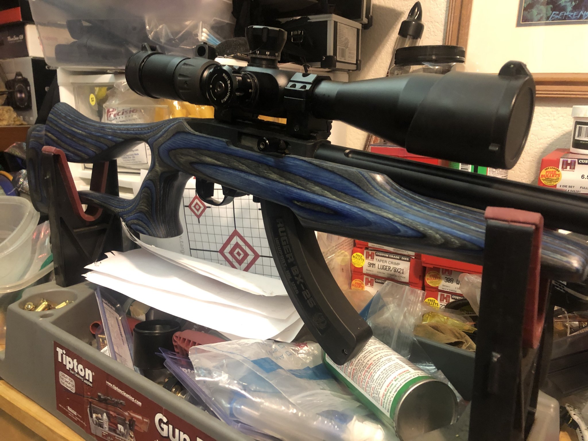

    Current configuration. Input appreciated.

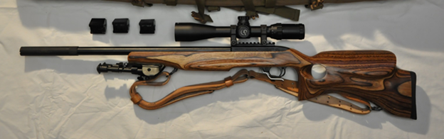

    Fajen Stock, Adams & Bennett Threaded Heavy Match Barrel (cut to 16.5"), SWR Suppressor, Harris Bipod, 1907 Leather Sling, CenterPoint 3-12x44 Scope.
    I bedded the receiver to ensure a free-float barrel. Super fun and quiet.
