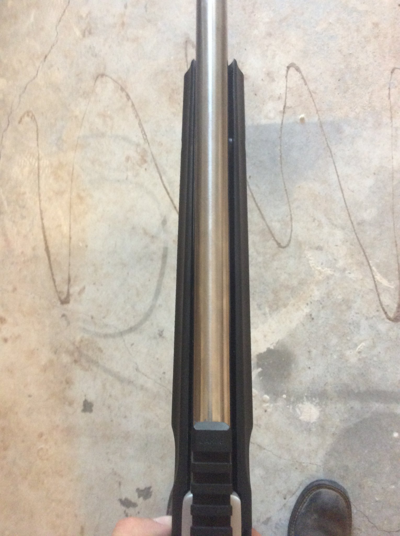

Installed the Clark’s Custom in the Titan 10/22 stock. Barrel laying right down the left side of the stock. Hopefully I’ll calm down and figure this out. Hit me up if this is normal or you know the fix. If not, keep an eye on the PX, or my trash can.
First check the straightness of the receiver:
Canted Barrel Test
