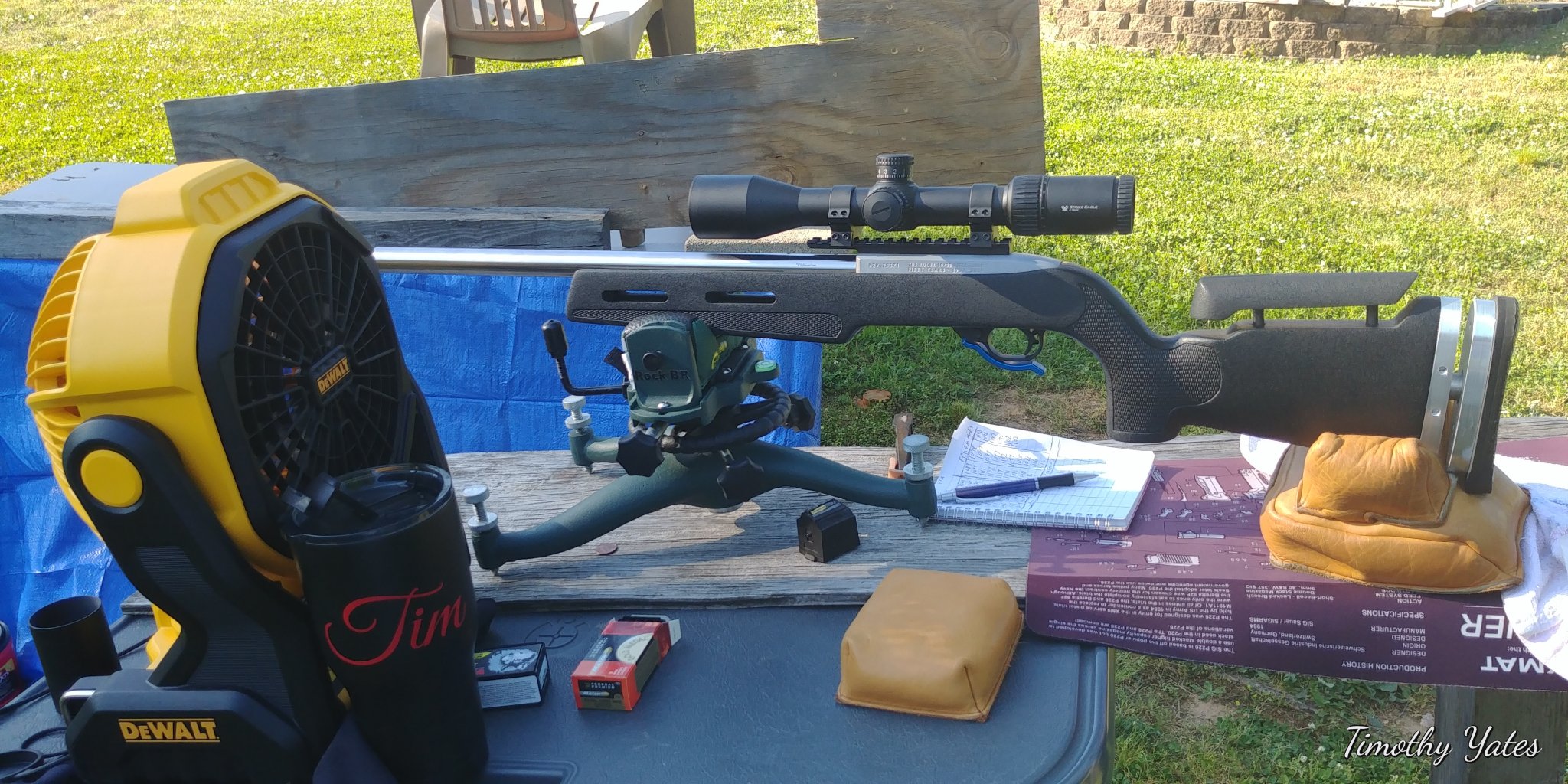

Most of my 22 rifles have EGW rails on them except the Kidd receivers where I used Kidd rails. I bought one cheap rail for an "inexpensive" 10/22 and the screw heads stripped out during install. I may have to use an ease-out if I ever try to replace the cheap rail. Lesson learened... I'll be sticking with EGW rails from now on.
I use the Burris XTR Signature rings since I want to bottom out the scope to provide all the elevation possible to dial longer ranges. The inserts of the XTR rings allow you to add up to 40 MOA of cant.
I agree 100% with Bill on the Burris Signature rings with inserts. I have tried other rings "and like some" but I keep coming back to Burris Sig rings of some type. I use the XTR rings for my 34mm scopes, everything else I drop down to the regular Burris Sig rings.

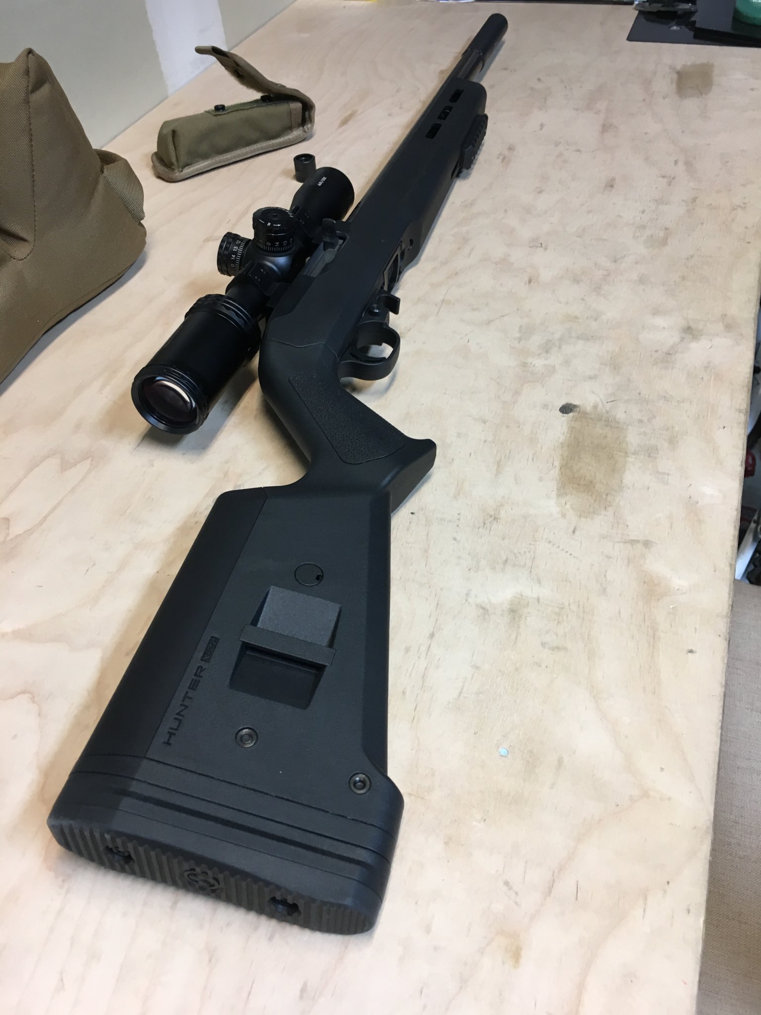

I use EGW bases and Warne rings. It’s a 22 so I think anything past a 60 dollar base and 75 dollar rings may just be overkill hahaha. They just don’t have the recoil/inherent abuse of a big cartridge to me to justify anything stronger. I’ve yet to have issues with those setups on several rimfire guns over many years and many thousands of rounds.
