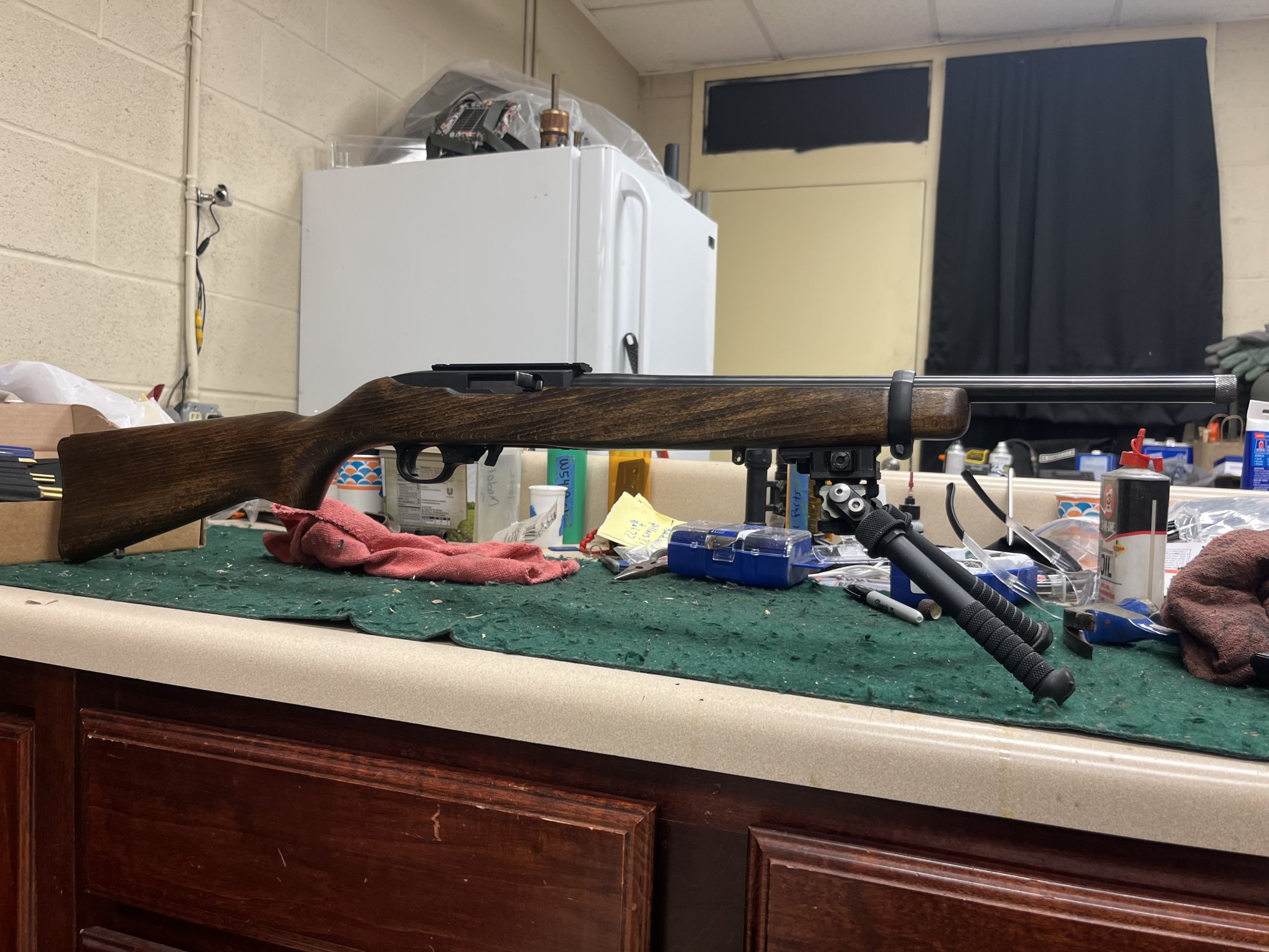

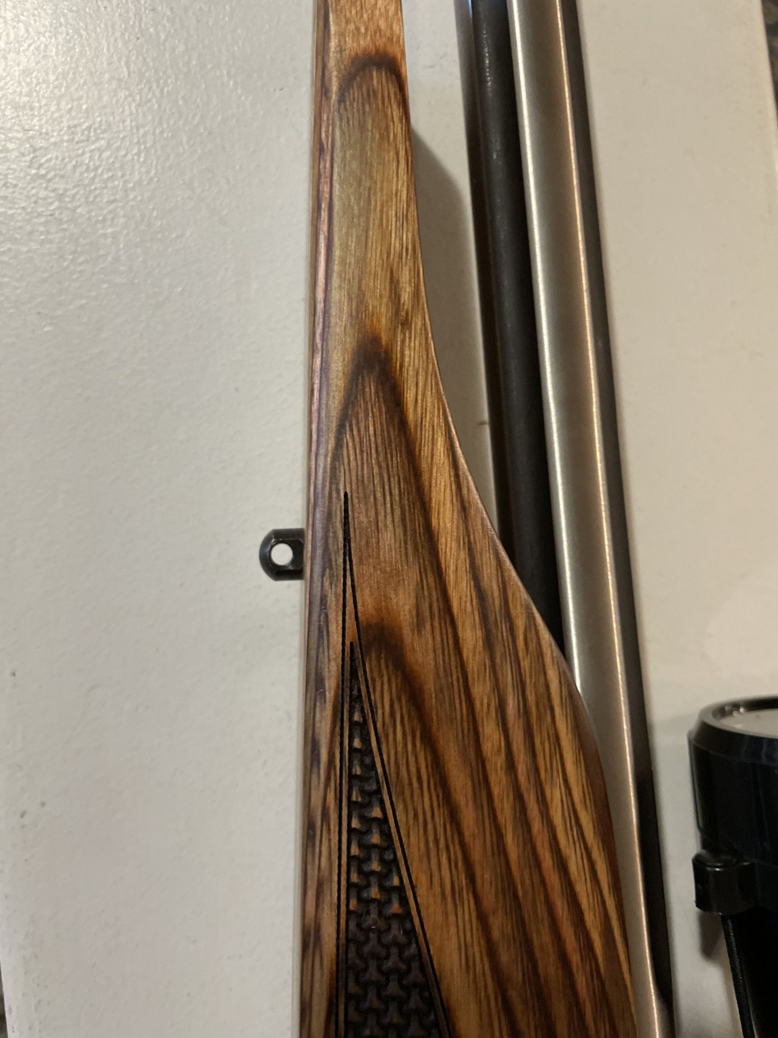

Just got a 10/22 Target model. Looking to add a bipod, or a pic rail then a bipod. It has a sling stud. I cant find anything that will fit... stock is completely flat and all the rails and bipids have curved bottoms. Anyone know of something that will fit?
Someone gave the suggestion of just shooting off a rest, but would rather have something attached

You can use the Stud mounting hole as one end of the Pic rail. Mark the other rail mount hole on the forearm and drill the appropriate hole and use a t-stud on the other side to secure the bolt. Trim the bolts to length (even with stud top) and you are good to go.
This is exactly what I just did to my dads 10/22 except I used a arca rail from area419
