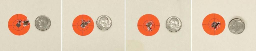

Are you guys seeing a big difference in consistency since moving to the Titan? Can anyone post before and after groups? My 10/22 is currently in a Hogue overmold but since I changed from a 44mm scope to a 50mm Diamondback Tactical the comb on the hogue is too low and doesn't fit me as well as it did. While adding cheek riser pad would solve the fit issue i think I'd like to try something with a different grip and I'm also curious if the bedding block and rear spike in the Titan make a big difference. The rifle already has a Green Mountain SS bull barrel and VQ trigger and with quality ammo it's by no means a slouch, I'd just like see if a new stock will make a significant enough improvement to justify the cost. Below are some 5 shot groups at 25 yards with CCI Green Tag in its current configuration. It shoots a bit better with RWS Rifle match and even better with Center X, but I don't have any pictures of those groups.
My experience with the Titan is that it won't necessarily increase the accuracy but it will make a significant difference in the consistency of your set up. I haven't used the specific Hogue stock that you have but my 10/22 used to be in a cheap Butler Creek stock and later on in nicer B&C stock. In either one of those the accuracy was fine but it was not uncommon for me to experience drastic shifts in my zero in just one range session. If I added a sling to the mix then it would affect things too.
Fast forward to when I dropped my 10/22 into a Titan stock and my zero was consistent from range trip to range trip, from match to match. I don't have to wonder if I'm going to end up having to make some adjustments to back on zero, I can trust that my zero is good, just like I can with my center fire rifles. Also, with the free floated barrel and anchor lock system slinging up doesn't have a negative impact on the rifle either. I can sling up, dial on my dope, and go to town.
Like in the story I relayed up above, I've been able to take my action out of the stock, drop it back in, torque it down, and not have to change my zero. I was never able to do that with the other stocks that I used. The Titan stock is one of the best accessories that you can get for the 10/22.
I can't honestly state if moving from a Hogue stock to a Titan would make a difference in accuracy. What I can tell you is that I personally prefer the vertical grip of the Titan than the standard angle of grips on most 22LR rifles. I suspect that you'd also need the cheek riser for the Titan too. If you buy the Titan and don't like it, I bet you wouldn't have a bunch of trouble selling it at a discount.
