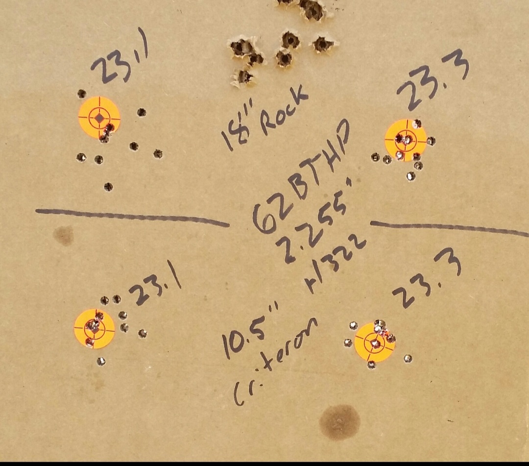

i realize separating cheap barrels from more quality ones will probably make a difference but as far as spending $300 vs $600 am I going to see THAT big of a performance difference? I want something that will be capable of 1 to 1.5 moa with off the shelf ammo. Realistically I’ll be shooting 55g and 62g ammo for the most part for plinking and then getting quality ammo occasionally for seeing what me and the gun can do. If I’m going to soend the money on a quality barrel i fee like i might as well get a headspace matched bolt with it. CLE has a ready to ship 10.5 for like $515 with the bolt… am i going to see that big of improvement over a DD or a noveske for $300?
IMHO you are wasting your money. Get a decent enough barrel and call it good. These types of setups are designed for close range, at least a 10.5" is. Typically that specific barrel length is 'effective' out to 100 yards or less. That said with my 10.5" I can effectively hit targets beyond 200 yards with little effort using a 1x Aimpoint. The limitation isn't the barrel, it's the optic and the ammo.
Chasing down 'extreme precision' with this kind of rifle goes really against what it's meant for, IE a much lighter and more nimble rifle that can maneuver around obstacles a lot easier.
Also while those machine gun barrels are nice to have, unless you have a full auto again it's a waste of time. If you get a cheaper-ish $100-$150 barrel (mine has a ballistic advantage) about every 12-15,000 rounds you might need to spend another $100-ish bucks on a barrel. That said if you are a high volume shooter it will be worth it to buy once and cry once with a more durable machine gun steel barrel.
Trying to get a matched bolt IMO is just dumb for this type of setup. Again a total waste of time and money to even think about that. You want a good off the shelf regular old BCG and you will be fine.
The intent of a shorter barrel is for quickness, speed, and maneuverability. Trying to make it benchrest level or anything like that is not a good use of brain power.
My 10.5 can easily hold an MOA and it has a Ballistic Advantage barrel. That said, the difference is going to be in the ammo. Also my 10.5 is zeroed at closer distances. Somewhere around 50 yards or in would be about right for this setup.
Im leaning towards the barre 346ci recommended. Seems to fit what I’m looking for and i like the mid length gas system. Figured that with a superlative arms adjustable gas block? Then when i get the suppressor i can tune it to run with it and it’ll pretty much live on this upper.
Good copy on that. 55s and 62s for plinking and then match grade for seeing what it'll do.
a good barrel should hold under 2 moa with match ammo. i have found speer gold dots to be about 1.5-2 at 100yds in some barrels. of course IMI razor core as well.

Here is a test I did back in 2019 looking for a load that was tuned for my 10.5" Criterion but would still shoot decent in my 18" rock creek. I was using a faster burning powder in hopes to lower the amount of blast in the shorter barrel. Bullets are hornady 62gr bthp's and target dots 1 inch. 10 shot groups.
