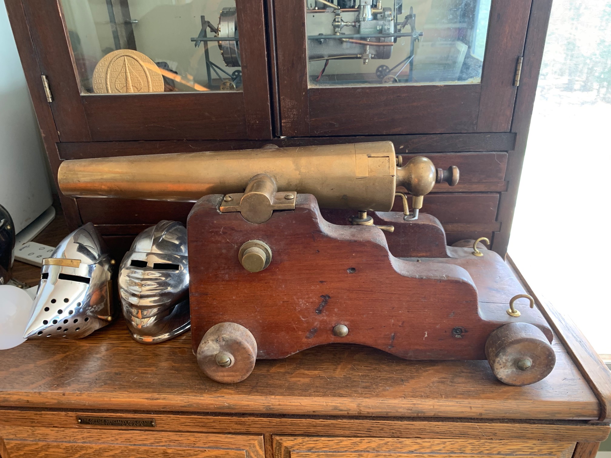

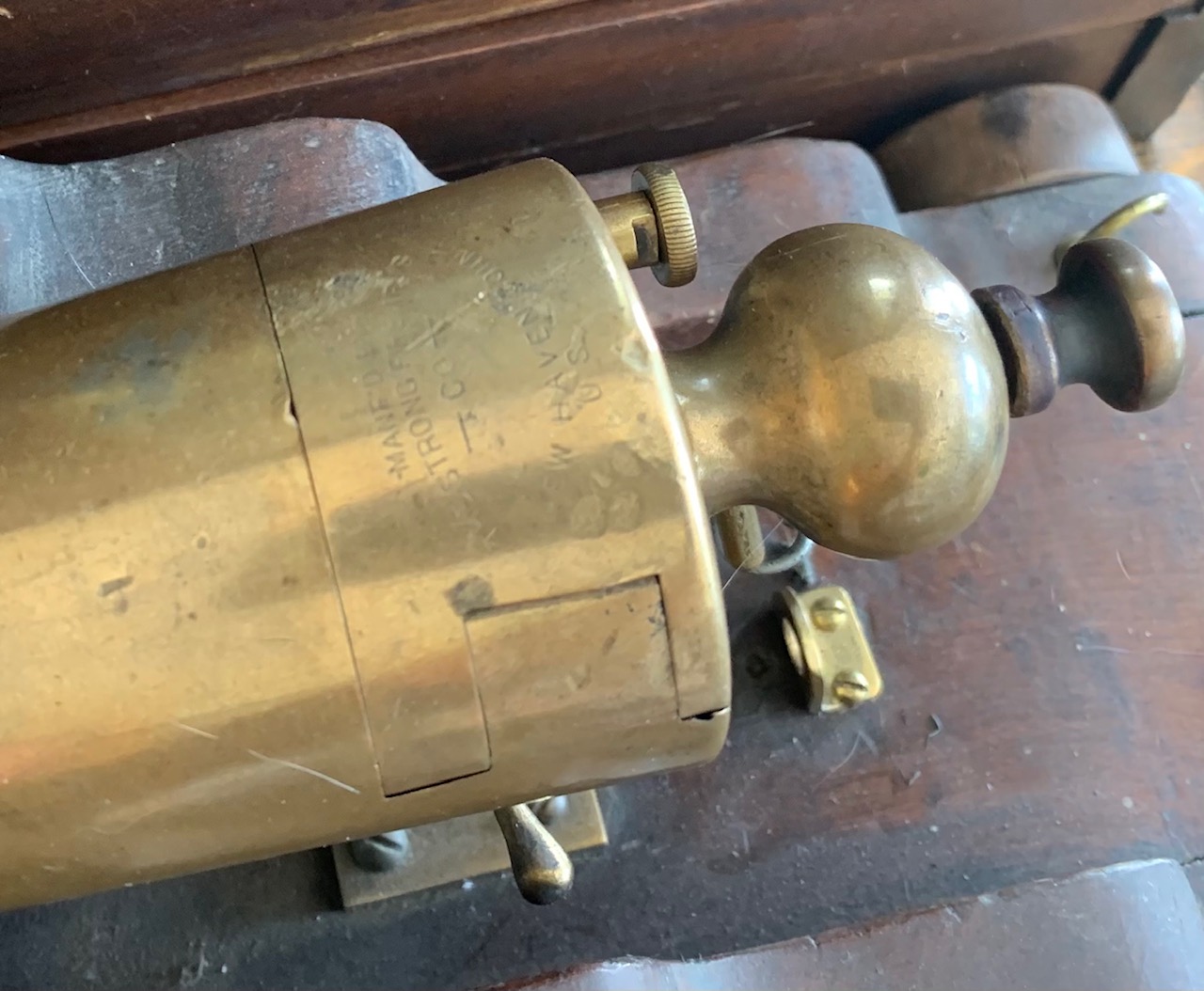

Here is my 10 Ga Strong Signal cannon. It's the same company as the famous one from "Magnum" which is floating around the Interwebs with an insane price on it. I got this from a place in PA that also had a 1/3rd scale Parrot rifle by a known maker that I bought for a song! This was sitting next to it and I scarfed it up as well. Was missing parts and pretty sad. But it's all restored now.

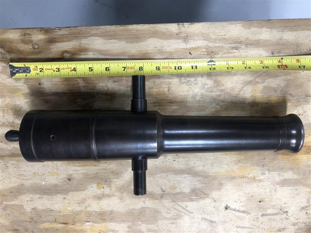

Here it is sort of for scale. Barrel is about 16" long.

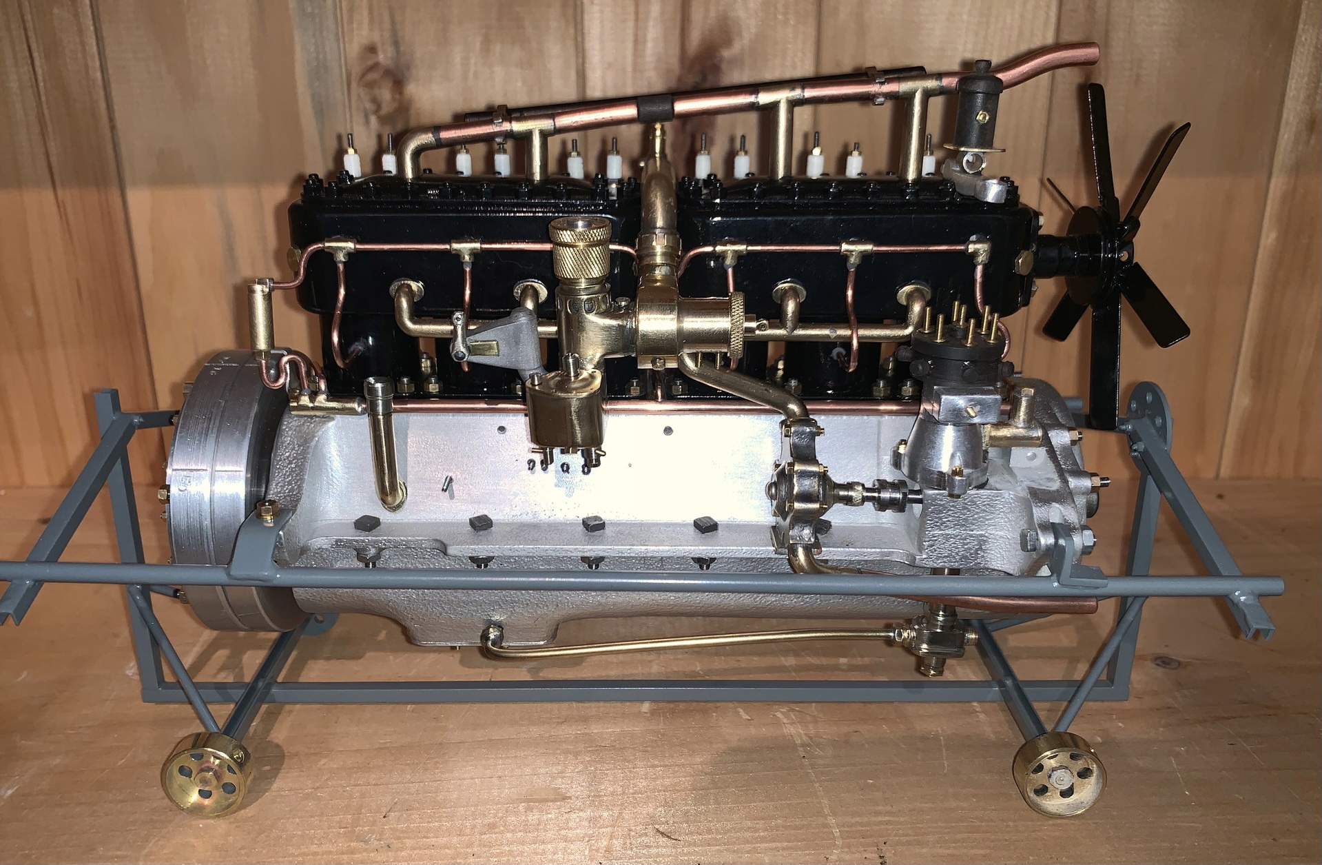

What is in the cabinet behind the cannon?

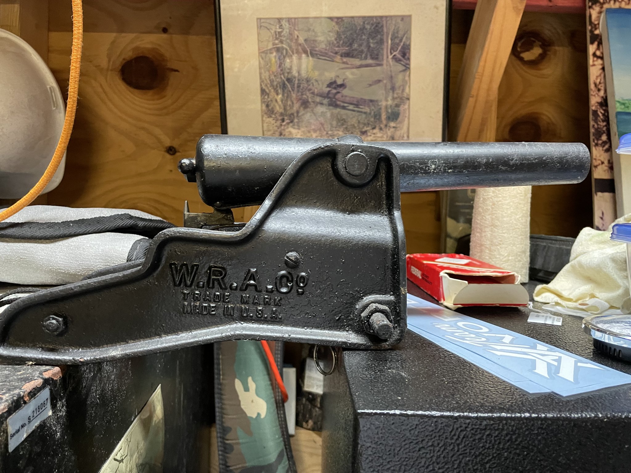

Sorry it took me so long to reply I was out of town for few days let’s see if I can’t remember how to post pictures. It’s nothing fancy very plain. A friend of mine is building some wooden wheels for it.

Nice Model 98. Missing wheels, but they are easily procured. And if using on a boat... wheels are not a great idea!
Looks to be in nice shape! Real black powder will give good smoke. A corn meal mixed with flour can enhance it a bit more. But BP shells smoke a lot!!
To the person who asked why they can’t fire loaded shot shells... blanks make a nice report with little pressure. Shot gives a huge force both in chamber pressure and back against the breech. A 10 ga shot shell would create so much recoil force and chamber pressure, the cannon would go off like a grenade. Blow the breech right off and might even explode the barrel. Do NOT fire projectiles in report cannons.

That’s definitely cool. Have the guy who loads the shell switch to black powder. And it will be fine. He can order black powder FFG for a 10 gauge. Best place to order is Dixie gun works in Tennessee. They can ship no problem with a hazmat fee. As long as you are storing less than 25 pounds you don’t need a special facility. 2 pounds loads a LOT of 10 gauge. Cheers Sirhr
