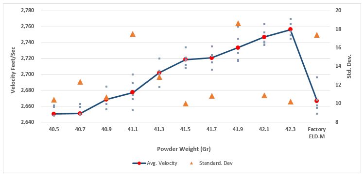

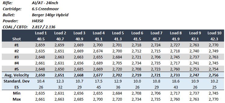

10-Shot Load Development Results Berger 140gr Hybrids/H4350 - Where would you go from here?
Senor_Barney
Play stupid games, Win stupid prizes
  • Jul 25, 2020
    976
    327
    Northern California

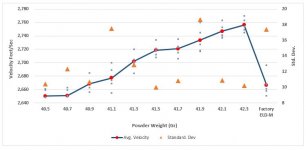

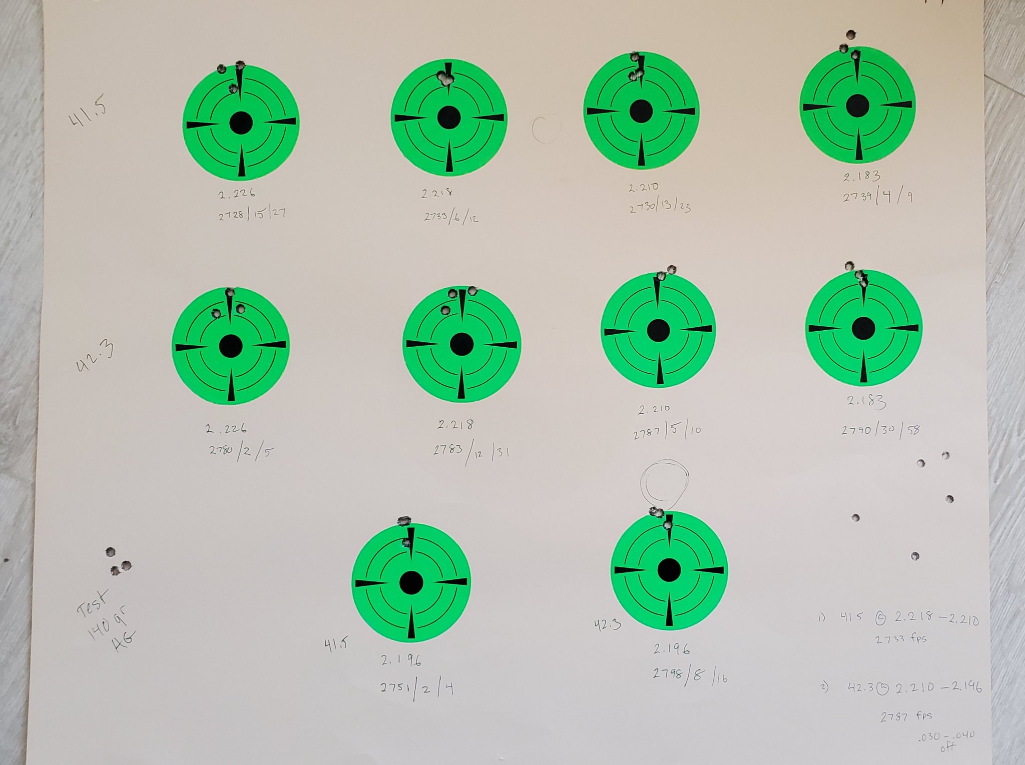

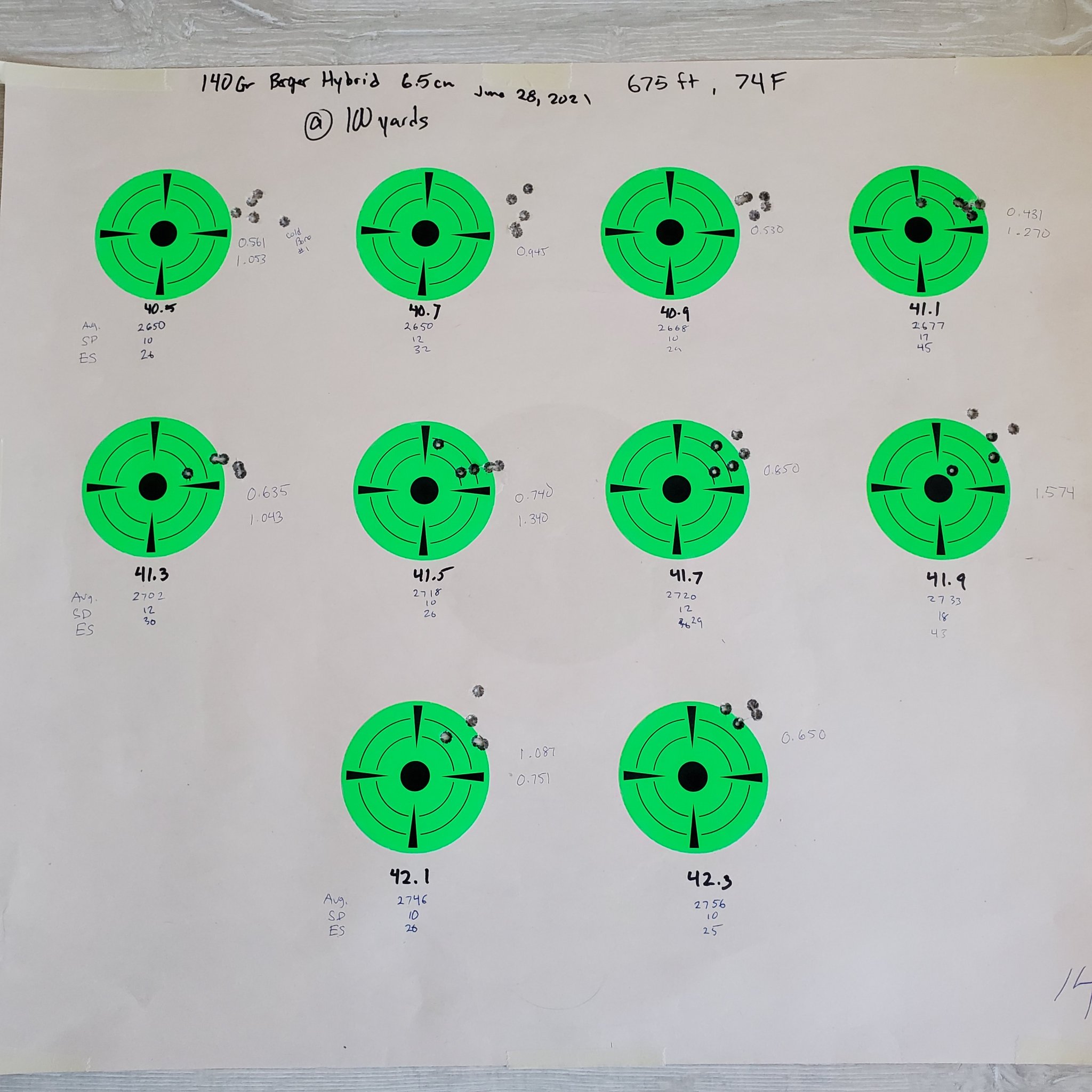

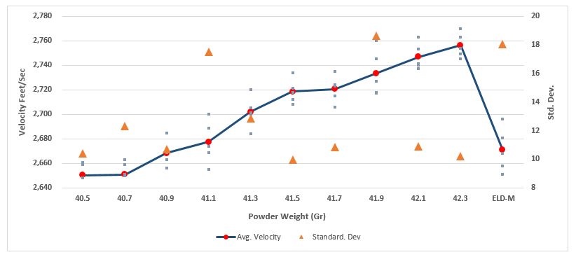

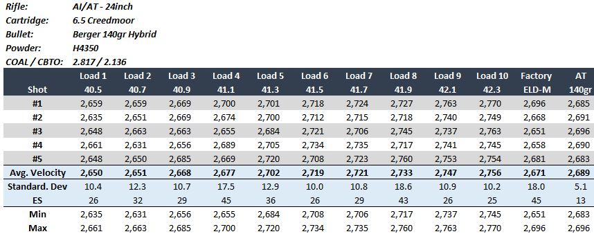

    Finally had a chance this weekend to put everything I gathered from Hide reloading resources into practice. All the data gathered is posted below.
    Would appreciate any / all observations from those more experienced re-loaders as I'm having some questions about where to go exactly from here.
    My guess at next steps:
    Load 3 rounds at each powder weight in Nodes 1-3 below. That is 9 rounds total in each node and 27 rounds total. I would then narrow down to seating depth, etc.
    • Node 1: 40.4, 40.5, 40.6gr --> But the groups look awful here.
    • Node 2: 41.4, 41.5, 41.6gr
    • Node 3: 42.2, 42.3, 42.4gr? Looks like may plateau around 42.3gr (which is max load per Berger for 140gr)
    • Wildcard Node: Is something developing ~41gr? The 40.9gr SD and Group looks good, but velocities look to still be accelerating toward 2700...
    As I've already spent a ton getting set up I'm prepared to also invest a tone of time fine-tuning.
    A few notable items:
    1) I wasn't focused as much on getting a tight group, but How much should I care about MOA size at this point? Hard to overlook the LOW SD of some groups with high MOA group and vice versa.
    2) No reason why I seated the bullets where I did. But I picked a CBTO (2.136) and took immense care to ensure every single round was seated exactly the same.
    3) I did not have the tools to measure concentricity / runout / net tension or any of the more advanced items
    4) Done with 1x fired Hornady brass -- Can I load a second time with this brass?
    5) I did a 5 shot group last week with Hornady 140gr ELD-M factory ammo gave my 2667fps with SD of 18 and ES of 45

    I would load 41.5, 41.6, 41.7. 10 rounds each. Low 10’s for SD isn’t the worst thing ever either. See what it does. I would do a total of 6 5 round groups, two per charge weight. If it doesn’t tighten up, proceed with a seating depth test and pick your charge weight you want to use. 3rds is not a significant data set. Neither is 10 but 10 is much better than 3.

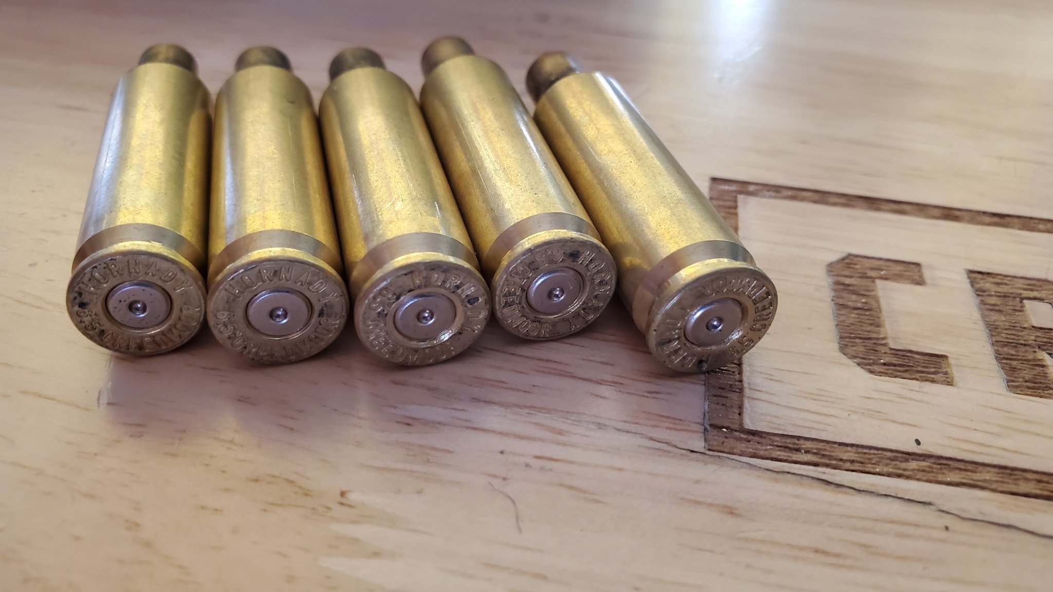

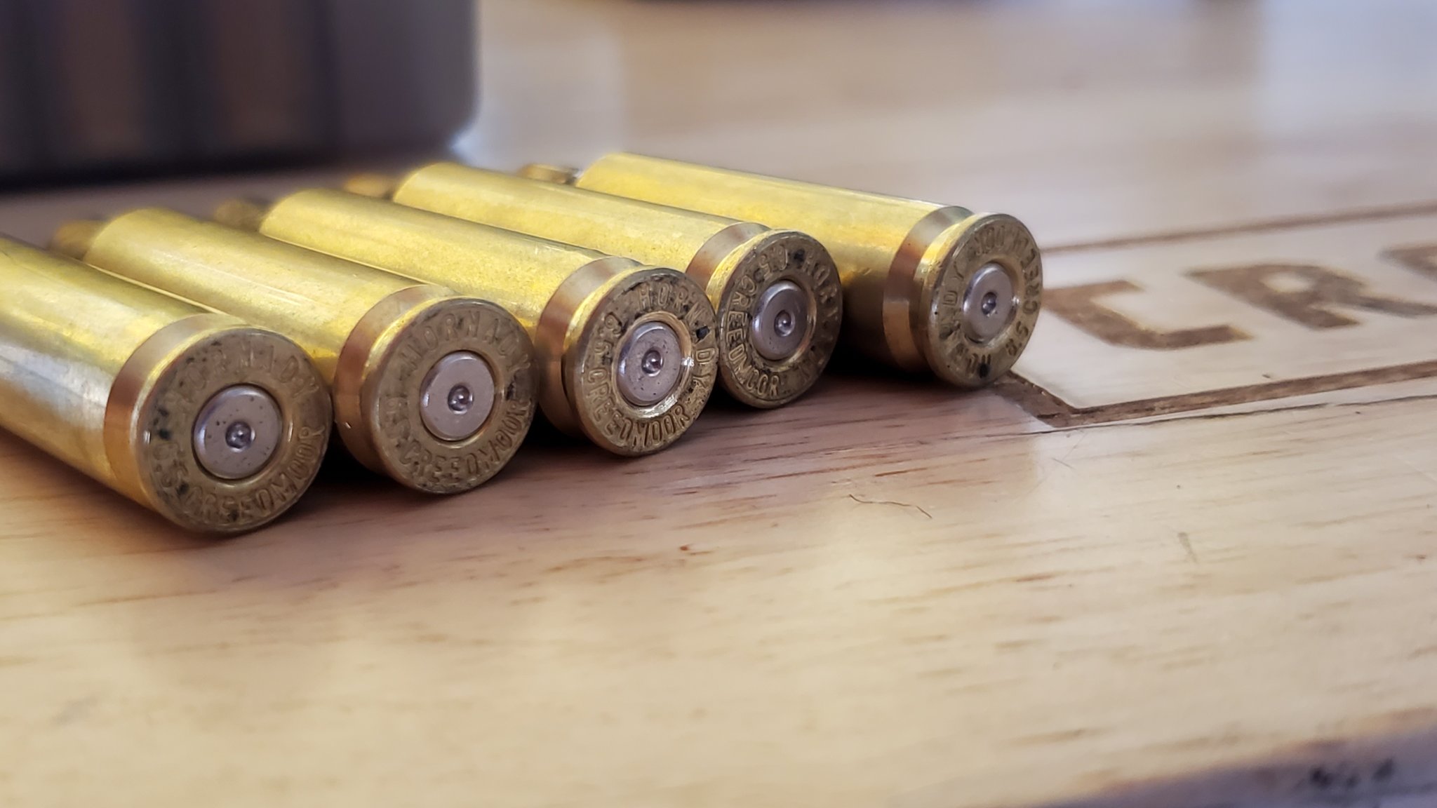

    As for pressure sign, nothing on the brass pics below or the primers gives an indication of pressure getting close to high. My target was 2750 so Ill probably do testing at the 41.5-41.6gr and 42.3-42.5gr levels.

    brass looks good. Probably helps you’re not pushing it hard. You should get many firings out of it if you keep pressure down. As far as the magnetospeed. I’ve heard a bunch about it affecting POI. But not about group sizes. If you’re worried about it test for speed, then seating depth separately
    This has been a source of contention and sore buttholes lately but your data mirrors what mine and many others have noticed with the 140 Hybrid in particular as well as other bullets with the same powder.
    Im not advocating for any one consensus just stating what i have found and even mixed it up a bit to include tests outside of my normal processes since i like challenge by people that whant to go a diferent route.
    I am open to all avenues even if we end up back on the same street after four right turns 🤣🤣🤣
    I innitially tested the Berger 140 Hybrid & H4350 and found the sweet spot to be between 41.5 to 42.0 with a .070" jump in a SAAMI .199 freebore but didnt seem to matter on the charge as long as it was jumped .070" so dumb Texas Hillbilly luck i chose right.
    Next tests will be varios groups with various powder charges based on temps ranging from 50° to 105° to see if i have it figured out or need to experiment further.
    I dont like to settle on a load personally until ive shot it in near 100° f temps as wella s low temps but im a hard headed asshole.

    Update...
    Moved ahead in development to a hybrid test of bullet seat depths at two different powder weights.
    Powder was 41.5gr and 42.3gr of H4350
    CBTO using Berger 140gr Hybrids in my AI/AT was 2.242-2.244 (mostly 2.242). I did my best to get a consistent single measurement...
    As such, the test was done at following depths:
    2.226 (~0.015 off)
    2.218 (0.024 off)
    2.210 (0.032 off)
    2.196 (0.046 off)
    2.183 (almost a whopping 0.060 off 😵)
    The numbers under each target are Seat depth/avg. Velocity/SD/ES
    Yes, I should have done 5-shot or more groups, but I only have so much time, supplies, etc. and went with 3 shots. May be less meaningful in results, I understand.
    Likely going with 41.5 and ~0.024 off...or could go with 42.3 and ~0.030 off. Seems like 41.5 has more wiggle room for seat depth.
    Very interesting to see avg velocity increase ~20fps over the 5 different seat depths!
