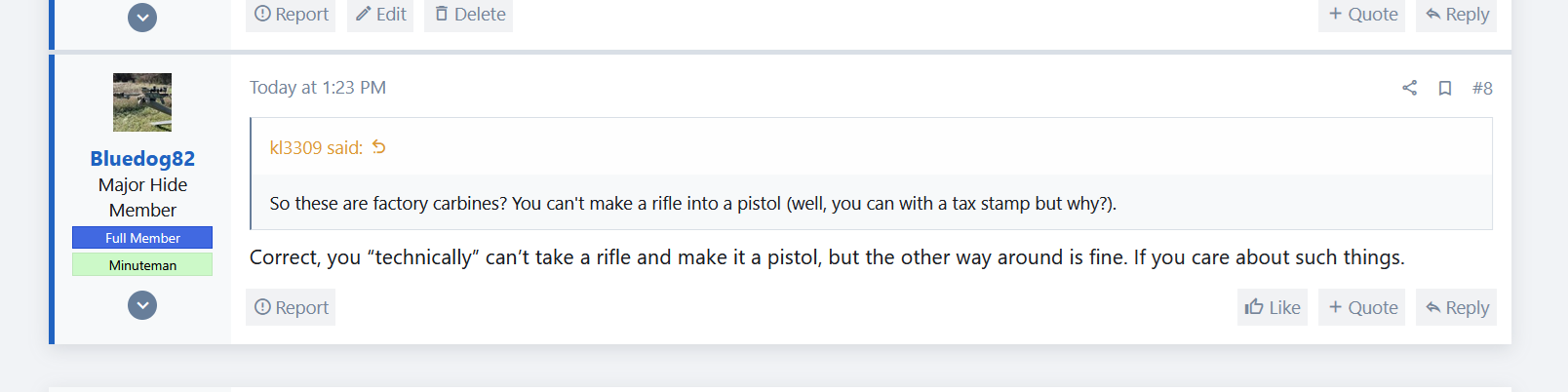

So these are factory carbines? You can't make a rifle into a pistol (well, you can with a tax stamp but why?).
Correct, you “technically” can’t take a rifle and make it a pistol, but the other way around is fine. If you care about such things.
