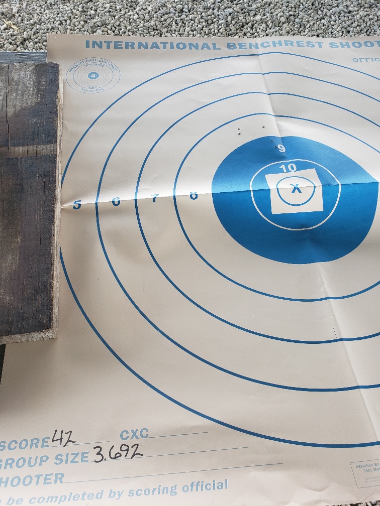

Berger 105s in a 6XC @ 1000 yds. I have a box of the coated 115 DTACs but didn't perform as well at the 105s in my rifle.
