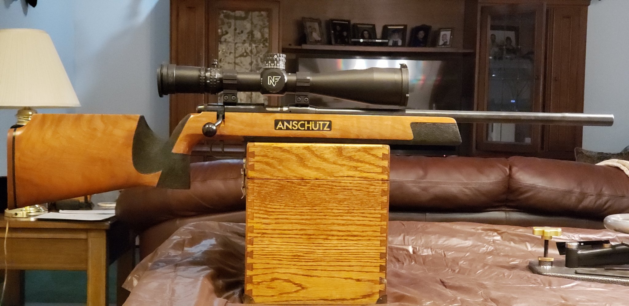

Look for old Accuracy International dovetail scope mounts. They are 11mm and come in various cants (0-18-45MOA) and Ring sizes (1', 30mm and 34mm). I use them on several of my 22's (Sako, Anshutz, etc). They are outstanding quality and a great value. You can find them here on the hide for good prices.

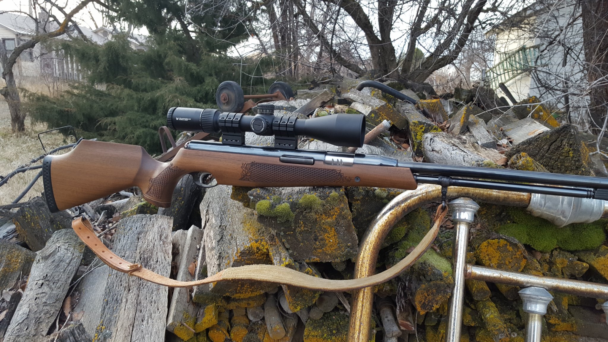

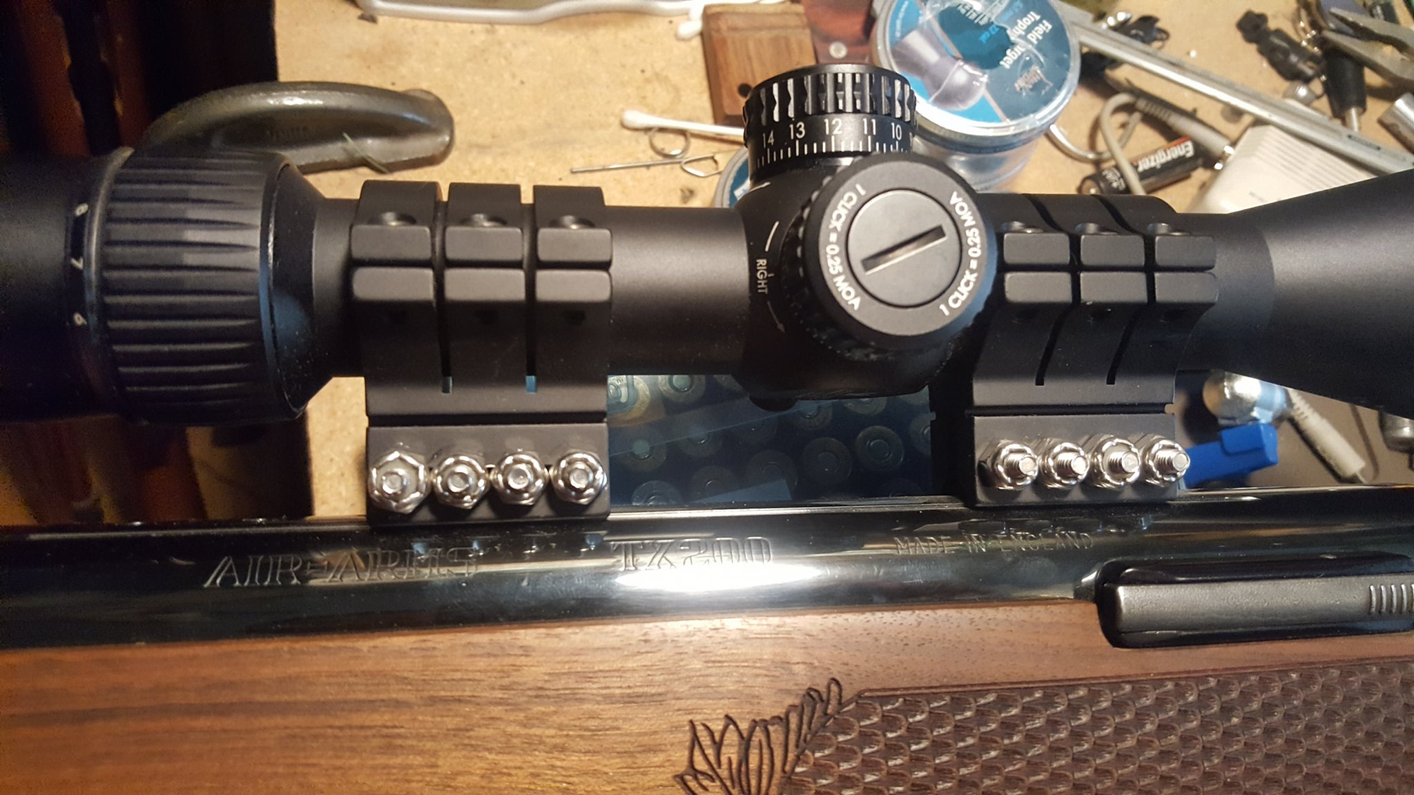

I am also going to vote BKL . Everyone knows that air rifles are very hard on scopes and rings. After a couple of rabbit holes I went with BKL.
I was heavy handed and stripped a couple threads. So I went over bore. I added stainless bolts and nylon nuts. This system hasn't moved any in years.

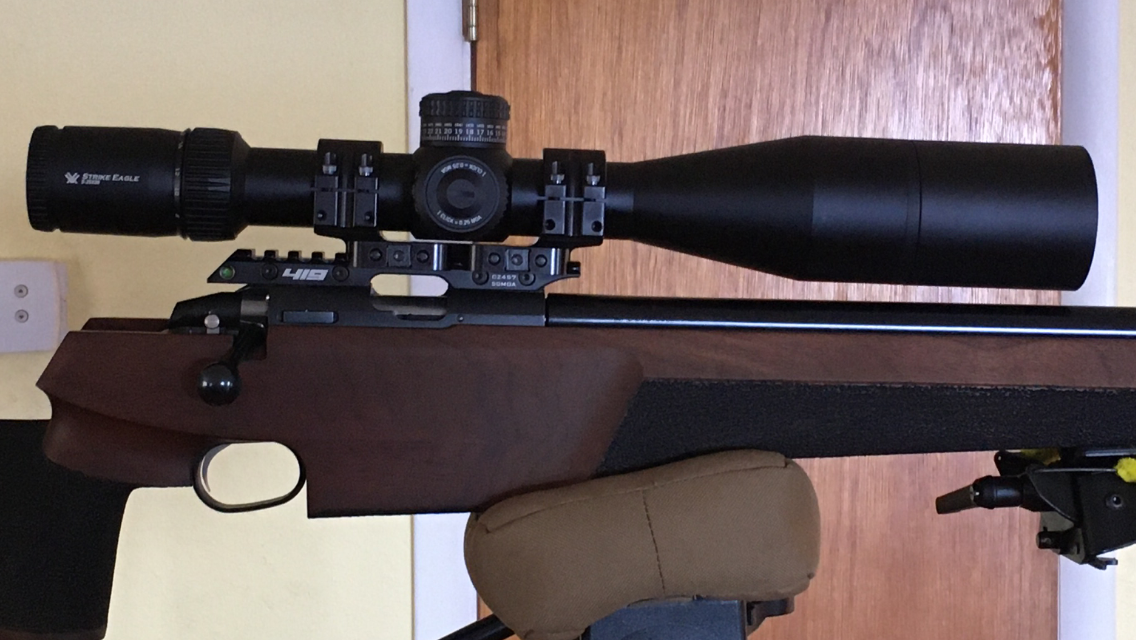

I would consider the offerings from Area 419. Though not intended for this rifle, their CZ 457 rail in 50MOA is a quality unit.
I believe they offer 20 and 30MOA as well.
