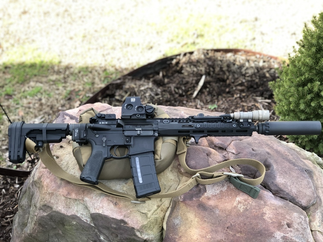

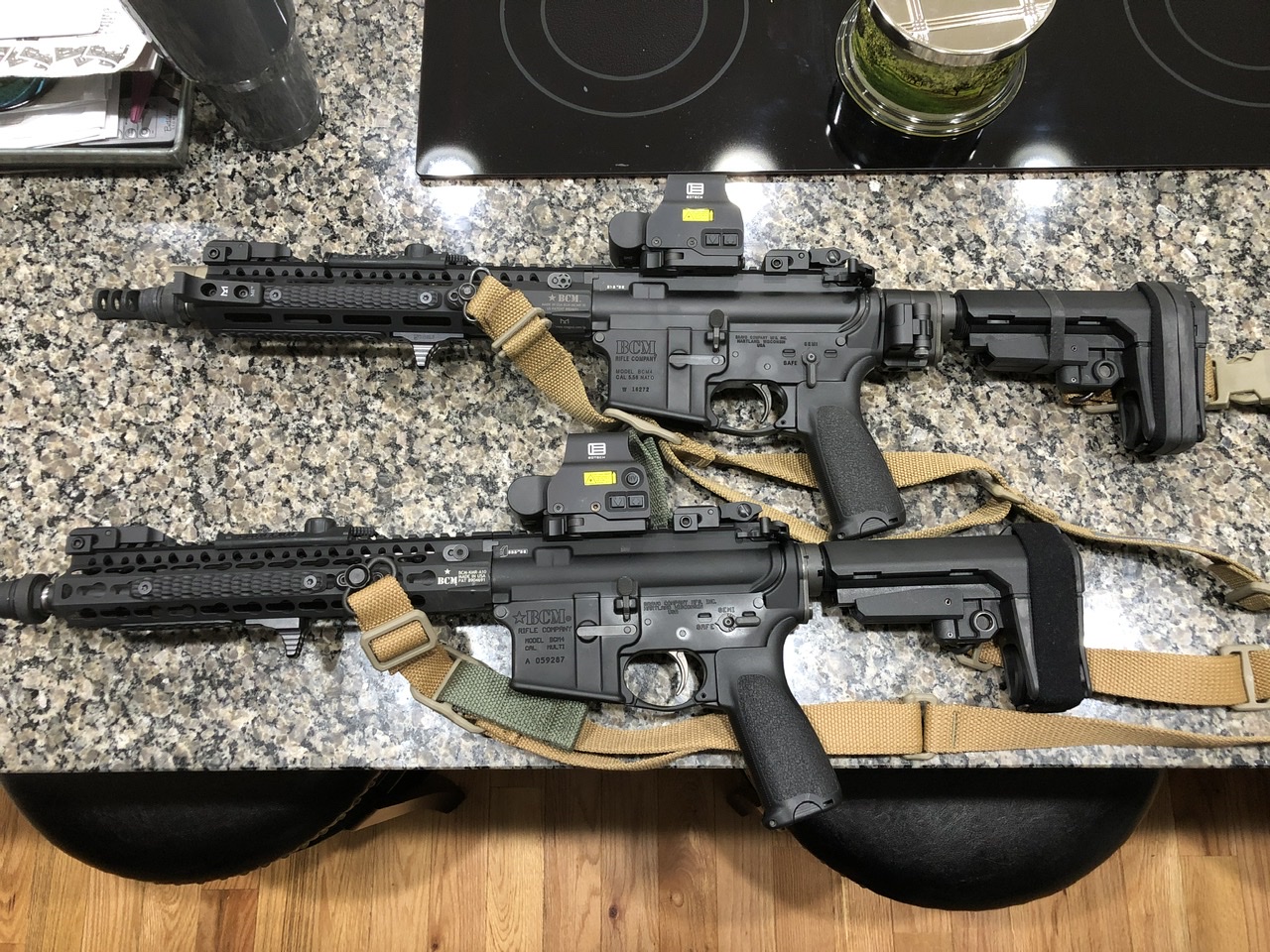

I just got 2 11.5” pistols to shoot suppressed. I ended up using BCM lowers and uppers for both that I pieced together here and there. I had overgassing issues and that took a little bit to get worked out. I ended up using the adjustable Bootleg BCG and also doing the RTV mod to the charging handle to tame the gas issue. I also went with a Blue Sprinco spring and an H3 buffer, which helped with the recoil and also the gas issue. Then, a buddy of mine let me try his Vltor A5A2 buffer system and I was blown away! You talk abt cutting the recoil in half or more, it worked fantastic. So I ordered an A5A3 VLtor buffer, AR10 spring(VLtor) and dark hour defense buffer tubes(longer rifle length). This made these pistols really soft and smooth shooting both suppressed and I suppressed. I also added Law tactical folders to both.
