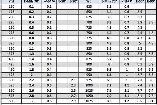

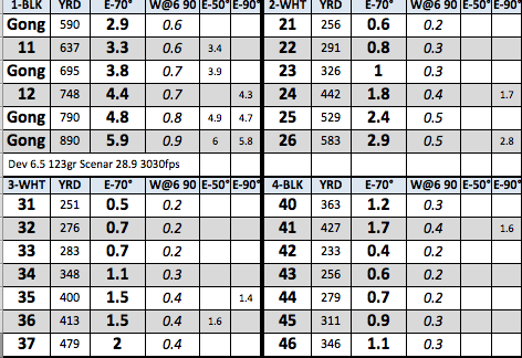

My 24” 6.5 it is a 6mph gun, runs 3030fps. Here is my sea leave dope, and a stage card example from the last match.
I can self-spot 100% of my shots. Now that said, is a 6br easier sure. Is a Dasher better? Sure, but I have consently getting over 2k out of my 6.5 and I am tired of barrels going at 1200 for an extra point or two in a match.
My 140s in the same gun at 1k, need 1mil more elevation and only provide .1 better @ FV base wind. Same wind at 600, with .5ms more drop and yes, the recoil is noticeably more with the 140s.

With the 140s, out of my 26 run hit it is close to yours at 2810, but out of my 24 to get good groups, I am only getting 2770. The drops and wind are at 29” mercury.
If I traveled let’s say to Wyoming on a really warm day my 123s, normally a 6mph gun, starts acting like an 8mph gun with the 1k drop of 6.5mils. The relationship between my loads stay the same.
