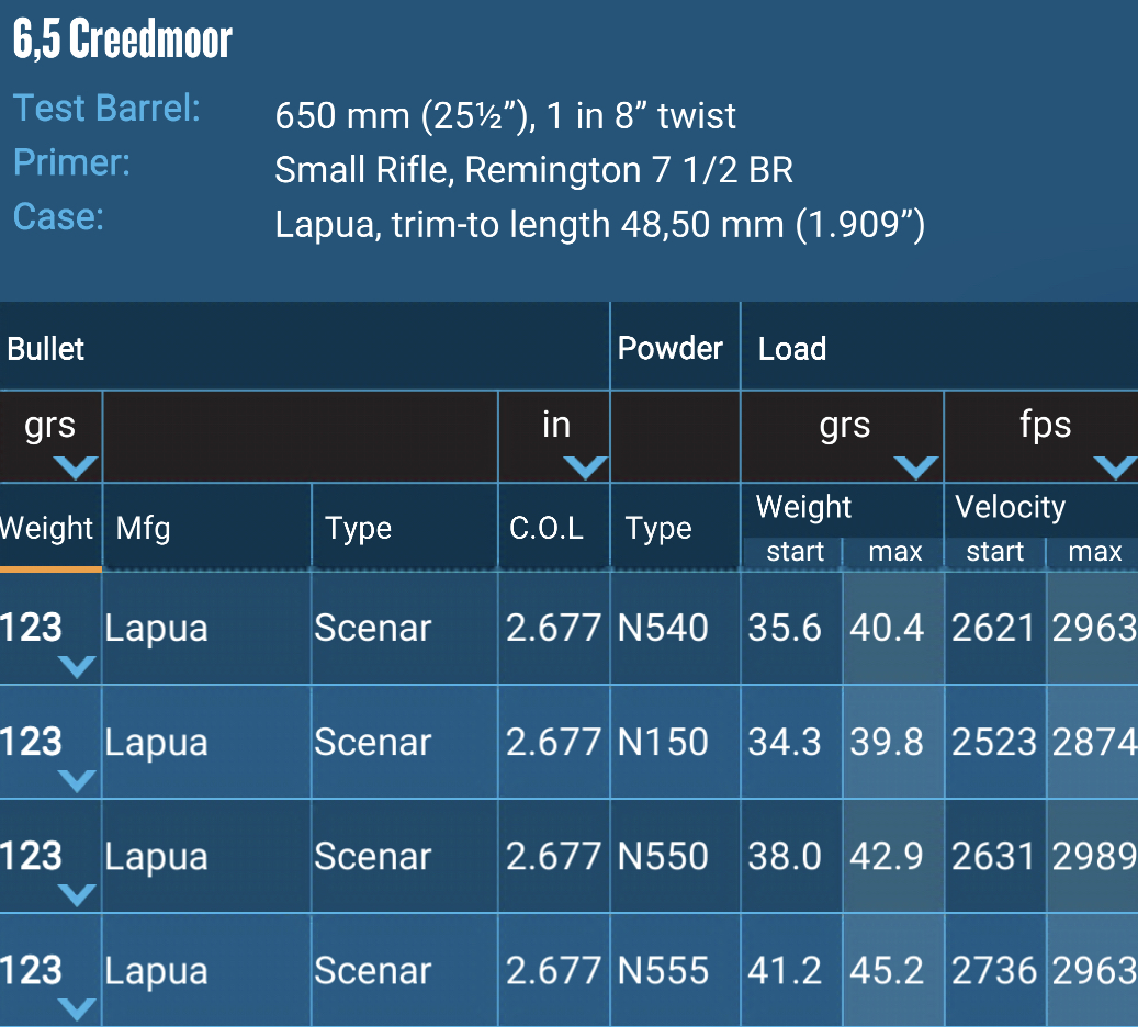

    I am looking to get some load data for the 123 scenar in 6.5CM. None of the books I have reference that specific bullet. I went off some other 123gr bullets as a reference and really didnt like the results I got.
    This is in a LMT MWS gasser. So if you have gas gun data with this bullet please share what you have.
    I have tons of different pow to choose from but like to use H4350 when possible. Other pows are, Varget, 6.5 Staybal, xbr8208, cfe223, AR comp, imr4350.
    Thank you for your time and thoughs.

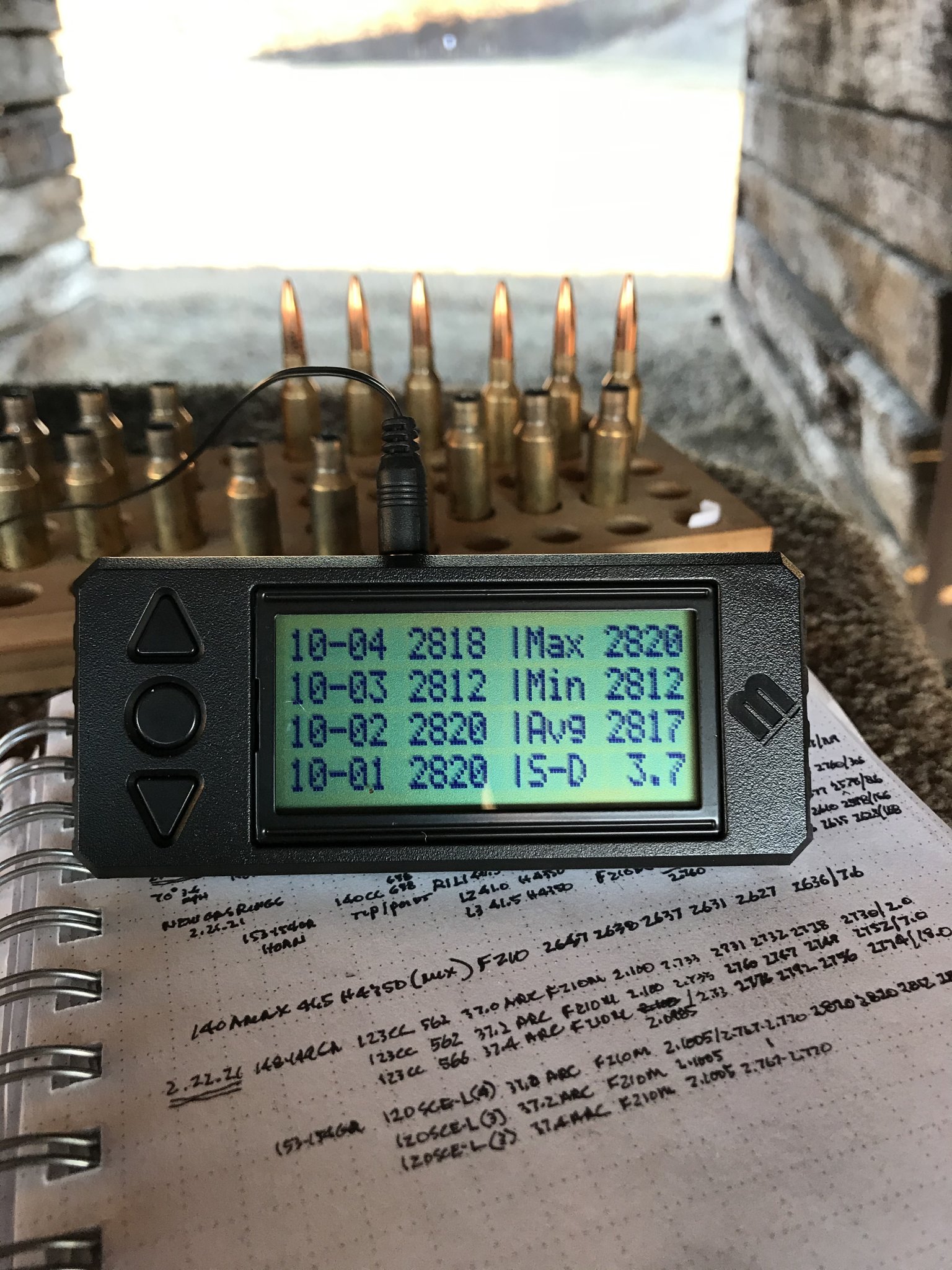

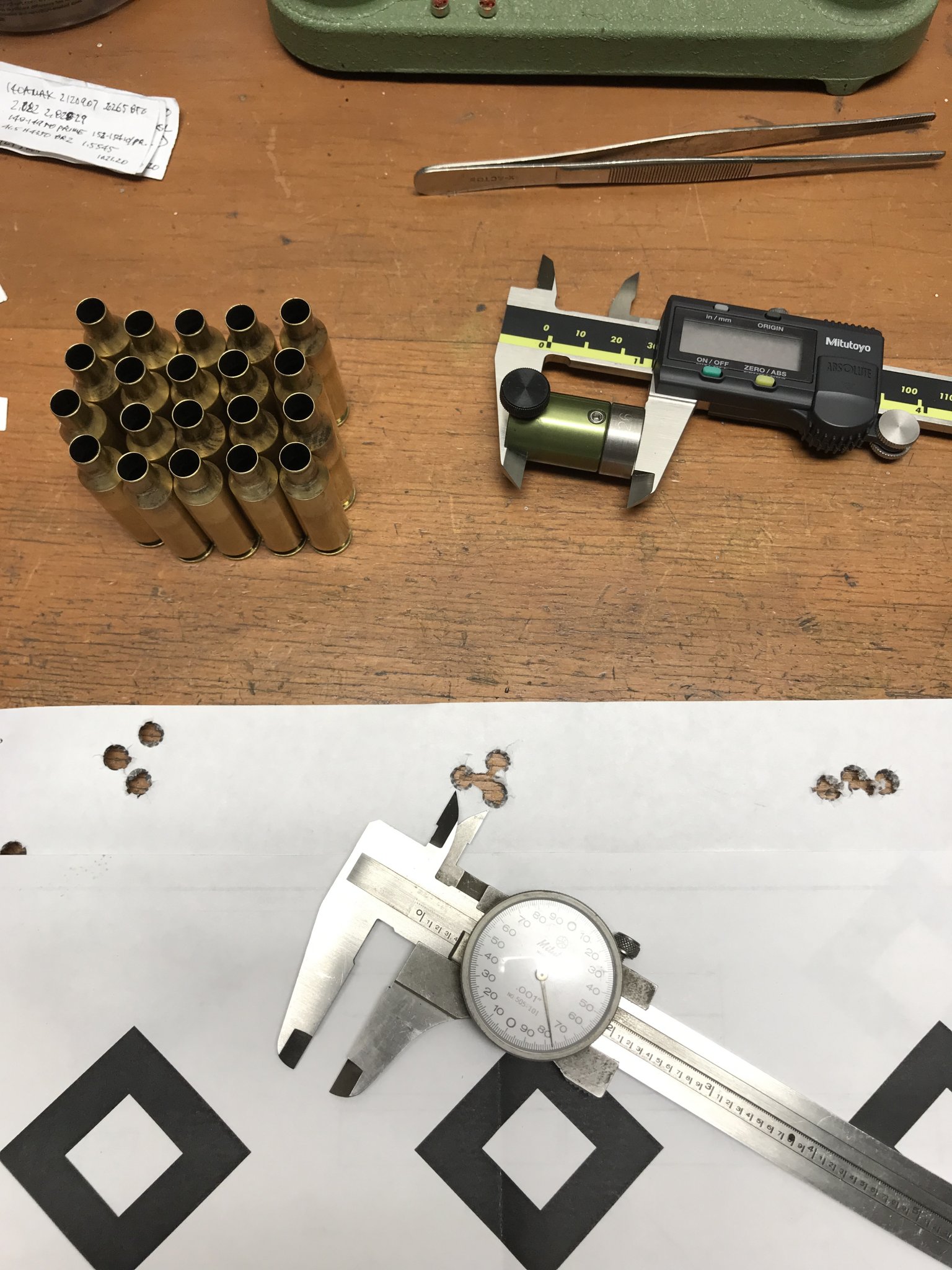

    Here’s a few with 120 Scenar-L and AR Comp. Three different charge weights, and a small sampling for certain, but also indicates what can be done with ARC and you want to work up loads in a ladder. 37.0 was good, but hard on primer pockets.
