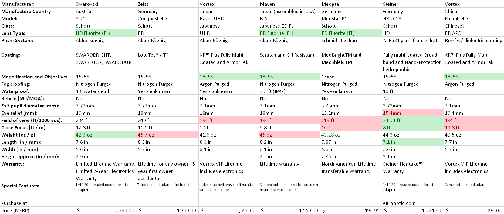

Here's a quick spec list I've put together
Edit: Updated the list to include the Meopta 15x56
I think your assessment on the Steiner is spot on Bill. From what little I have heard about the Steiners, they are an excellent bino. But they have very little presence.
They should be getting mentioned alongside the Leupold, the Meopta, and the Razors/Kaibab as a good less expensive bino alternative to the Swaros.
That's a great comparison, by the way. Thanks for sharing it.
