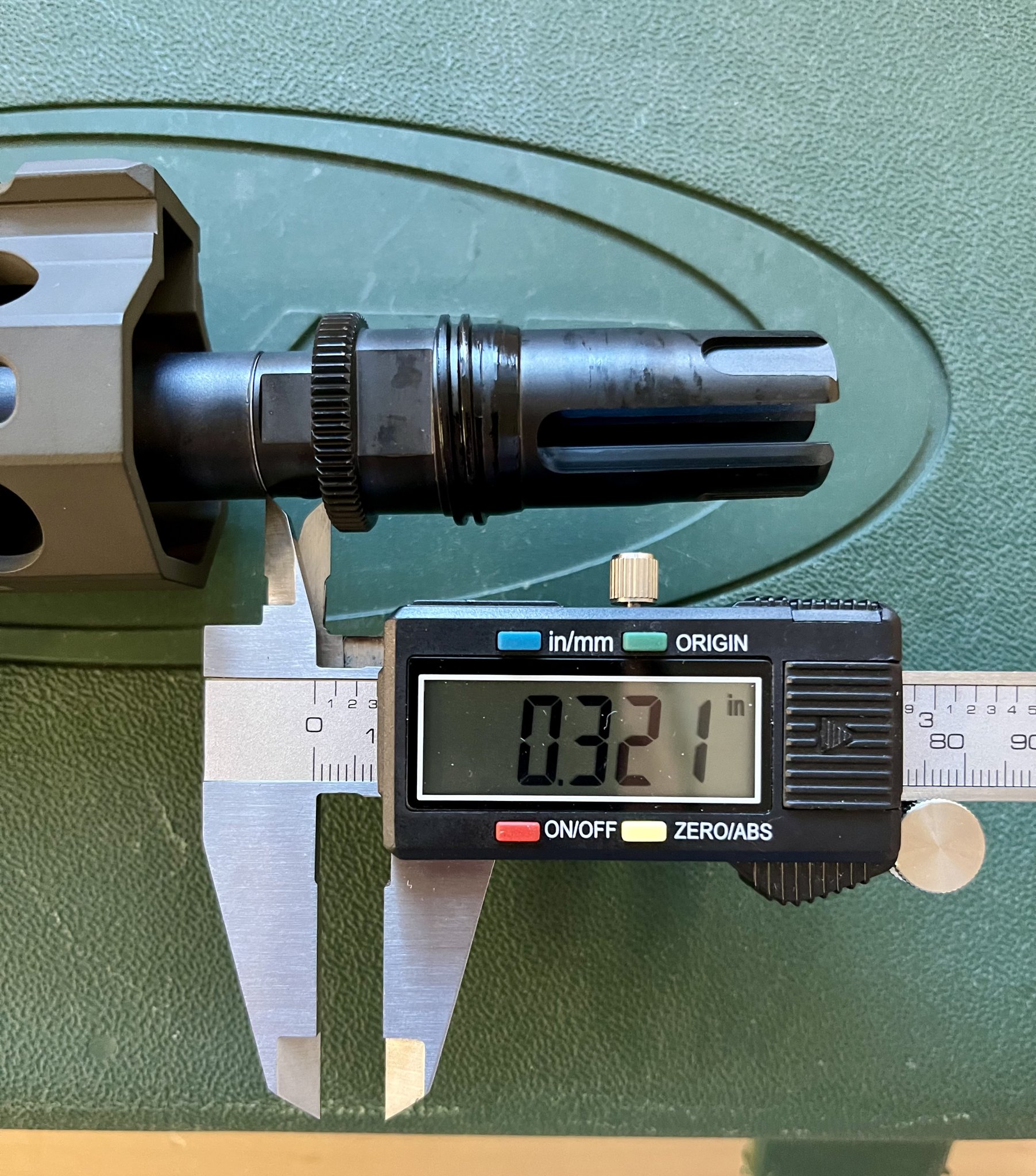

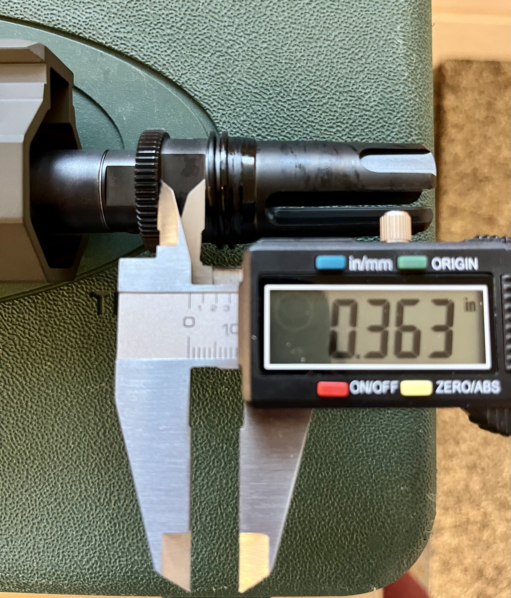

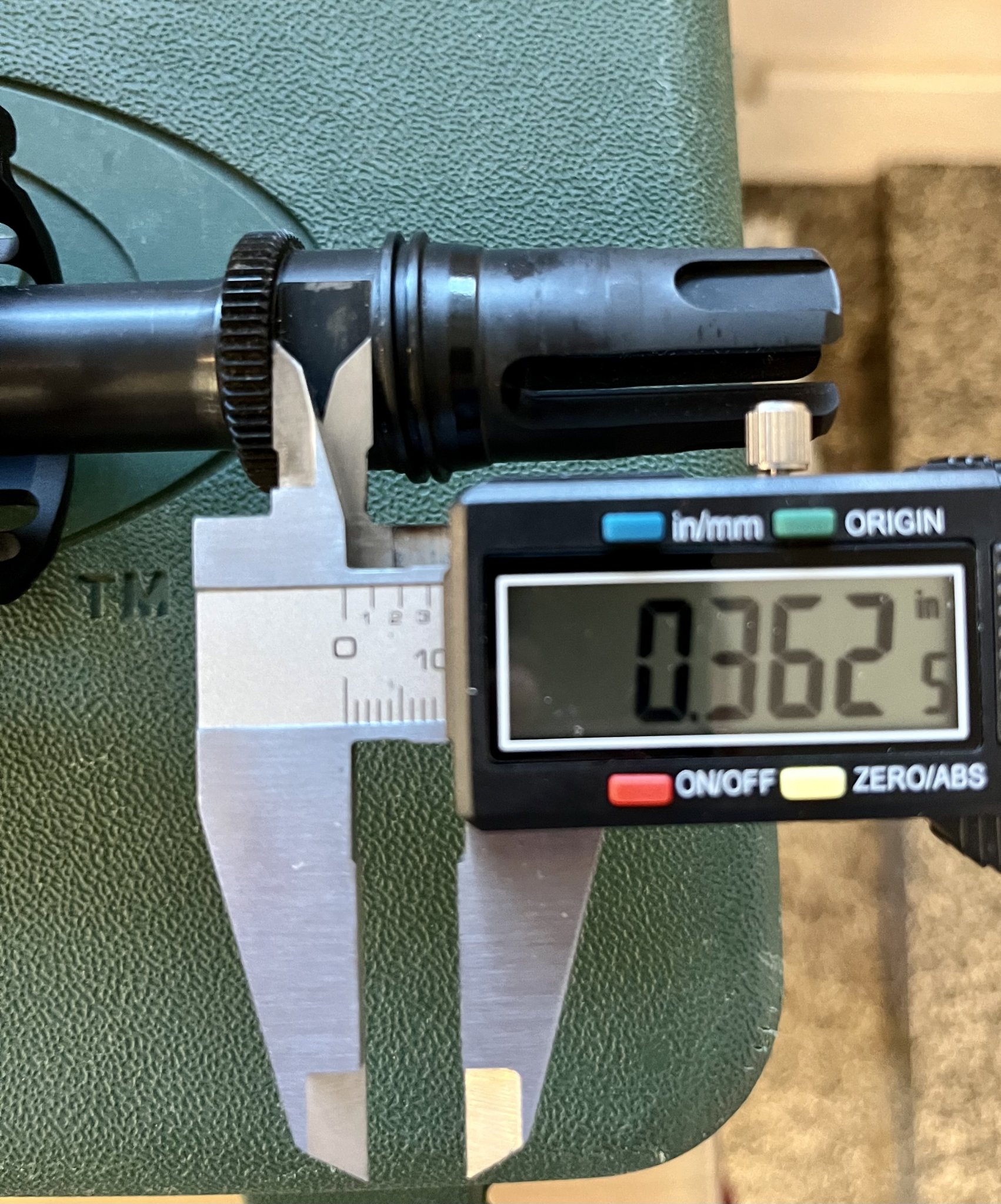

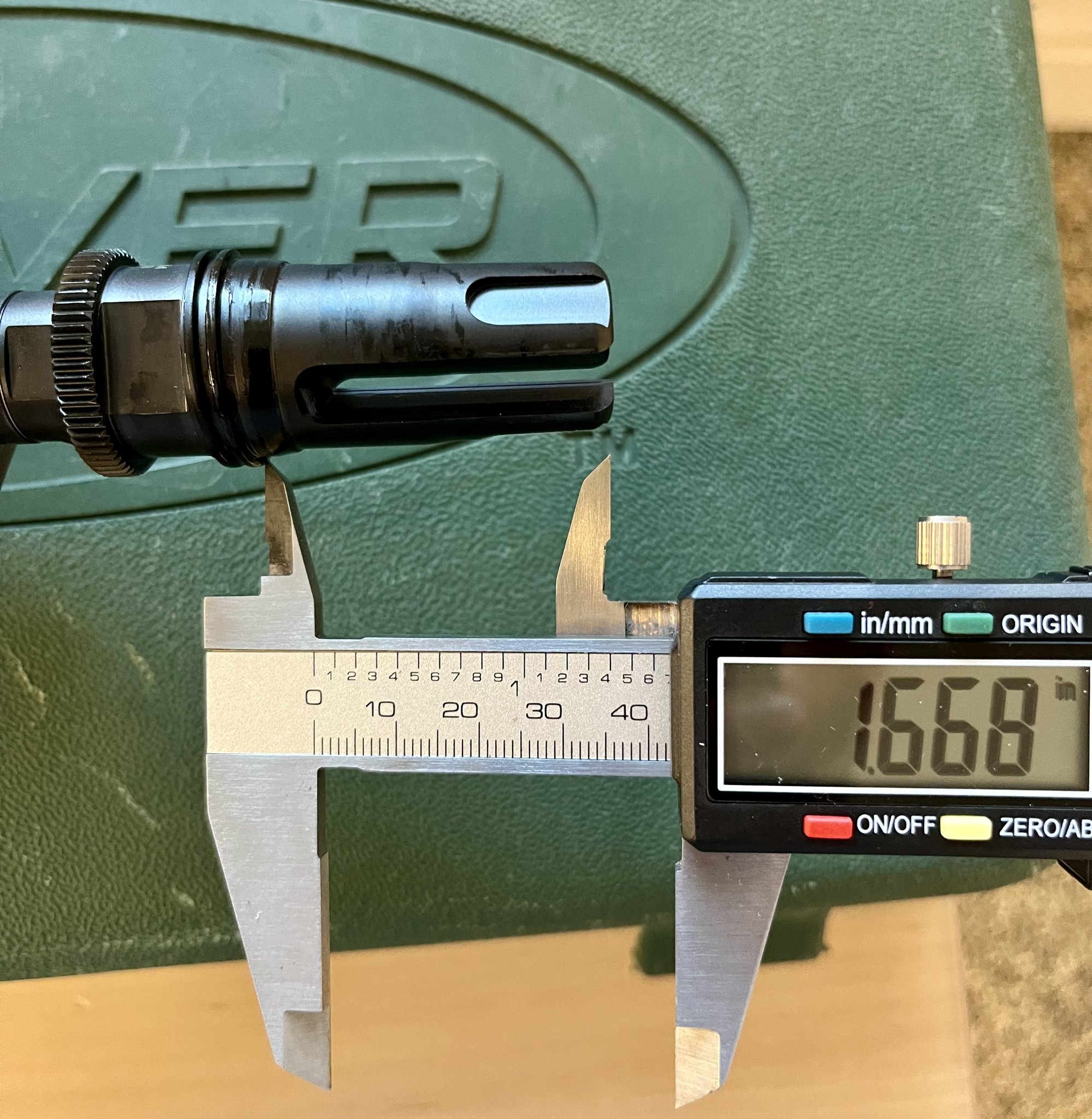

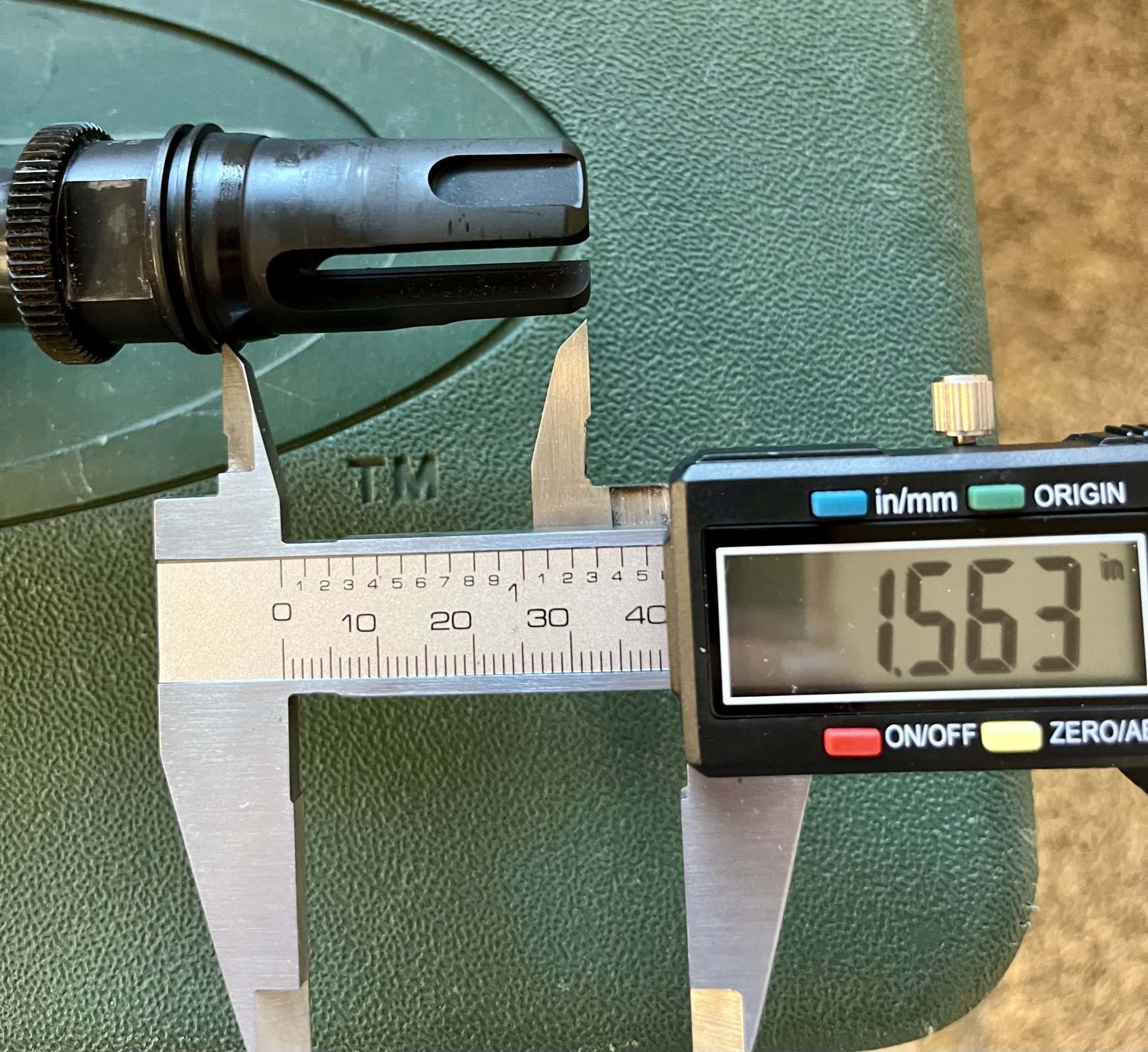

For OAL with a suppressor, your mounting system is going to matter. For instance, with Griffin Plan A, the muzzle device to take a 13.9 to 16” is longer than the device for a 14.5 in the “neck” area, not the mounting surface. What this means is that with an identical can attached to two rifles, one a 13.9 and one a 14.5, the OAL of the 13.9 with a can is only like .1” shorter than the 14.5. So in that situation, it doesn’t make a ton of sense.
This is such amazing information, how I never thought of it/noticed it before, I don't know. I've agonized over that length difference and I have both. My 13.9 has a Griffin FH 2.75 and the 14.5 has a Griffin Stealth FH, both p/w - top picture is the neck, there is some difference in tine length as well.
FH275
STEALTH FH
I hope this helps someone else!
Reactions: Bluedog82
