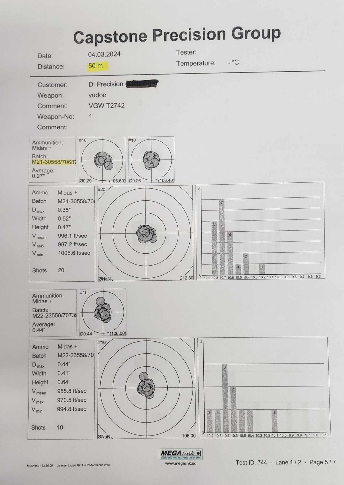

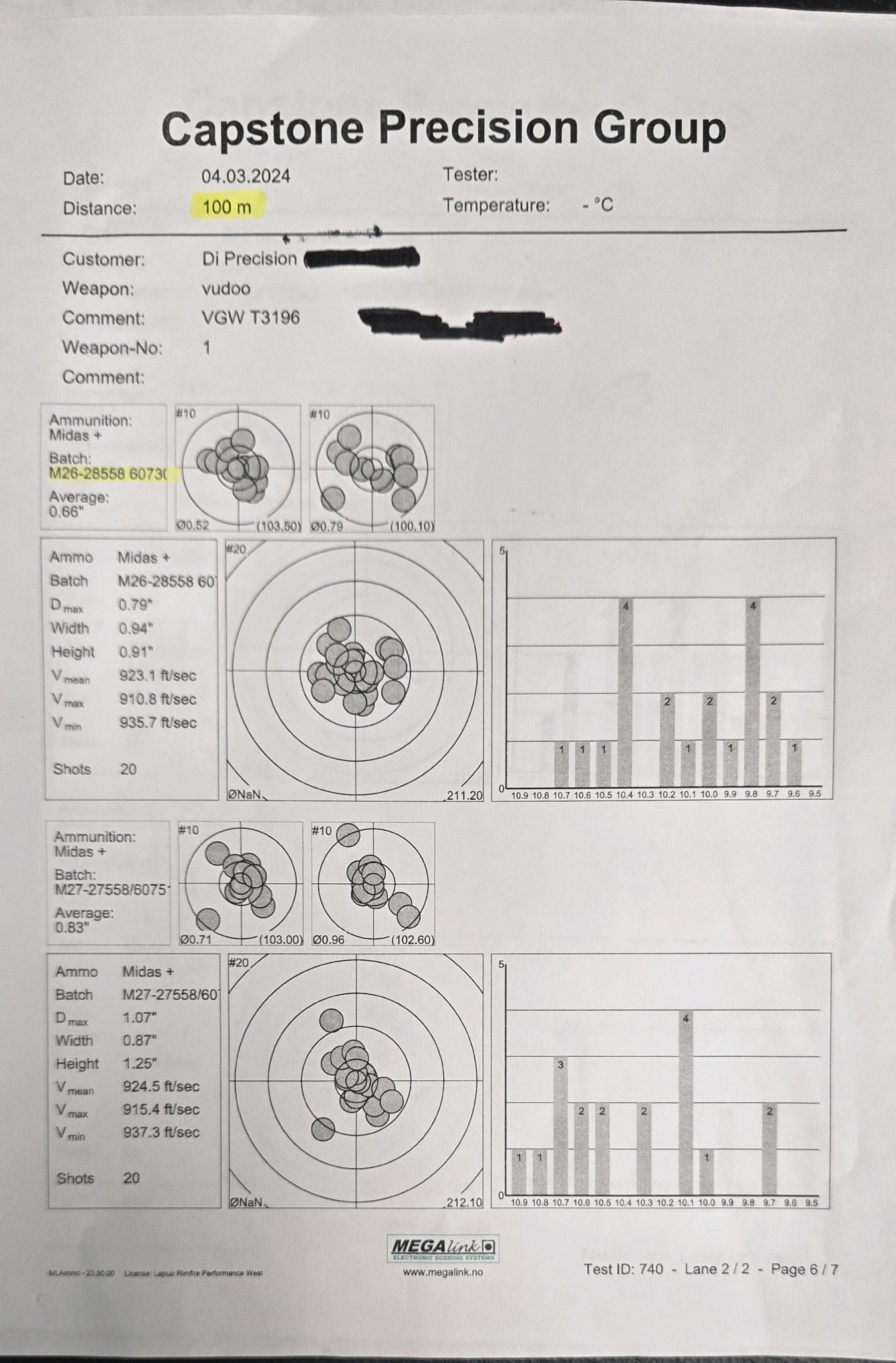

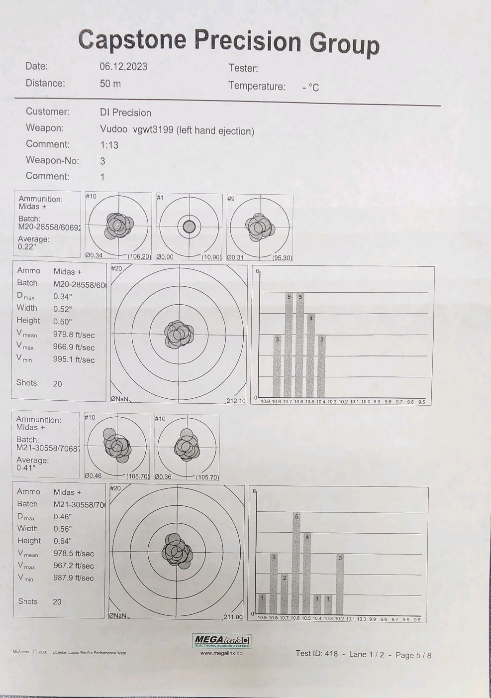

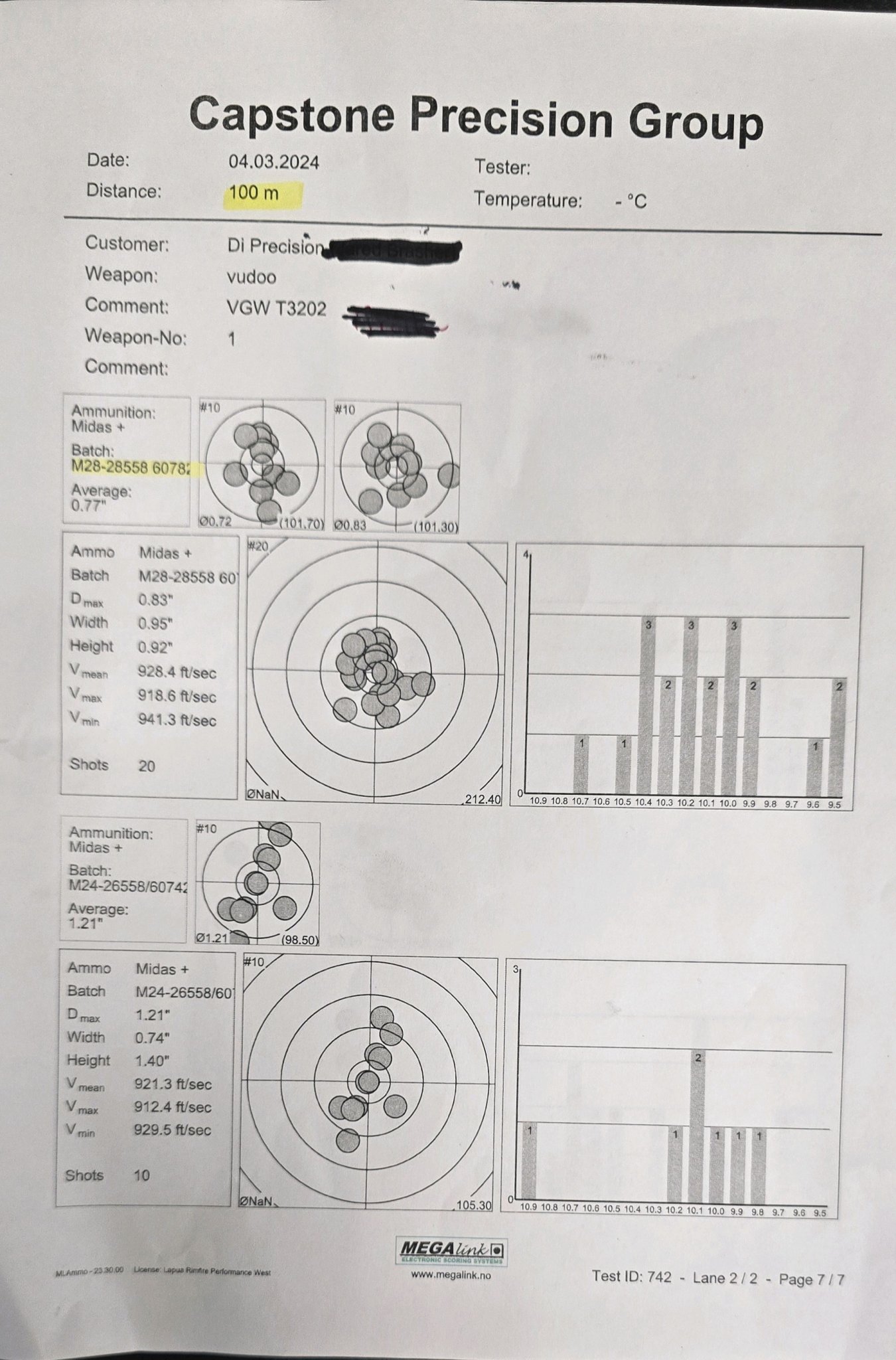

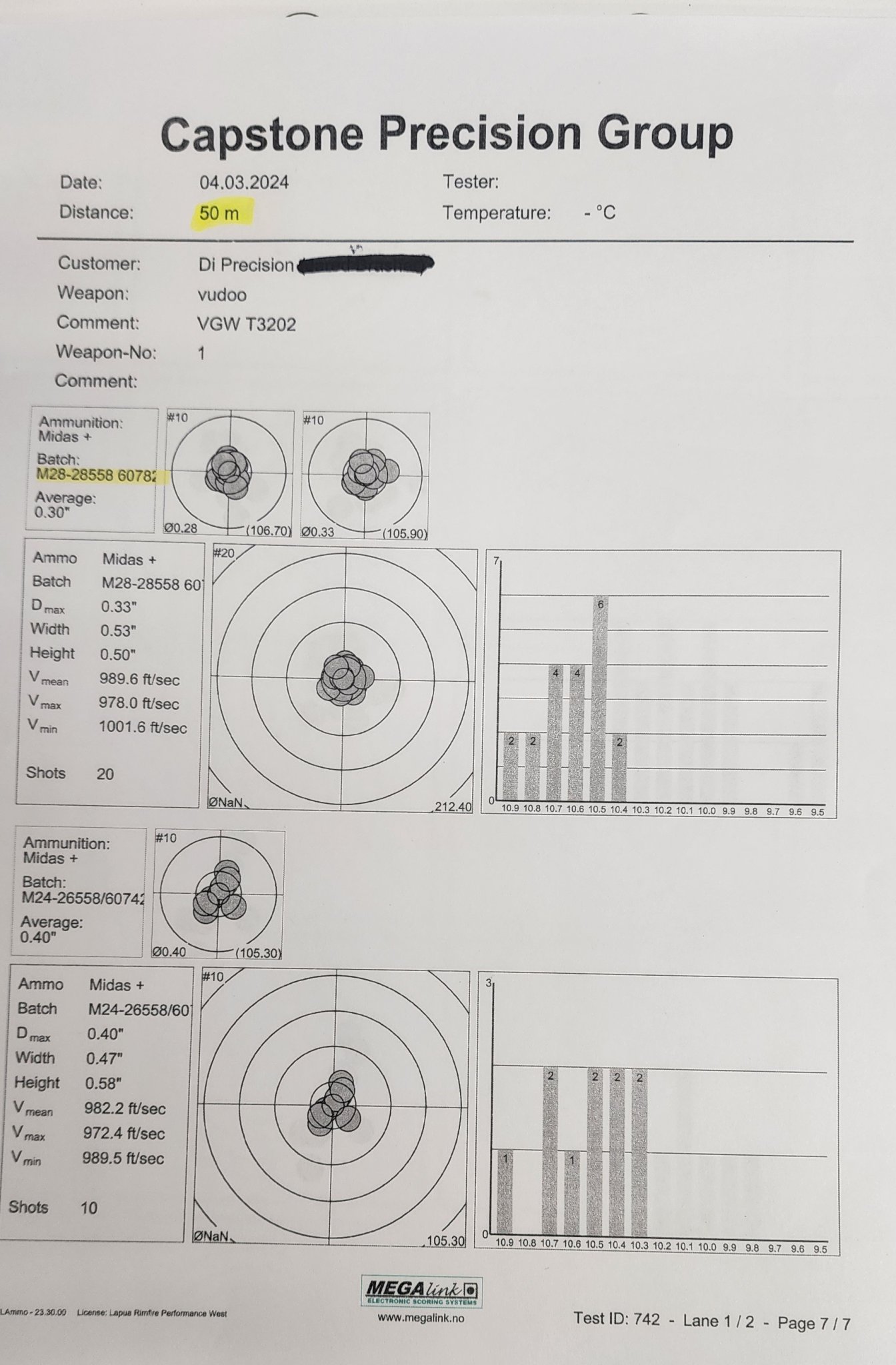

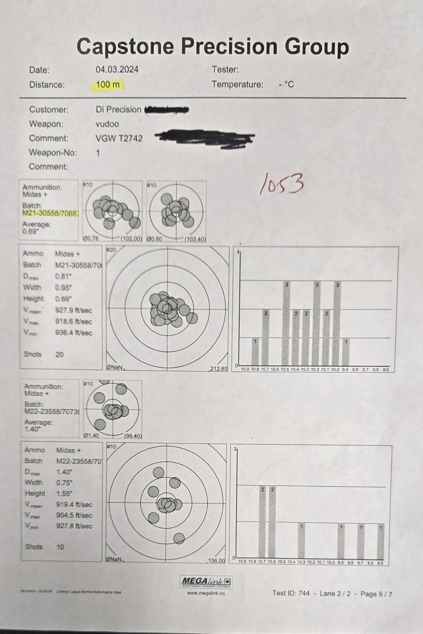

    I have been ask several times about the accuracy of faster twist barrels on rimfire, specifically if they are less accurate at 50 yards compared to a 16 twist. These were done a month apart then sent in to see how the process repeated.
    David. I have one of your recent builds with 25” 1.25 strait with no threads! It is a hammer at 50 out to 350. Have a lot of sk long range that it shoots extremely well. I think it is more about the chamber than the twist.
    Thanks, one thing we have noticed with the 13 twist and how we chamber is that they seem to shoot ANY quality match ammo very well.

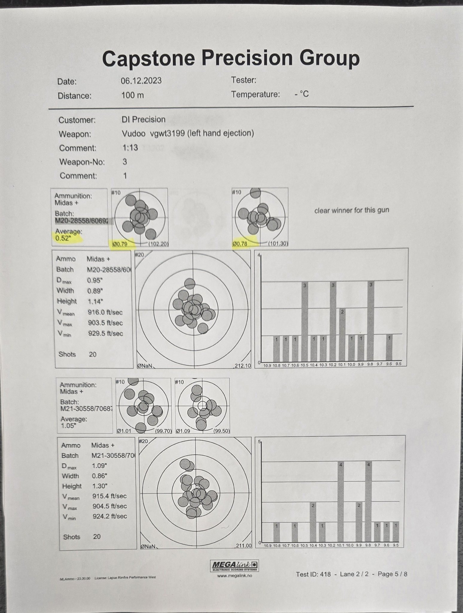

    In the last results target shown, it has the words "clear winner for this gun" printed beside two images of 100 meter results.
    The size of the ten shot group on the left is 0.79 (inches) and the size of the group on the right is 0.78.
    On the other targets the average of the two similar groups are calculated predictably. On this one the math appears to be off. It says the average of 0.79 and 0.78 is 0.52".

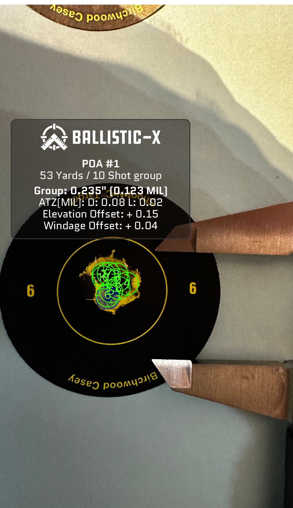

    David:
    Here are the result of DI Precision that I got from you on Thursday. The results of the 13 twist Mullerworks speak for themselves. This is shooting Lapua Center- X. Tomorrow I will take it out to 300 yards. Today was just set up, zero the scope and get 250 rounds down the barrel.

    David:
    That's awesome bud, it shot very well here with our test ammo.
