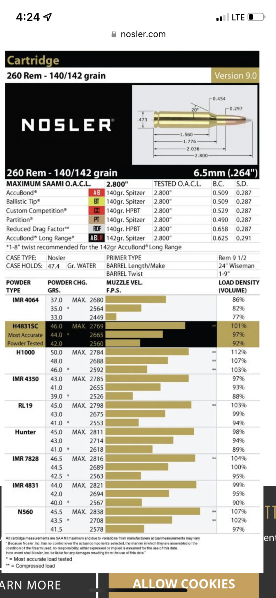

I’d like to work up a hunting load with the 142gr accubonds.
Anyone here have any experience they would share, thank you I appreciate it.
No experience with that particular 142, but it gets very good reviews from those that use it and it should load similar to the 142 SMK.
Here’s load data from Nosler:
