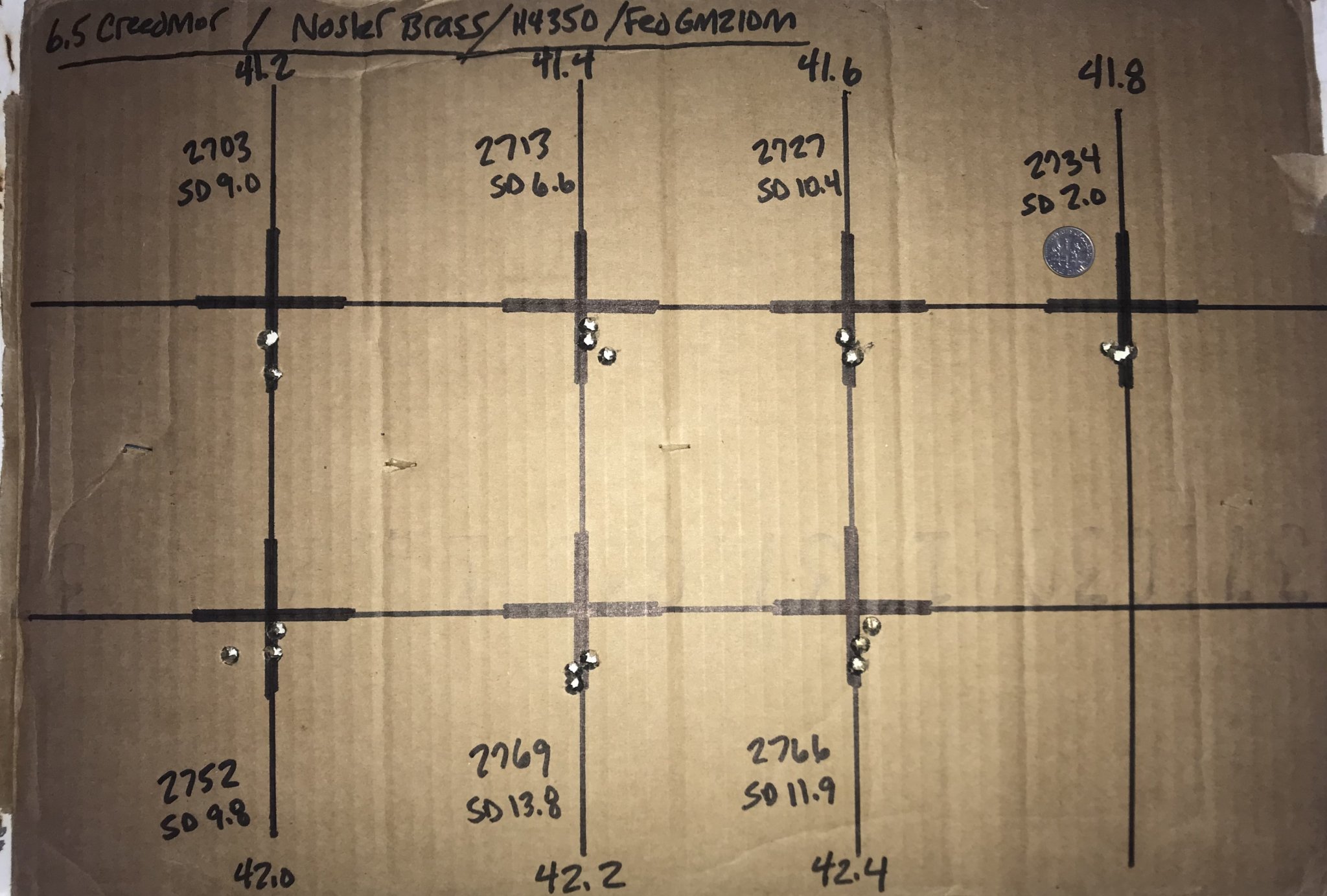

142gr SMK or 140gr Berger Hybrid...as alternative to 140gr ELDM 6.5cm

    Since Hornady bullets are practically non-existent in our galaxy...What are some considerations you all would call out between the 142gr SMK and 140gr Hybrids.
    I can go and buy either of these two tomorrow, but only in 500s. I am open just buying both and test loads for each, but would still like to get some first/second-hand feedback. Specifically, any wonkiness I need to consider in my AI/AT regarding Ogive/seating depth/OAL/jump, magazine fit...etc..
    6.5cm
    Hornady 1x brass
    CCI 200
    H4350
    I will continue searching the forums for baseline loads that others have concocted, just looking for feedback positive/negative/neutral on those two alternatives.

    And you think you can get Berger 140 Hybrids since you can't get ELD-Ms?
    Wow, the Berger bullets and ammo seem the most scarce things of all....maybe even worse that primers.
    Go with the 140hybrid if you can get your hands on them.
    They so far have been the most laid back easy to tune bullets i have tried in the 6.5CM and dont seem to care what the load or velocity is when i jump tjem .070".
    In the 6.5x47 i use 130hybrids and 6.5CM i run 140hybrid exclusively now.
    The only exception is i use 123CC for first firing on new brass.
    I cannot get from a retailer...also non-existent.
    A local range dude here is sympathetic to my plight and is letting me take (buy) his stock before listing it online. I guess with back and shoulder surgery lined up hes going to be down for a while.

    Havent looked again but Applied Ballistics had 500 count boxes of 140hybrid in stock last week.

    Berger over anything else
    I realize results may vary in different platforms, and everyone has different reloading practices, but sometimes a pic is worth a thousand words 😆.
    My gun is capable of 1/4” groups when the stars & moon align at the reloading bench, and I’m on my A-game behind the rifle, but normally on a good day, I can reasonably expect to see 1/2 to 3/4” groups at 100yds with a dialed in load; however, the Berger 135g Classic Hunters shot in the above OCW pic pretty much did that across 1.2 grains variation in Charge Weight! Needless to say, the Berger’s impressed the heck out of me.
    While these may’ve been the first Berger’s I ever tried, I can definitely say, they won’t be my last!
