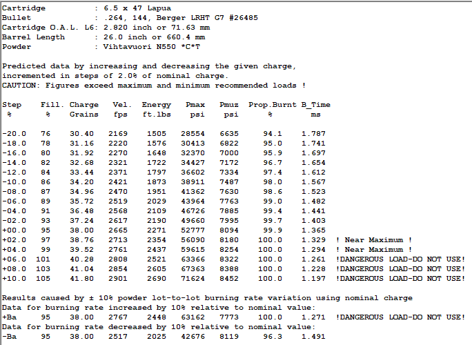

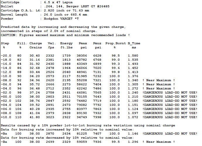

I did initially when I was down to a single one-pounder can of the Magic V. Switched to N550 and didn’t look back. Varget is a wee bit fast in this combo, much better with 120s. My initial testing with Varget and 144s gave me pressure signs a bit earlier than expected. H4350 would be a good match, but N550 combined with CCI 450s was the sweet spot for me.
For comparison...
N550 - my load is 38.4gr
H4350 - also good, perhaps a tad slow
Varget - now you're seeing pressure even earlier, barely into the 2600fps zone. So again, better suited to 120s
