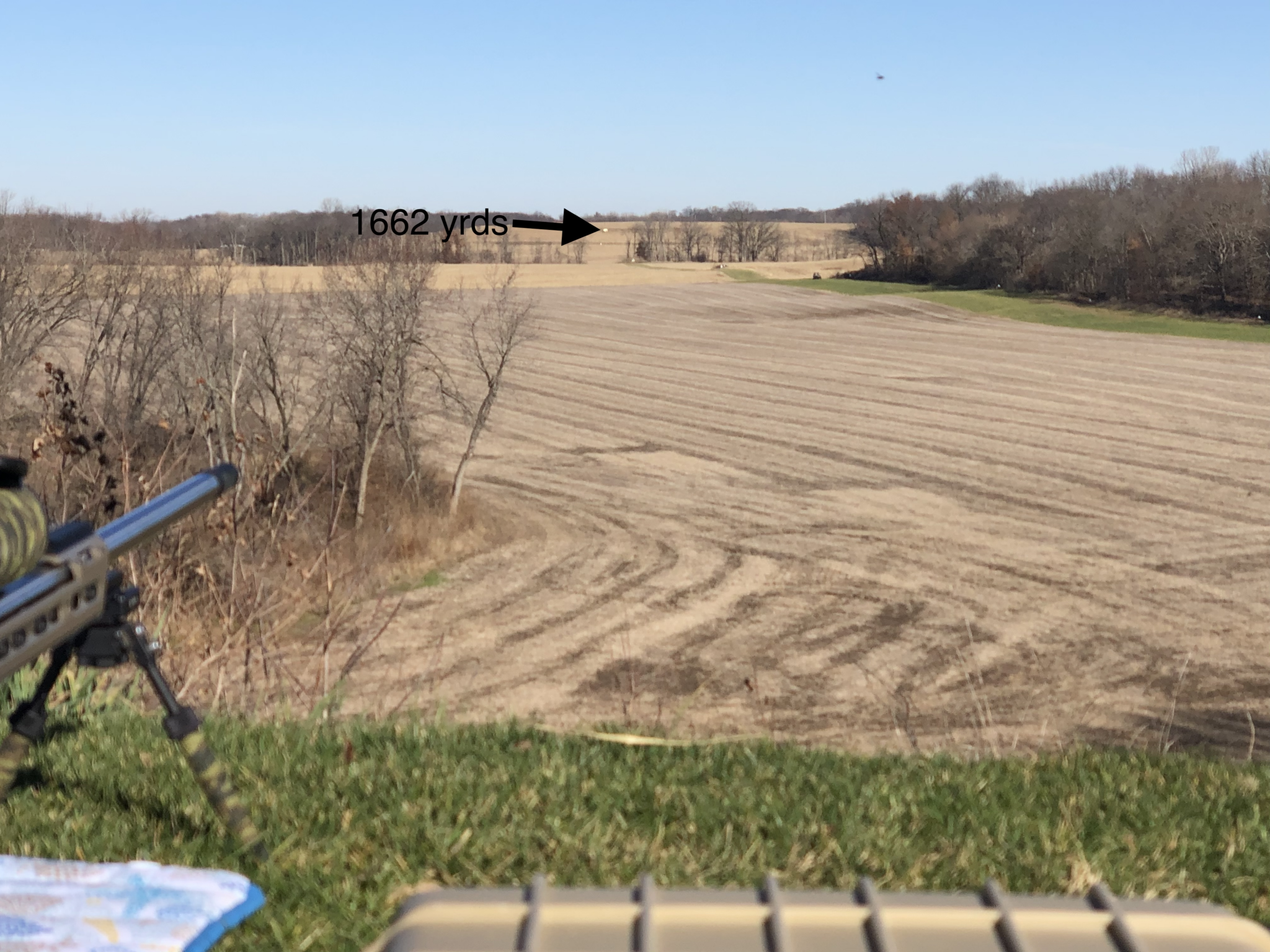

I was able to try my 147 load at this distance before burning out the barrel. The target is a big steel buffalo so it wasn't that hard to impact at all. The next closer target is 18x24 at 1570 yards and no trouble hitting that as well.

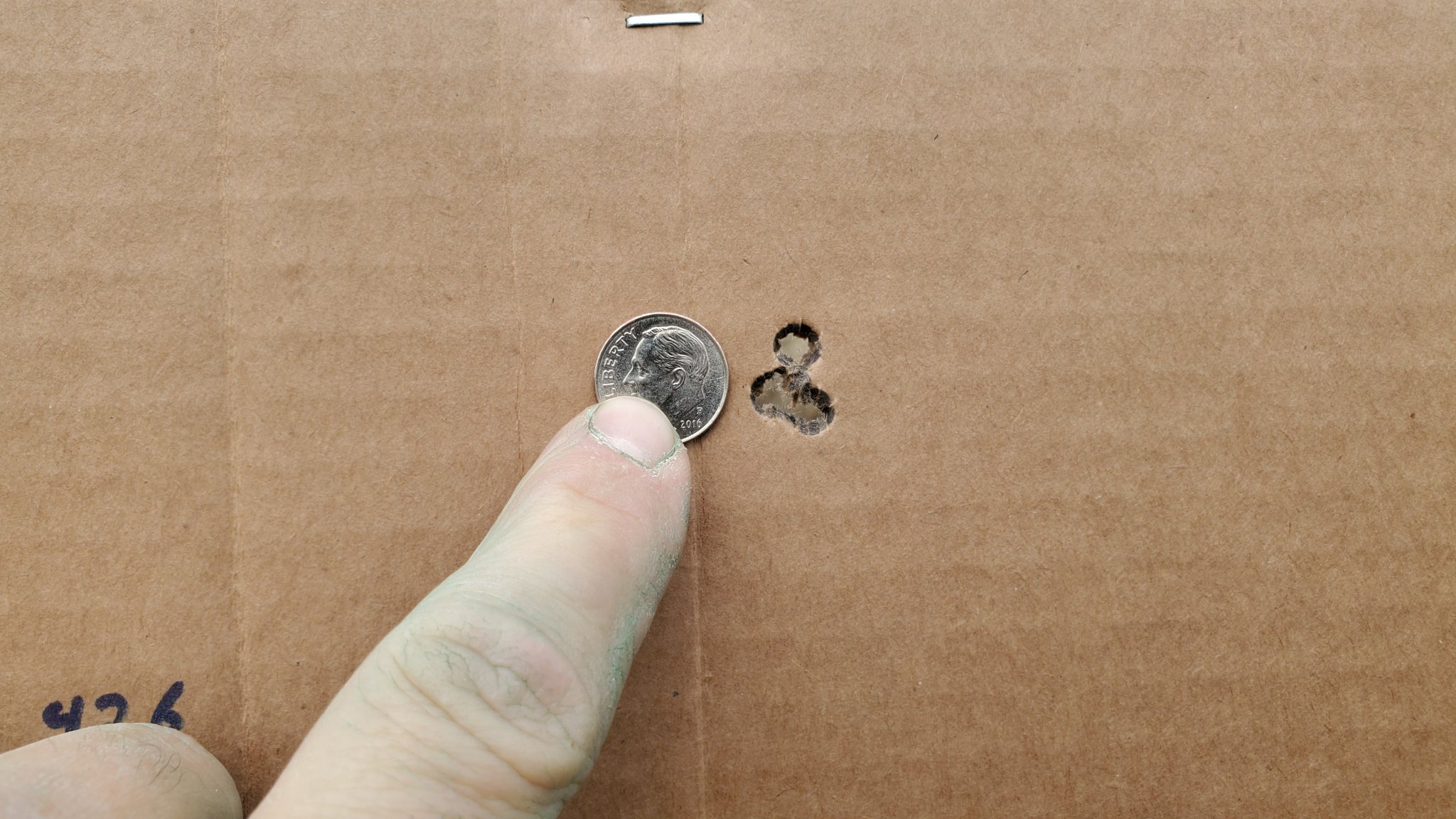

I run 147 in a 20" ai at 2685 with 42.1gr rl16, I used 43.3gr h4350 to get 2730 in that rifle. No issues well past 1k. H4350 got tight earlier in spring so I bought 16lb of rl16, seems to work as a good replacement in creedmoors

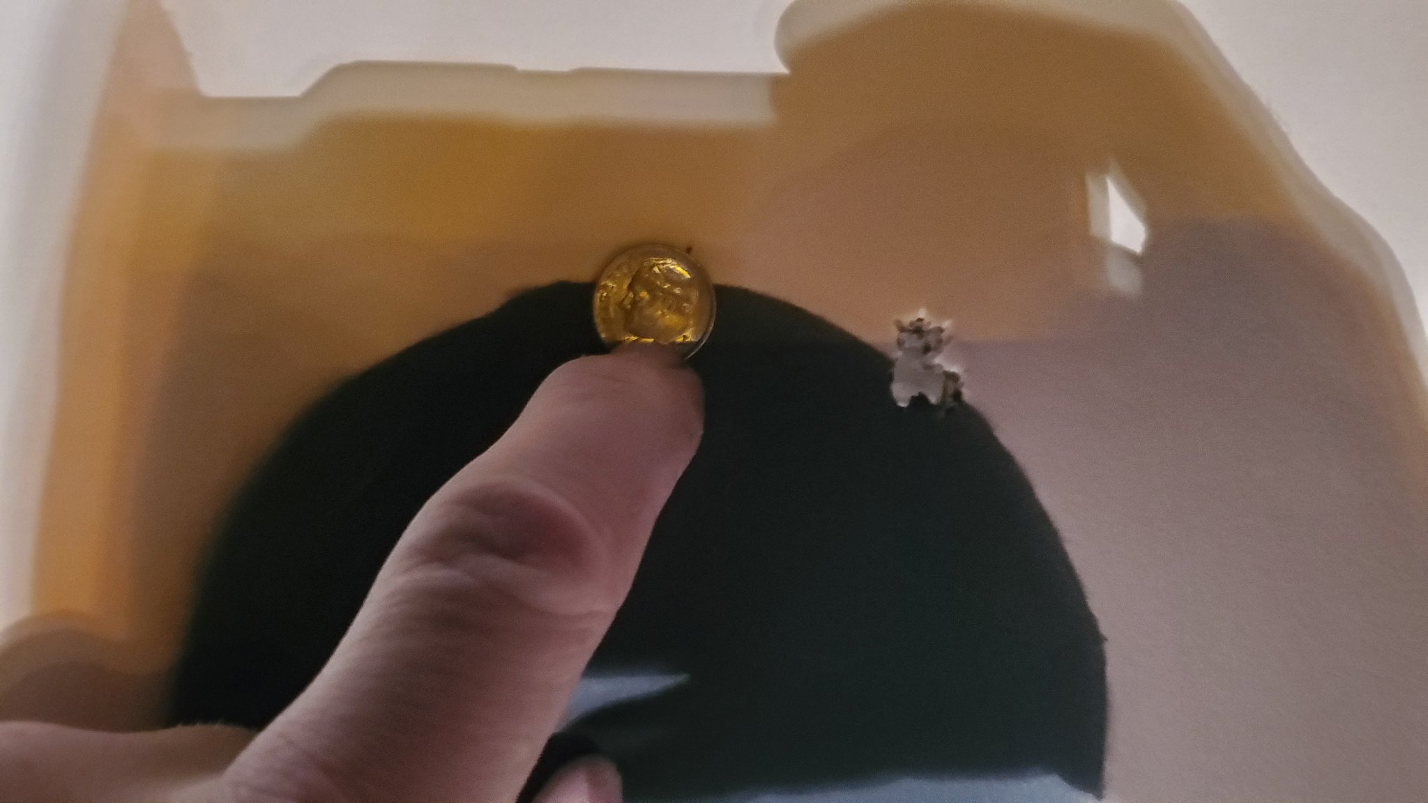

5rds of the rl16 load, lapua brass had 15x firings on it.
5rd at night, checking poi shift of pvs22
