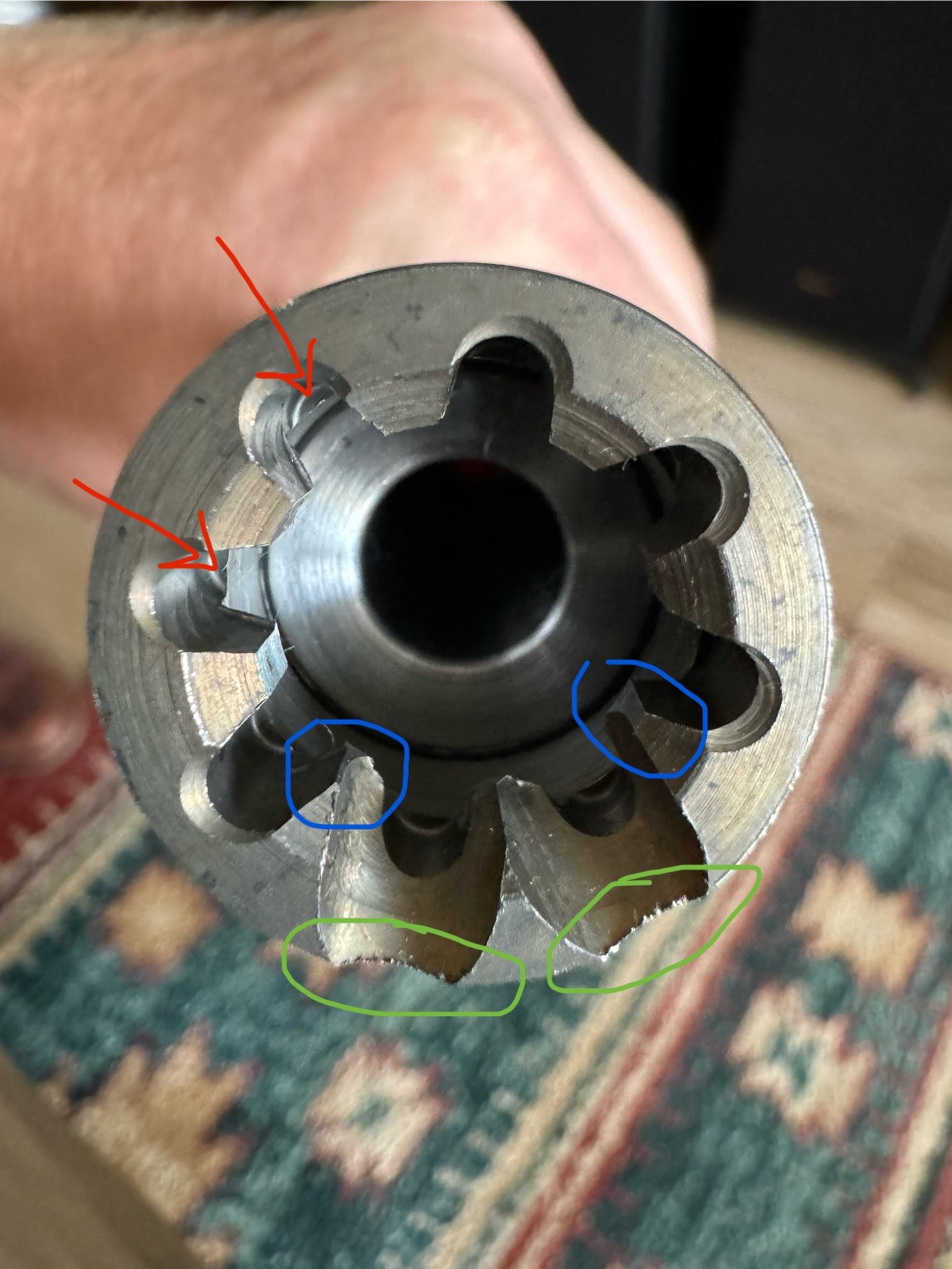

Working on a NSW Recce build and just got the barrel I ordered from Lilja. I ordered their 15.1" M4 Recce profile barrel in .223 Wylde. Shipping was lightning fast but king of disappointed when I opened the package. The barrel itself looks to be very nice but the M4 extension is one of the roughest I've ever seen.
- The M4 feed ramps aren’t centered (see the blue circles on the pic)
- There is material behind the lugs still (see red arrows)
- The chamfer around the lugs is off center
- Generally poor machining, seems unfinished, especially around the feed ramps. (see the green circles)
I reached out to Lilja and they pretty much acknowledged the problems and said that they switched to new style of machining this spring and that I had one of the old M4 extensions. They said go ahead and install it and see if you have any issues...that just doesn't sit well with me. For a $575 barrel, one should expect better. I asked to return the barrel and have a newer M4 extension installed on it, still waiting to hear back.
Has anyone else had any issues with Lilja barrels, specifically the M4 extension? If they are unwilling to resolve the issue, I will be looking into other options. Any recommendations out there? I know Craddock has a few options and a great reputation.

Yeah that looks like shit

As stated above, they told him to install it and run it. The question I have for you, would you invest your time and expense to complete that build and test it based on the pictures of that barrel extension? Would you have concerns about any long term issues that may arise in the future?

Of course, and this was not intended to be a Lilja blasting thread. If they make it right, I will certainly let y'all know. And yes, even the best companies put out stinkers from time to time. It's what they do to make it right that sets the the professionals apart.
My last email from them stated that they don't see anything that would cause any issues and that I should go ahead and run it.

I never saw an extension look like that. They were all some of the best extensions I’ve ever seen, maybe BAT Machine.
That extension looks like it didn’t make it to the tumble-polish process, which is what a lot of upper-brow barrel makers have been doing. That should never have left their internal QC before even getting to shipping, and is not consistent with anything I’ve ever seen from the company.

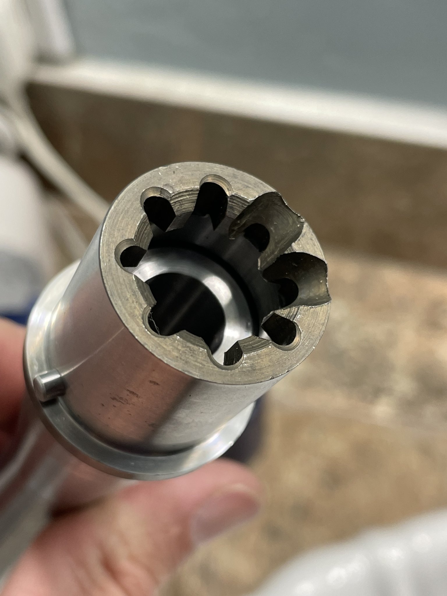

I recently bought a Lilja 16" 6.5 Grendel barrel with the same extension you are showing. It was through Six Sigma who had ordered a bunch of shorter than normal Grendel barrels from Lilja. I do metal finishing and was able to clean it up pretty decently but It was a far cry from the quality I expected from Lilja. The barrel has been a huge disappointment. Showed some promise with the first few groups but just gets worse. About 300 rounds in now and nothing groups under 3". I've tried everything I can think of but I'll go start a separate thread about that.

I recently bought a Lilja 16" 6.5 Grendel barrel with the same extension you are showing. It was through Six Sigma who had ordered a bunch of shorter than normal Grendel barrels from Lilja. I do metal finishing and was able to clean it up pretty decently but It was a far cry from the quality I expected from Lilja. The barrel has been a huge disappointment. Showed some promise with the first few groups but just gets worse. About 300 rounds in now and nothing groups under 3". I've tried everything I can think of but I'll go start a separate thread about that.View attachment 8532178

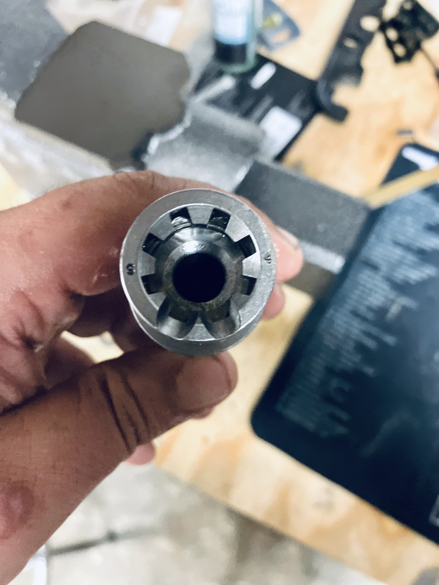

I've never seen a barrel extension like that.
They are usually broached with square corners, not rounded with a end mill, which looks like they are roughed out and forgot to broach them square.
If the round corners are deep enough to clear the square corners of the bolt...it would work, if deburred....
But I would not accept this unfinished barrel extension, you paid for precision, and got junk. Return immediately.
I just checked Lilja's site,.. they CNC mill the barrel extensions, no broaching, unlike everyone else who sells barrel extensions on the site that sells various brands...I'd prefer the broached extension, slightly more strength and it fits all installation tools, when torqued down.
But Lilja has the pictured one finished well, no heavy burrs, champhered, with nice finish...Unlike yours.
