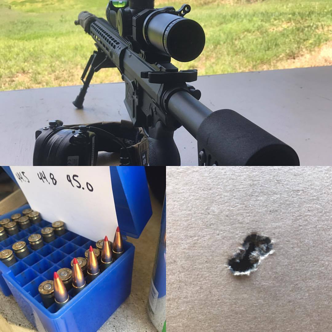

Decided to pull out my 308 gas gun and get some more time behind it. I put it together in 2017 and have not shot it much. Specs Below. Initially I ended up shooting 155 ELD-Ms over RE-15. My supply of RE-15 is gone now and I haven't be able to resupply. That said I have Varget and 8208 on had as well as a small amount of TAC. What powders do you all typically run in your gassers for best performance?
Current Load ( This netted a MV of 2740fps which I was pleased with)
  • 155 ELD-Ms
  • 44.8gn RE-15
  • CCI BR2s

Rifle with previous typical 5 shot group. I can tell I need to work on recoil management with this more. Been shooting a lot of Dasher and 223. I loaded up a test batch of Varget from 44 to 46gn and nothing shot extremely well. Some of that could be me, but most were pushing 1 to 1.25 inches.

i think imr4064 is pretty solid for 168 and 175gr pills. That being said, if i was you based off of that group.... id try to find some more RE-15.
Is that one of their steel barrels or their carbon barrels? Also did you do anything besides plug and play with this barrel? Outstanding group
Reactions: simonp
I have shot a bunch of Accurate 4064, H4895, and IMR 4064 in mine under 155-168 gr bullets. All seemed to work similarly well.
I have also tried some 8208 XBR- but advance cautiously near max load as I have found this powder to be "peaky." I would personally try this one first.
Even though RL-15 is temp sensitive, I have also gotten great results from it and too bad it is so hard to find!
It is a steel Proof. Just plug and play and verified it was good with a no-go and go gauge.
I have seen the same thing with 8208 in bolt guns spiking pressure up quickly. To avoid brass getting chewed up I try to stay off the top end if I can find something that will shoot lower.
Note edited: I try to avoid max loads on gas guns.
