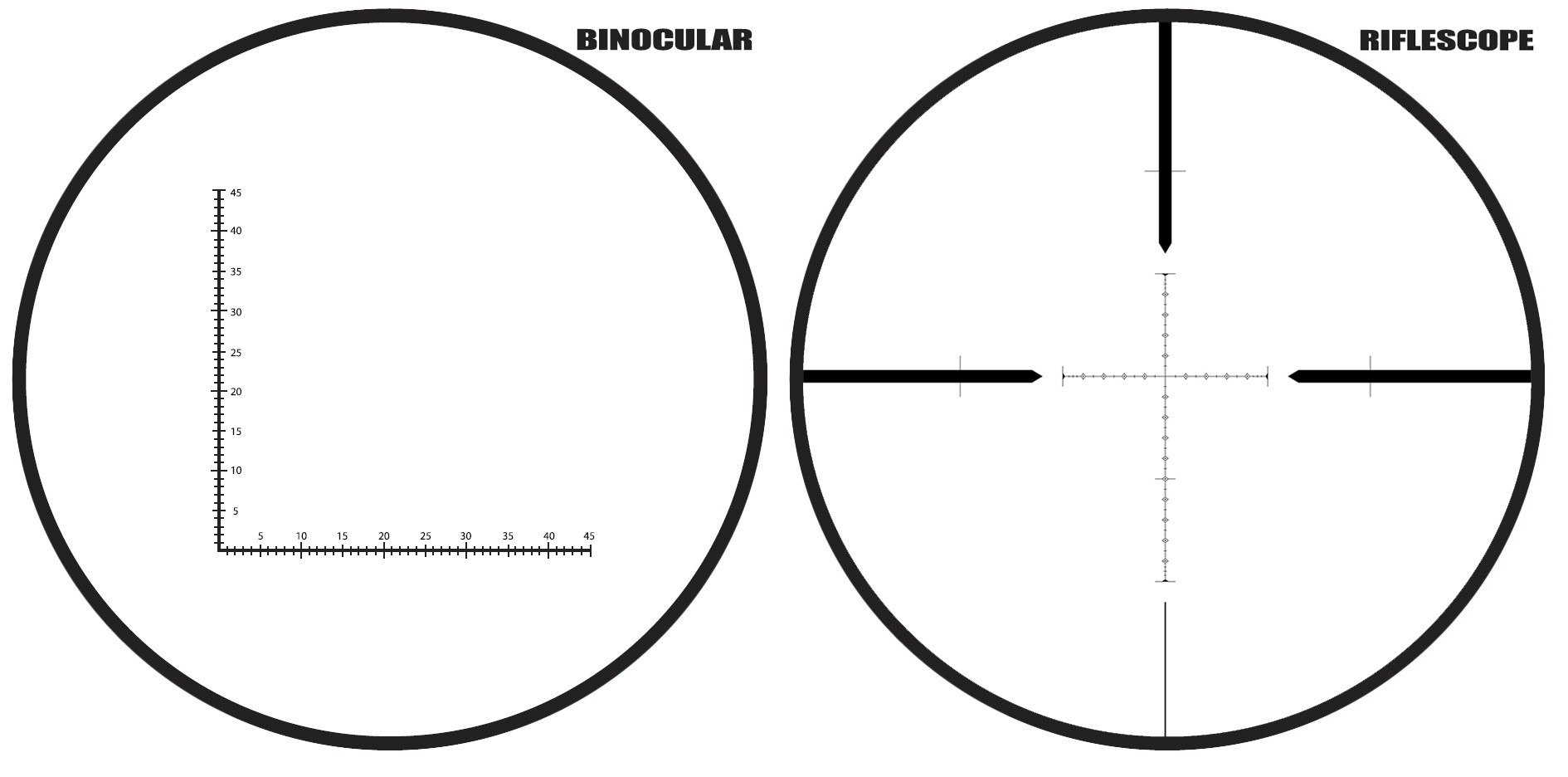

im guessing the reticle is 1mil hash marks? or is it .5mils hashes? hard to find a good close up of the reticle.

The one thing holding me back is the 1 mil spacing with marks every 5 mils.

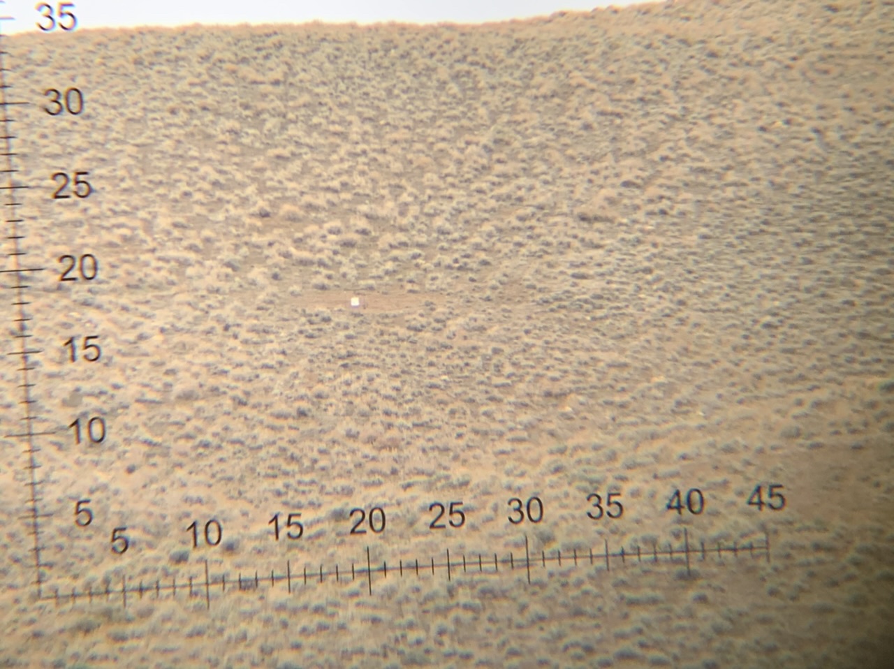

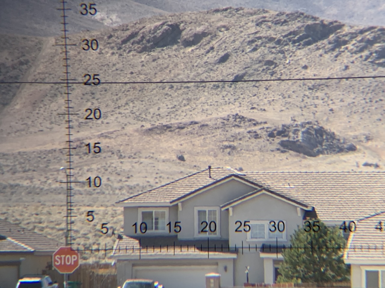

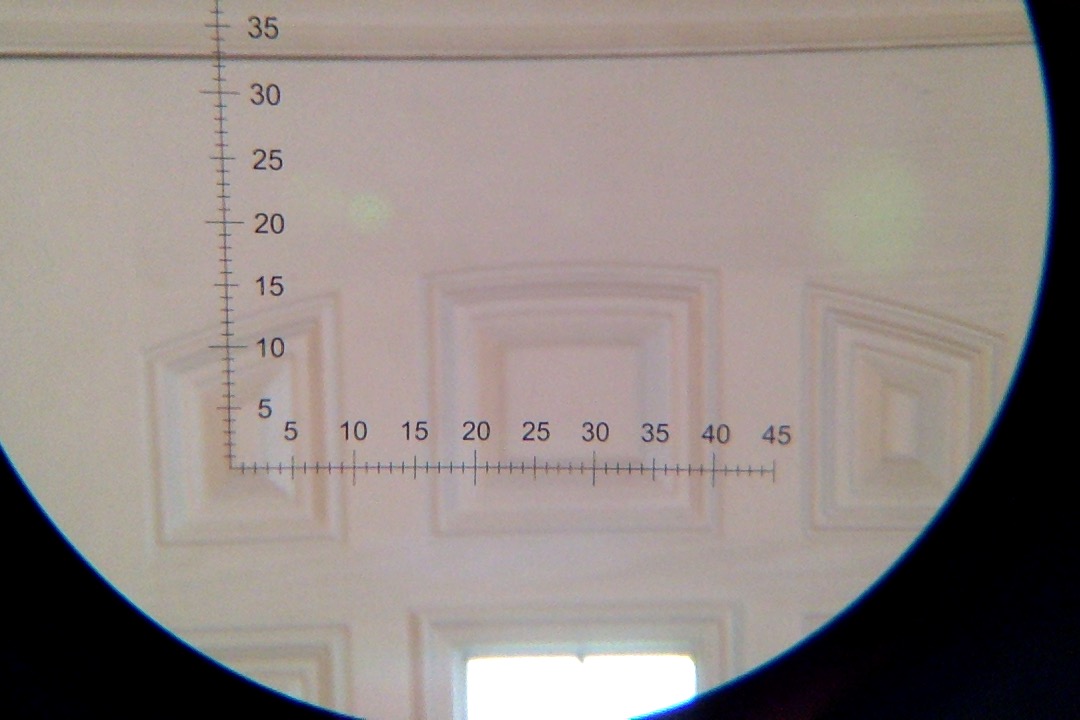

Here's a through-the-left-lens pic. Holy crap that's tough to get.
The hashes are 1mil. When spotting on targets, it gives much better feedback than using no reticle. I normally shoot with guys who use a MOA reticle in a Razor spotter on 40x. With that, we can call to the 1/2MOA. These binos aren't designed to have that sort of utility.
That said, it makes quick corrections MUCH more accurate and easier than using no reticle. And for a general idea of target size, it's also great. Much better than just looking at a 12x magnified image and guesstimating what it'll look like through a scope. Works for FOV, too, if you know what your scope FOV will be.
Reactions: PBWalsh and 47guy

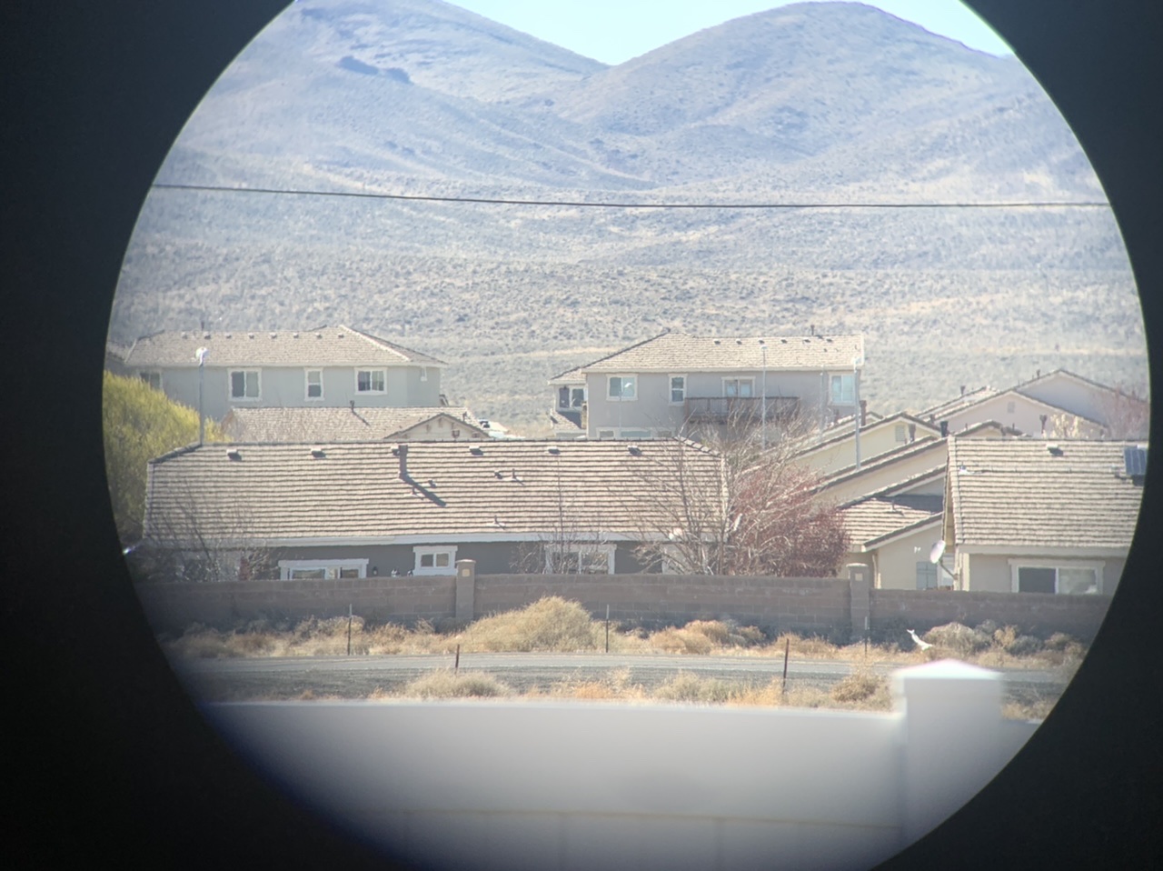

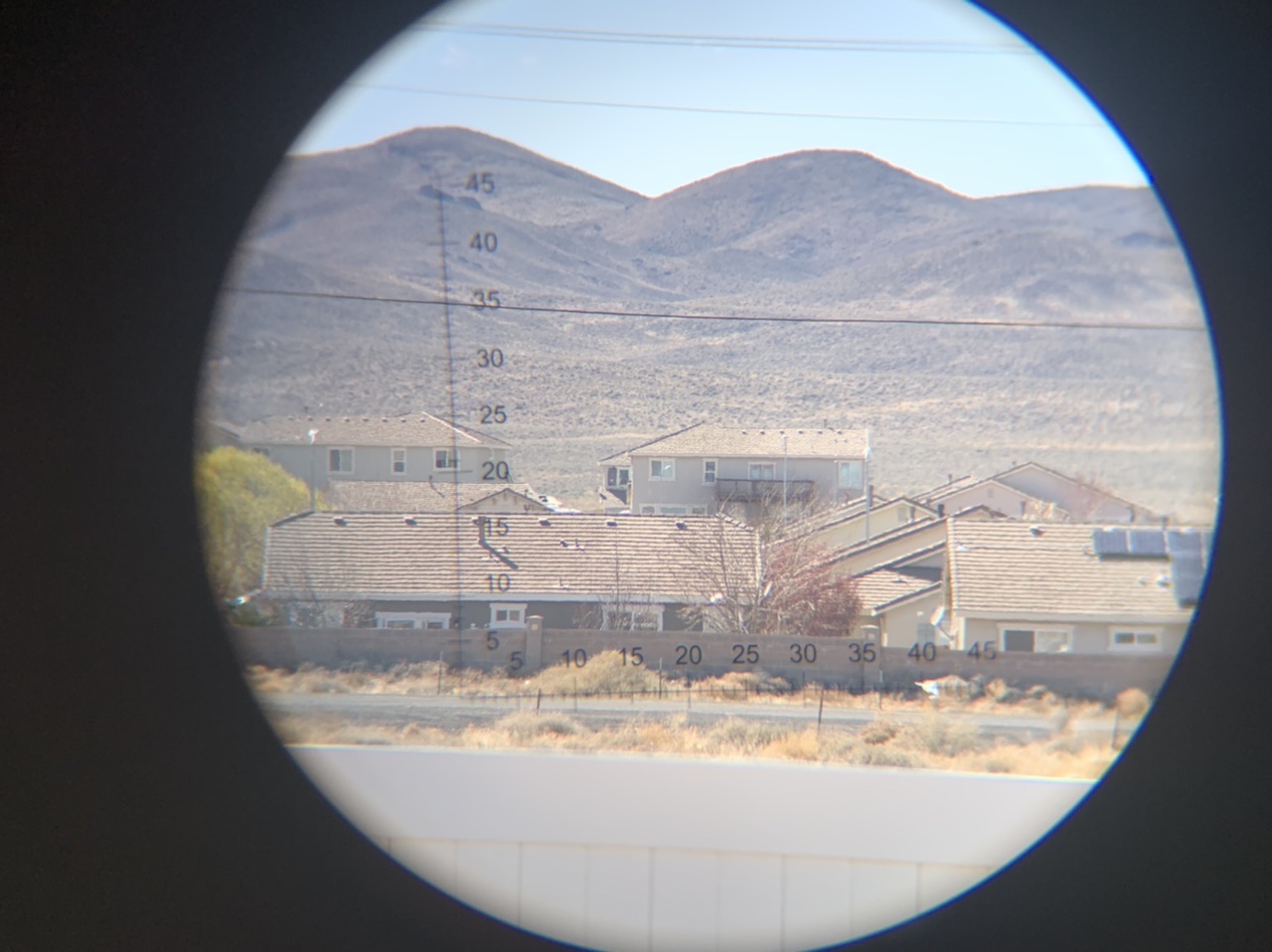

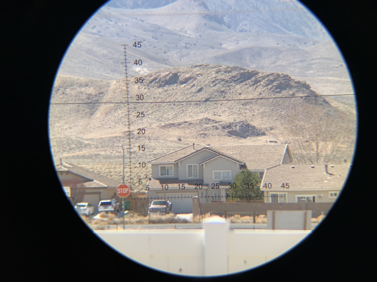

thats a great picture and the reticle definitely looks usable...mine are out for delevery today so if they get here before dark ill see if i can get a couple pics..thanks.
The house is 445yds.
The mountain a couple of miles...second house pic and mountain are 2x on my phone.

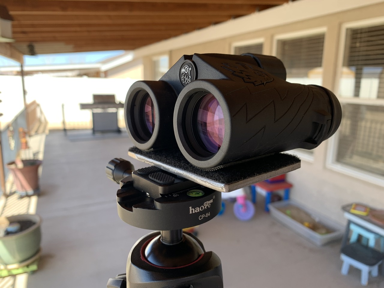

so the SWFA SS 12x32 are pretty impressive but then SWFA has always had pretty nice glass.
2 things I don’t like...the eye cups suck but are useable...twist out cups would of been nice and they are not threaded for a mount but I’ll order a RRS clinch mount tomorrow after I talk to the guys at mile high.
I’ll try to get out Saturday and play with them more but just the little I’ve played with them they are worth every penny of $399 IMO.

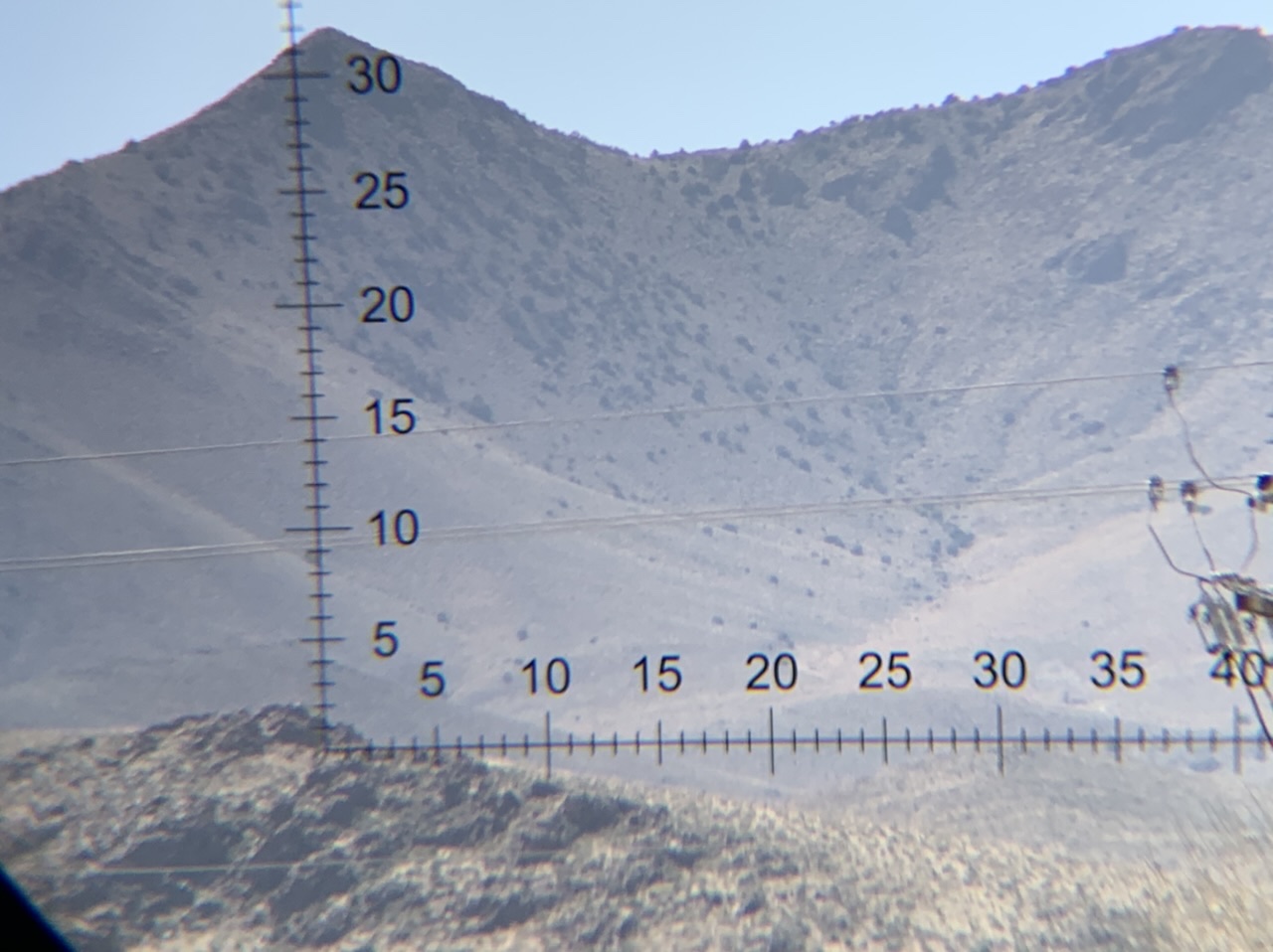

here’s a 17” square at 1082yds through the SWFAs...the image is a lot better than the crappy cell pic...BUT....this is where you really start to see the difference in glass compared to higher end stuff...the SWFAs are still pretty nice and usable...im blind in one eye and cant see out of the other but for me the focus is a little finicky ...it was chilly this morning so im not sure how they will do when its hot/mirage but at this point i still think they are good for what they cost.
