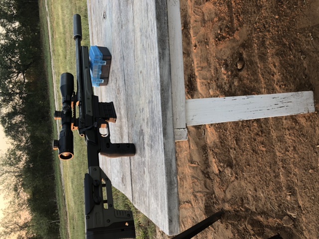

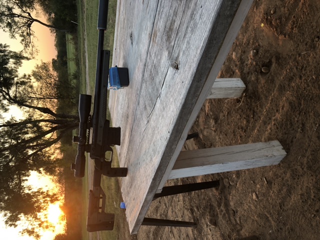

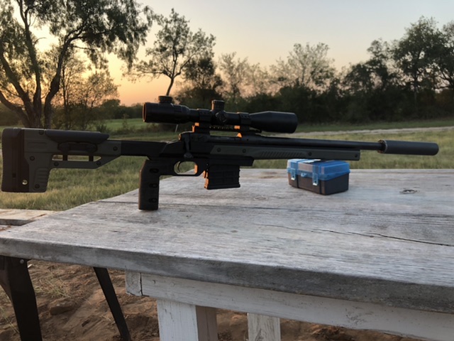

Here she is boys: Code name LITLLE BRITCHES.
love the feel of the gun.
what really sucks is my pet load no longer shoots worth a crap through it and I’ve got several hundred loaded already.
