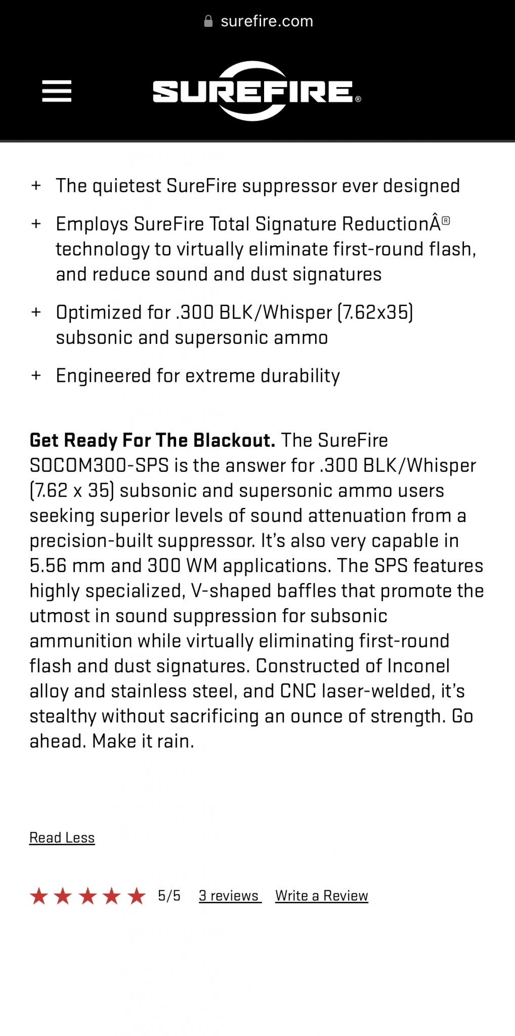

A quick glance at the surefire website says that the 300 sps is made for the .300 blackout.
If that's the case, you are fucking that can up, it is designed for a small volume case shooting pistol powders, 20-24 grains of powder, not a rifle cartridge with a slower burning 40+ grains of powder.
Gas volume far exceeds what the can was designed for.
It’s rated for up to 300wm.
