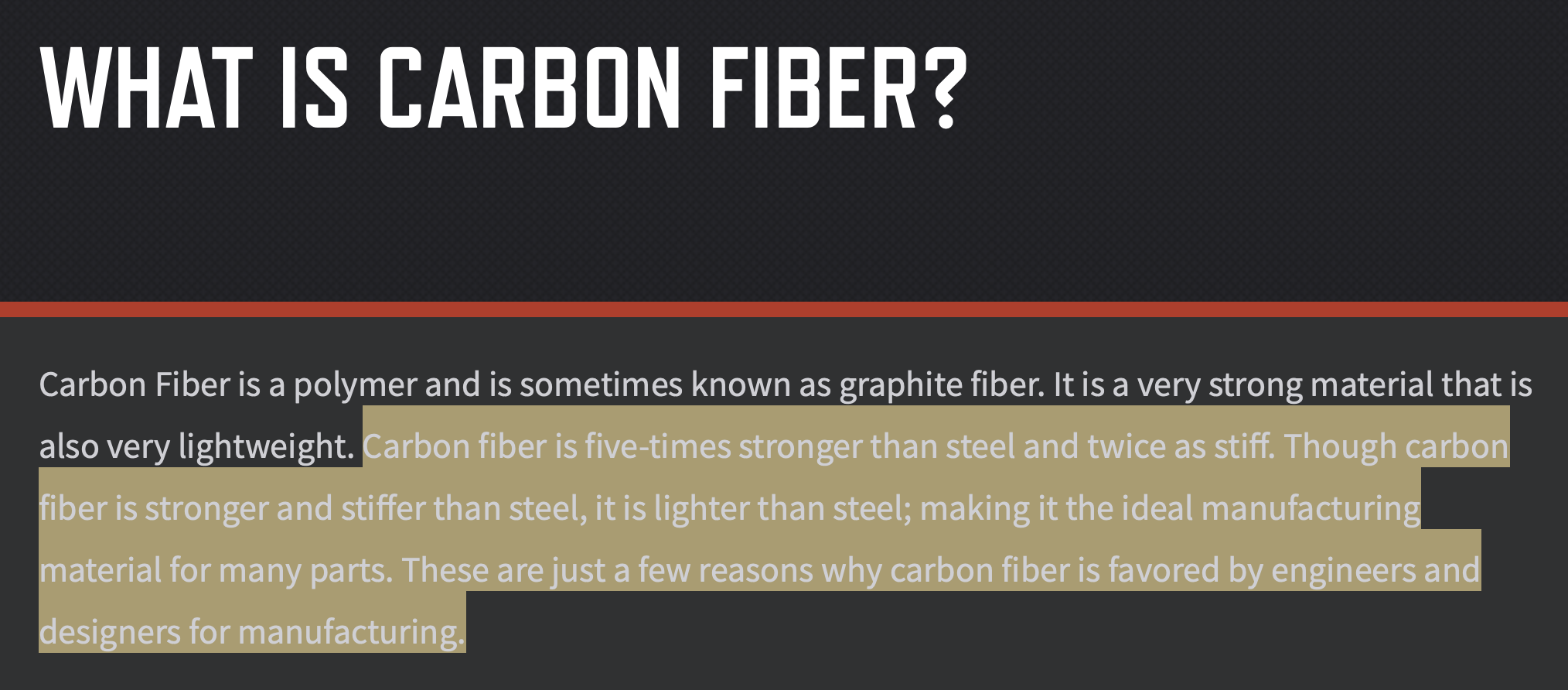

Well, scientifically, carbon is stiffer than steel, that's a well-known fact. That's a fairly anecdotal and remedial test...Of course deflection could be very similar...Small hole & light bullet, big amount of material around both of them... What do you expect to happen? The obvious. Of course they'll be similar. But go hang about 1.5-2 lbs. off the end of it and shoot 10-20 shots and watch the steel barrel's POI shift more due to the greater flexibility of the steel with heat. Kind of like a sporter barrel hunting rifle vs. bull barrel target rifle.
Found this video interesting... Some of you might, as well... 1,000 rounds rapid fire through a carbon fiber barreled bolt-action, and then cut it open at the end to inspect it.

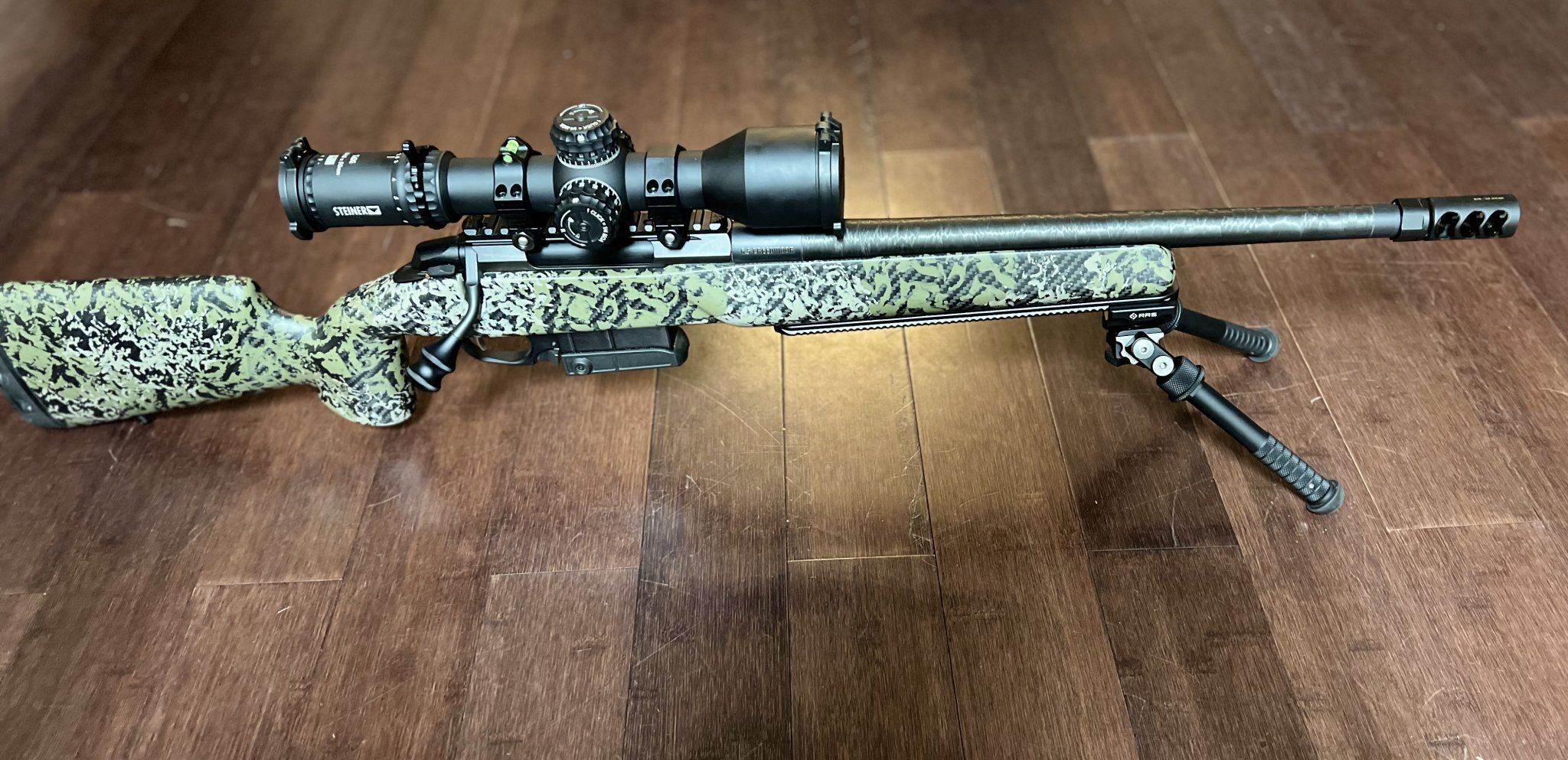

Just picked up this 6.5cm Tikka with a Bartlein #4 contour CF barrel. I rarely shoot more than 5-10 rounds at a time and just wanted something lightweight to take hunting. But I couldn’t be happier with it.

Just got it together this weekend, but I’ll check when I get home.
Could have shaved off a couple pounds by not using such a heavy scope, but it’s light compared to my Tikka CTR in a Bravo.
Tough to find a full-featured, and robust, lightweight scope, so I look at it differently now. Shave weight elsewhere so you don't have to skimp on the optics or give up the features you want.
What stock and ARCA rail is that?
Really looked into the Razor LHT, but read a thread about them losing zero when dropped. Don’t need anything like that with a hunting rifle so went with the t6xi and I’m happy.
It’s an Iota Eko carbon wrapped and an 8” Area 419 rail. Ordered the Iota for 50% off on Midway and the rear pillar was about a tenth of an inch off from where it should have been. Iota agreed to let me change the color and inlet of the stock free of charge and took about 7 weeks to get the replacement stock. So far I really like the stock and have less than $400 in it.
Bought the action here and waited until I found decent deals to buy anything else needed. Got the t6xi for $1200 and Hawkins lightweight for $130. Have under $4k in it, including scope and suppressor that’s not approved yet.
Proud to have a “custom” rifle that didn’t cost double that without skipping on any features. Well asides from the stock, but originally planned to buy a manners if I didn’t like the Iota, but it fits me perfectly, has pillars and a thumb rest, so I doubt I’d get rid of it.
