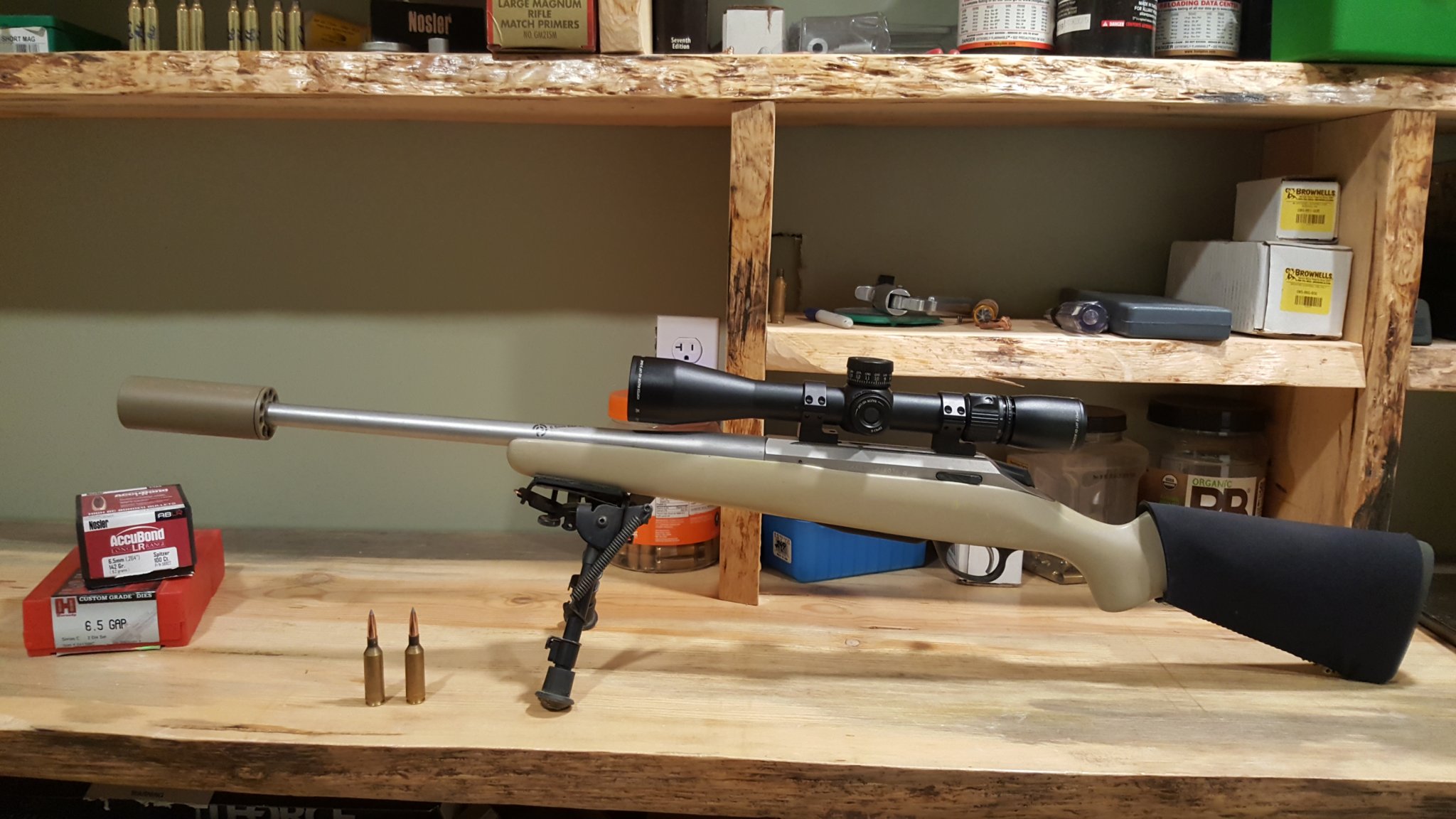

I just received an email that my Barreled 16" PRC is on the way back to me. The reason I chose 16" is because I have an 8" suppressor (Hybrid) which puts it at 24" and about 3.25 lbs (barrel and suppressor).
SilencerCo stated that the Hybrid was safe on the 6.5 PRC down to 16".
I will post back once I get some range time.
