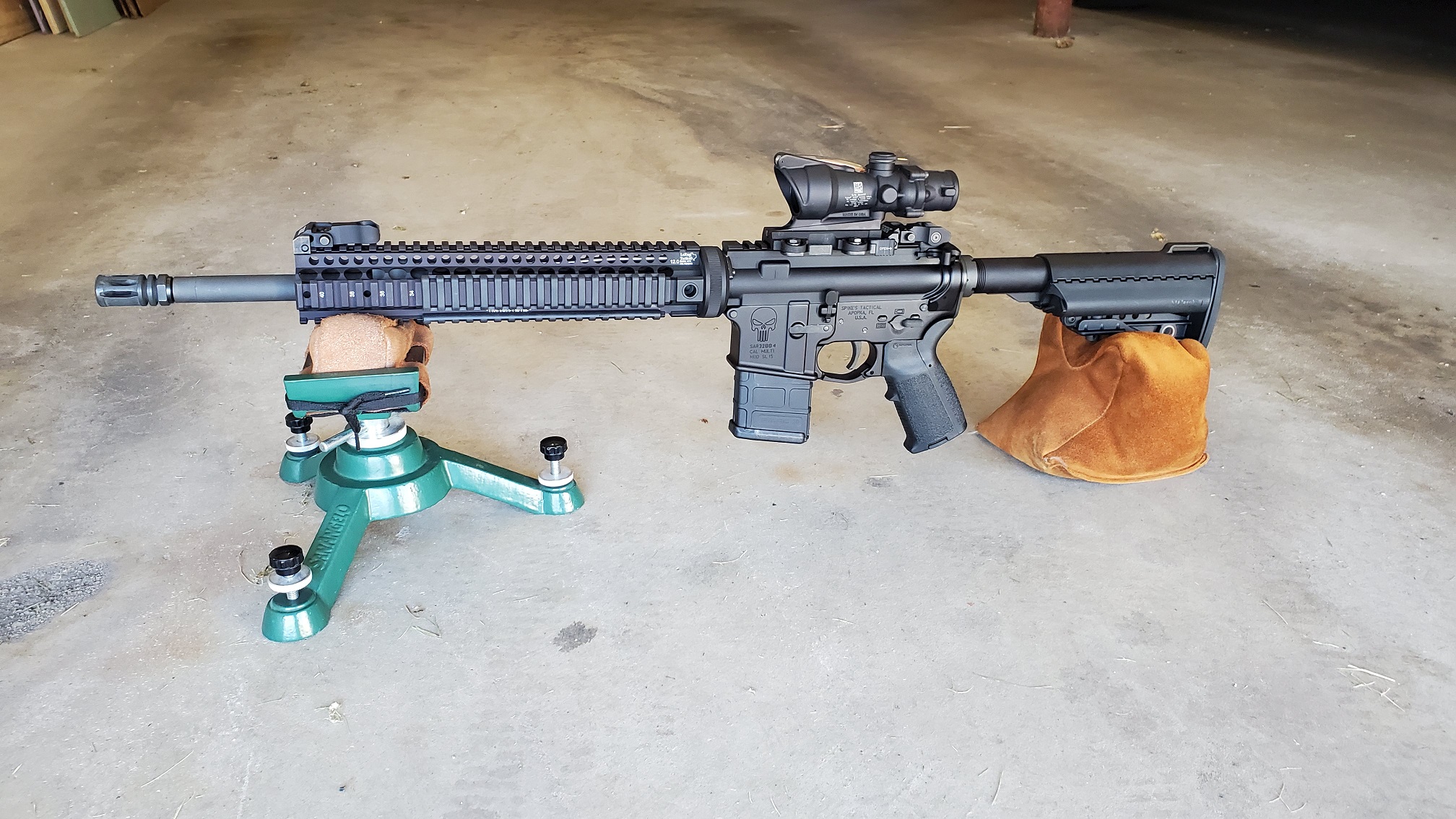

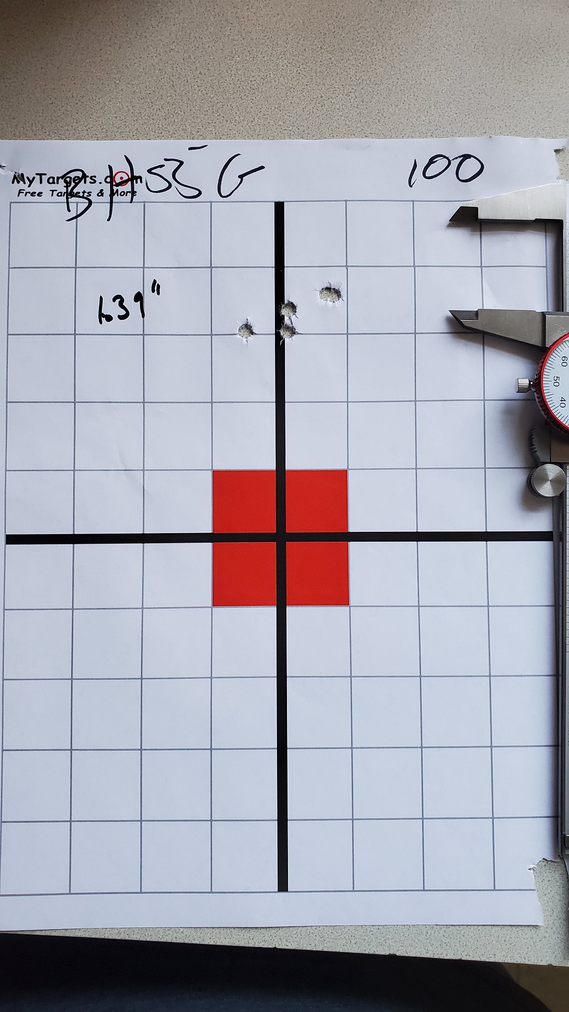

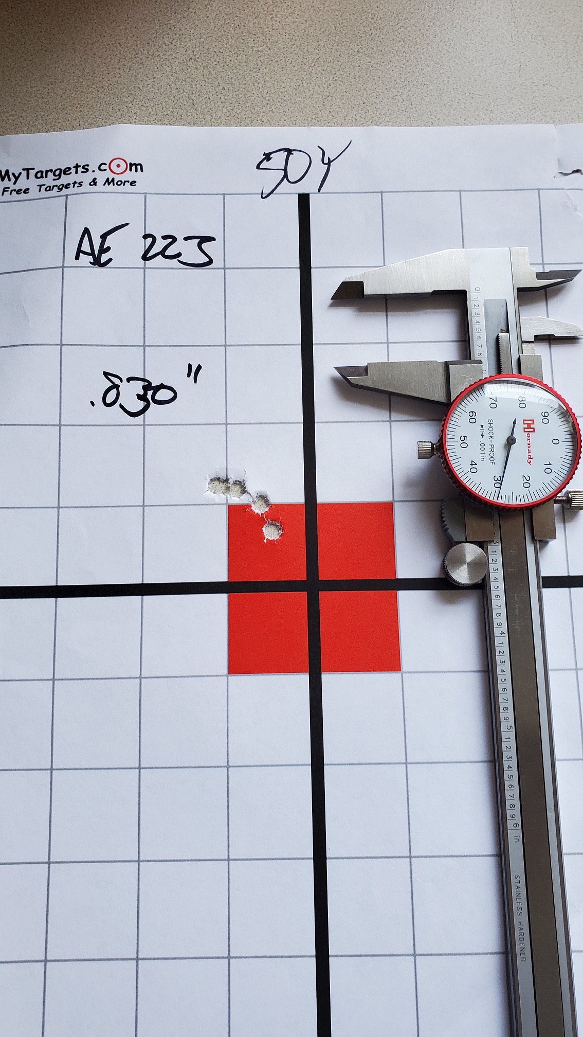

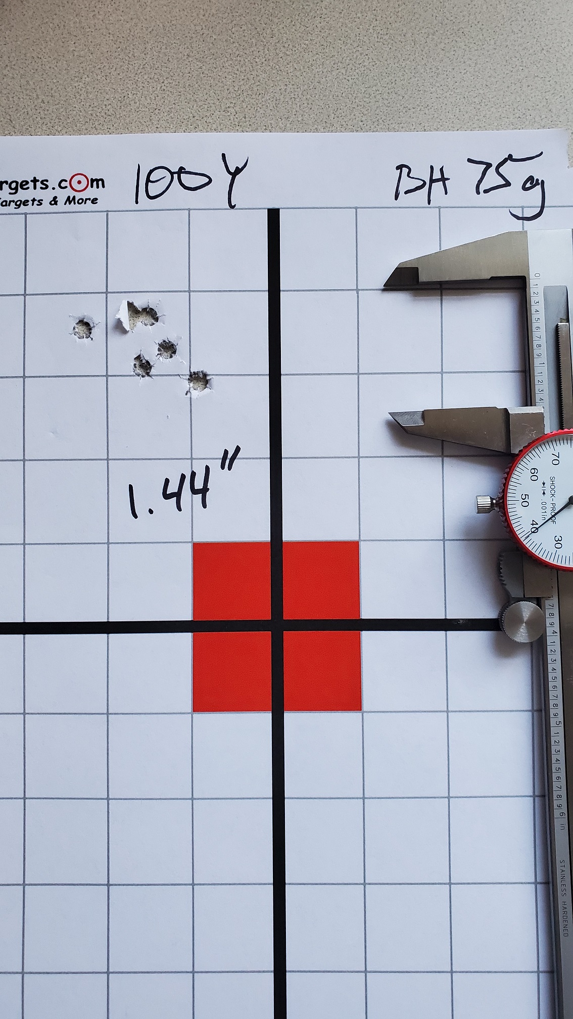

Here are some pics of the gun and targets at 50 and 100.
It is a 16" BCM BFH (CHF) barrel with a TA31H ACOG. These were the best targets at 100. There were others with non-match ammo that were well over 2-3" at 100.
Looks like my average with BHBB 55 and 75 is right around 1.4" with an ACOG. Not bad considering fixed 4x magnification and no crosshairs. Also how you see the rifle setup is how I shot if from a bench. No additional bags.

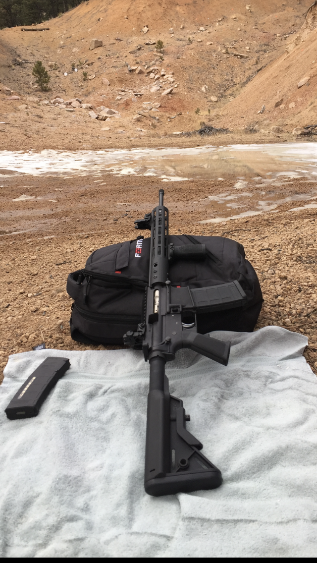

For real survival/shtf my pick would be a Faxon pencil because it’s crazy light, and weight will be much more important than sustained fire accuracy in a real survival situation IMO. This guy weighs nothing for example (16 faxon pencil) and the first round that’s gonna matter the most is substantially better than minute of meat or minute of man:
A 5.5lb build is a lot easier to pull off when your barrel weighs 19oz.
