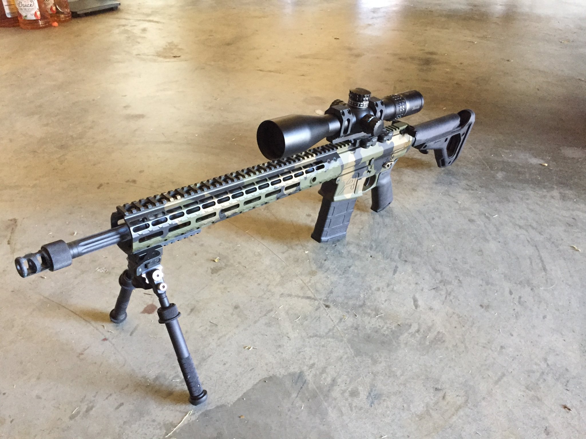

I built an 18" with the faxon match .750 barrel. I run it primarily suppressed. I had issues with blowing primers until I installed a JP bolt and that's paired with an SLR adjustable gas block. I see 2540 FPS with the 140s and 2730 with the 120 class. I haven't tried the 130 yet. That's an old pic it has a 5-25 eotech vudu on it now.

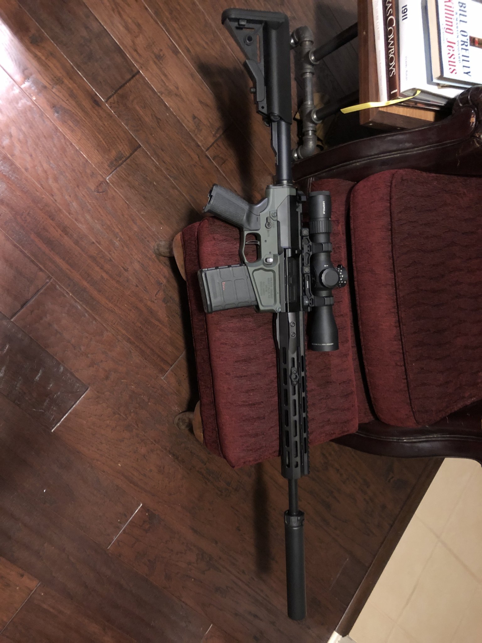

I forgot I even made this post. So as it turns out I did go the 16inch route. I bought a factory upper from Wilson Combat and paired it with their lower that I built out myself, how I wanted it. Essentially got the almost $4k plus Wilson combat gun for half that. The upper was on sale when I picked it up after Christmas.
It shoots lights out for what it is, .6-.75 with Prime 130s. Muzzle Velocity with the Prime was 2530 fps. It is light and handy and easily makes it to 1k. Because of this I want to put my 6.5 creedmoor bolt gun up on the exchange. I don't really see the need for it now that I have this gun. Plus, like most of us I assume, I have more fun coming up with what I want to have built next.
Happy to answer any questions on specs if anyone cares to ask.
