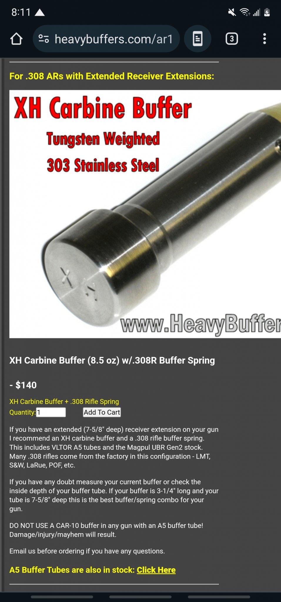

I have the 8.5 (heavybuffers.com) in mine, and you can mix/match the 3 tungsten weights inside with steel ones to get at least 3 other weight combinations if the full 8.5 is too much. It would have been much easier on my wallet and less headache if I'd went that route from the get-go.

I put the wrong link in the first post for the XH buffer. It's fixed now. scroll down on the heavybuffer page to the XH buffer with armalite rifle spring.
