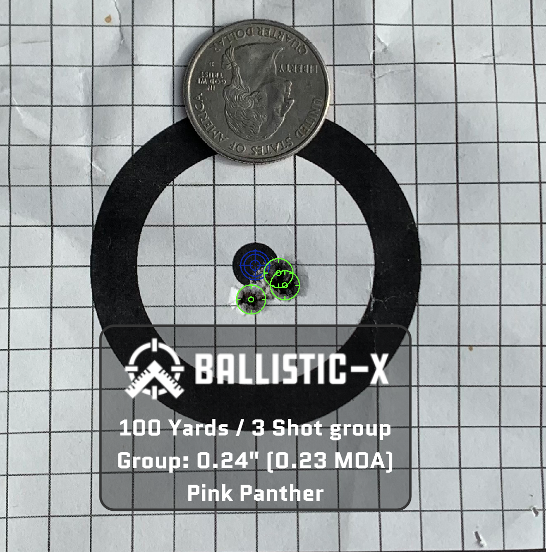

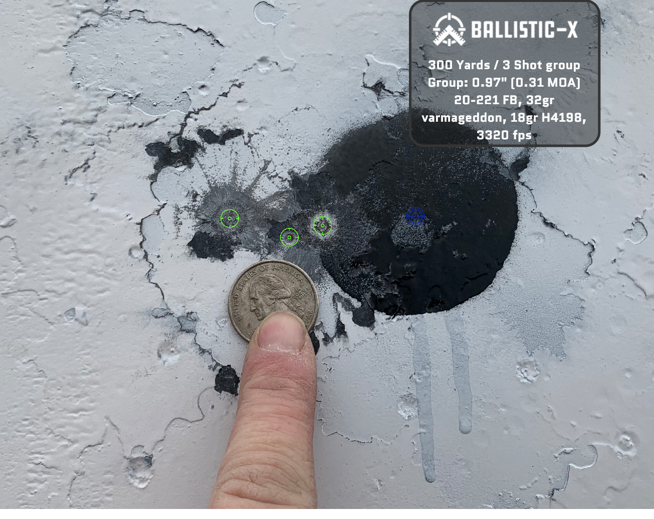

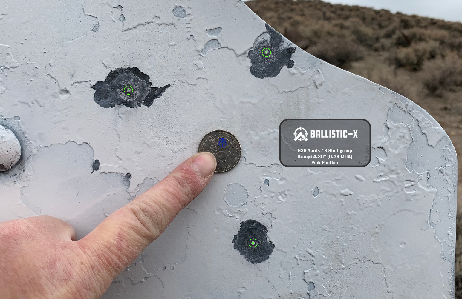

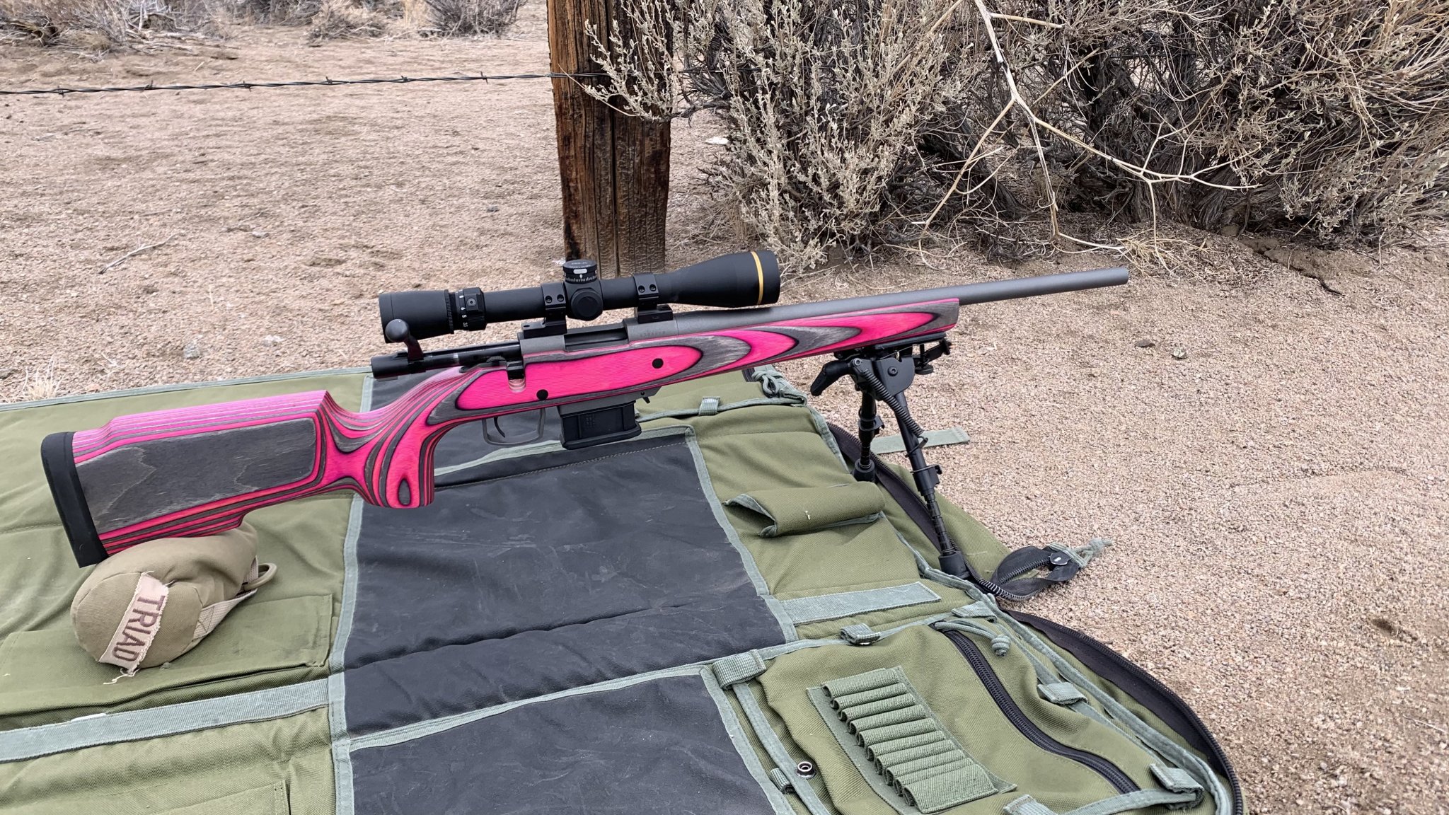

And that brings us to the 20 calibers. All the coolness of a sub caliber with none of the finicky nature of the 17. I shoot a standard 221 necked to 20 caliber, but the vartarg is great too(same cartridge with 30 deg shoulder). Best part, LAPUA brass! Just finished a 20-221 on a Howa Mini with a 19” #2 Krieger for my girl. I load cheap 32 gr varmageddon bullets at 3350. Gun weighs 8 lbs. if you don’t want to duck around with the neck down, shoot a standard 221. Remington made the 700 in 221 (and 17 fireball, same case) up into the 2000’s.

My whole adult life I played with all kinds of varmint cartridges, including three 17R's, but this 20-221AI offers the most for the least.
