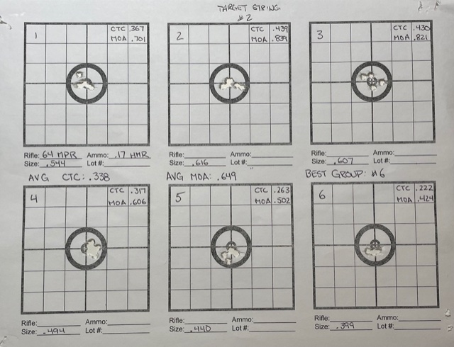

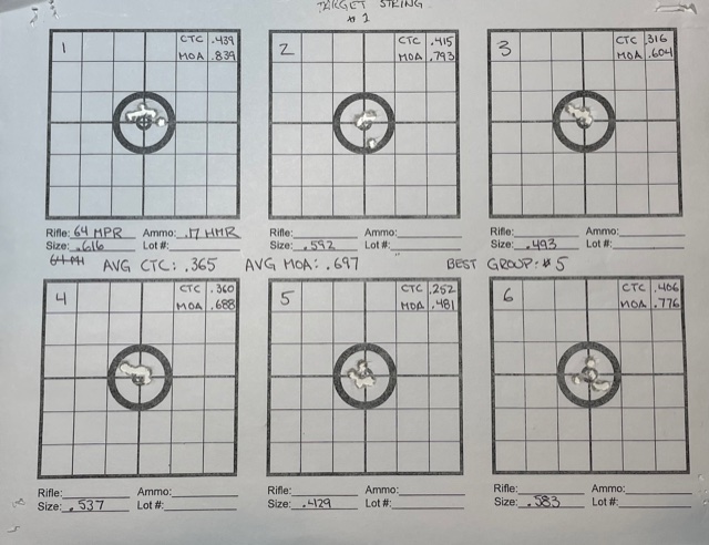

My new to me latest .17HMR acquisition is proving to be more accurate than my .22 Magnum so far... at least at 50 yds. I need to get back out and stretch it out to 100 & 200 next range session. The groups below were shot consecutively in one sessions
